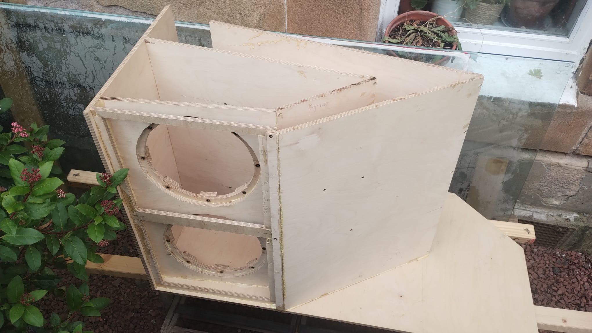

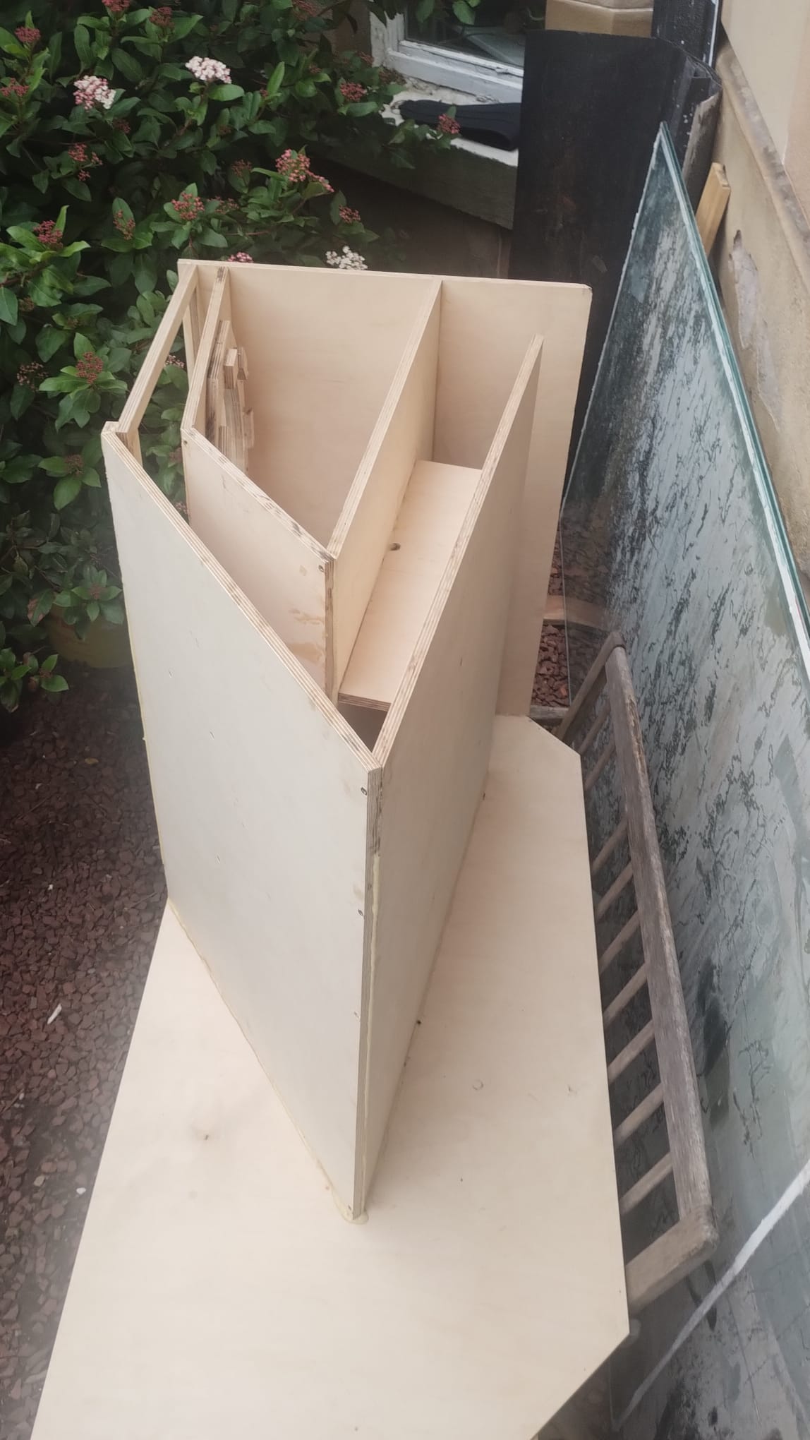

Hi all.
Ive been on an unintended break from working on this project. A long postal saga- resulting in delays getting the drivers, as well as being away from home for work.
I'm now finally home, Have the pair of Fountek 12s that Seth found, a 12v dsp and hoping to get this going.
i dont have access to a workshop anymore but have borrowed some tools and clamps and doing the best i can with building in a my little flat garden :)
Questions at this stage ;
These 2 12s are heavy ! 15kg together ( 32Ibs ). I went for anchors with retention blocks and lined up insert nuts to carry that weight with allen key bolts rather than screws . As you can see im about to do the braces around the baffle, the small flange to baffle braces and the anchor to panel 3 brace. Theres not that much wood left in that 29" wide baffle after cutting out for the drivers, with this much weight on there do people think i should add some more braces, or will those mentioned in the plan be enough?
Another thought, for the internal cabling of your subs do people tend to use tour grade van damme type cable (like you would use for the speakon leads, with a extra flexible circular sheathing) or just normal old fashion 2.5mm multi strand speaker cable? I was about to use some normal old 2.5mm, then suddenly had the horrible thought of sealing it in there and hating myself for it when it somehow fails in a couple of years. what do you guys use?
All the best ,
and i'm happy to be back here thinking about all this again,
