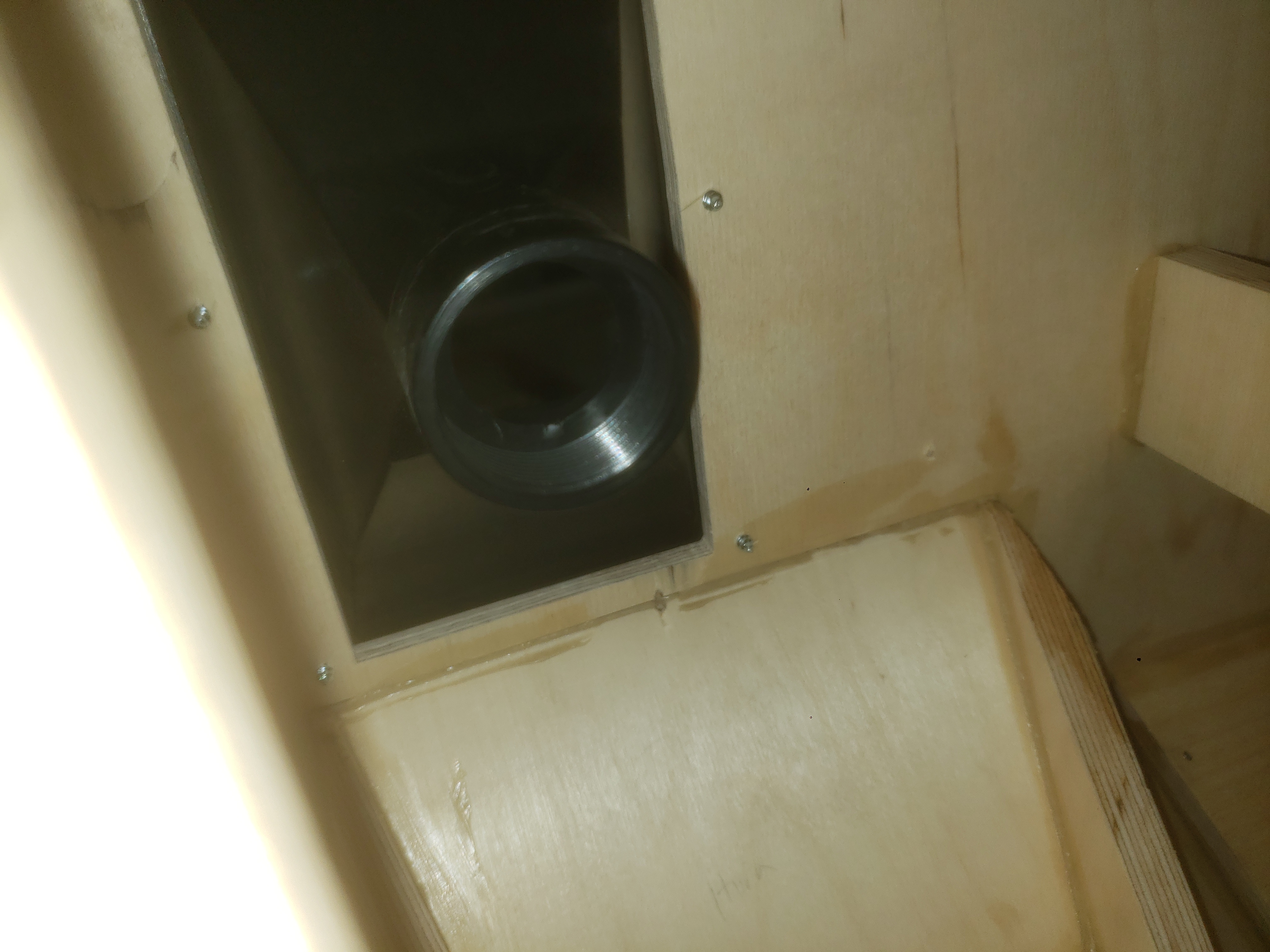

The 150 horn I bought has female threads. The current APT-50 driver has male threads...
The APT-50 I have has female threads and this horn on ebay has what appear to be male threads... I have contacted the seller to see if they can confirm the thread gender.

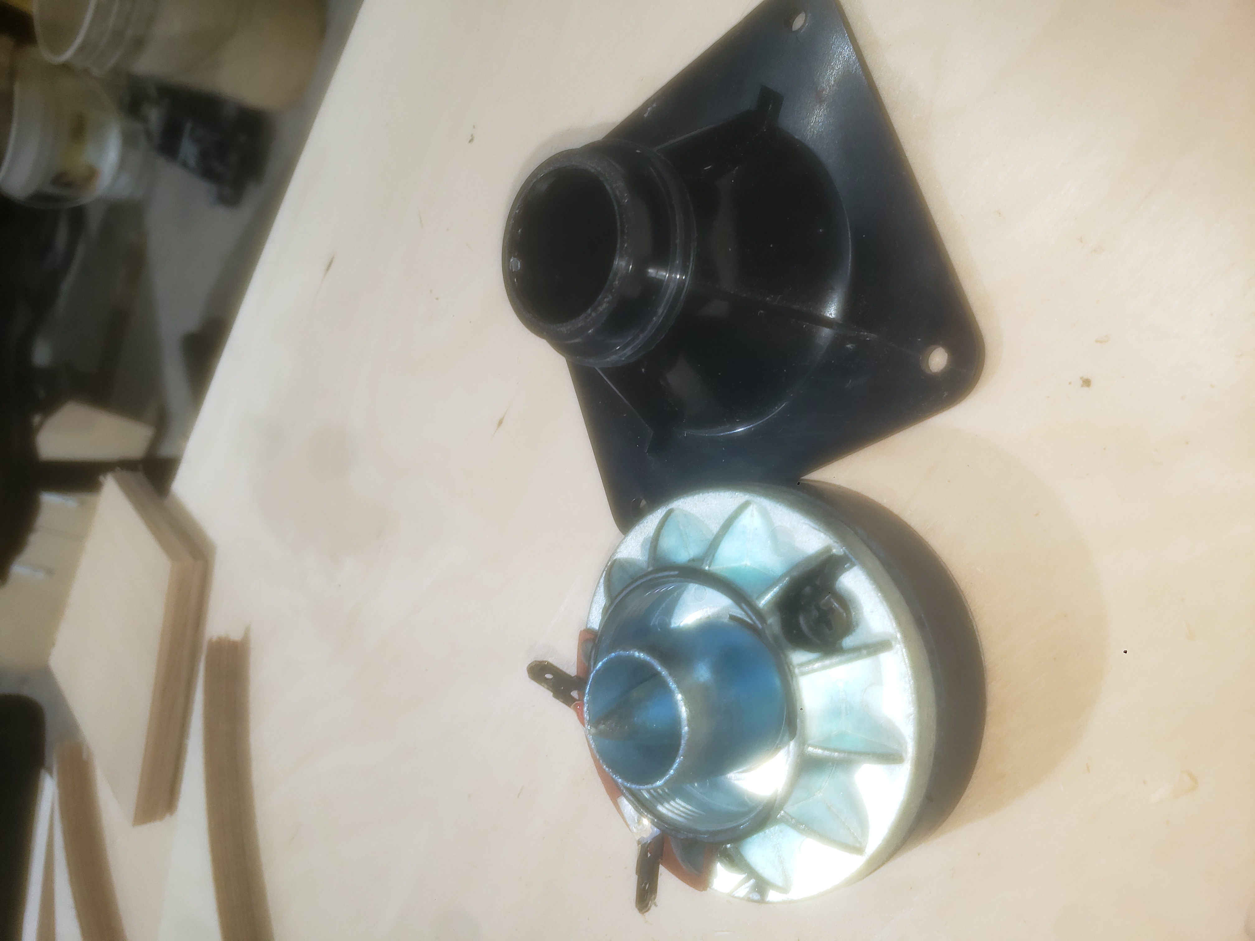

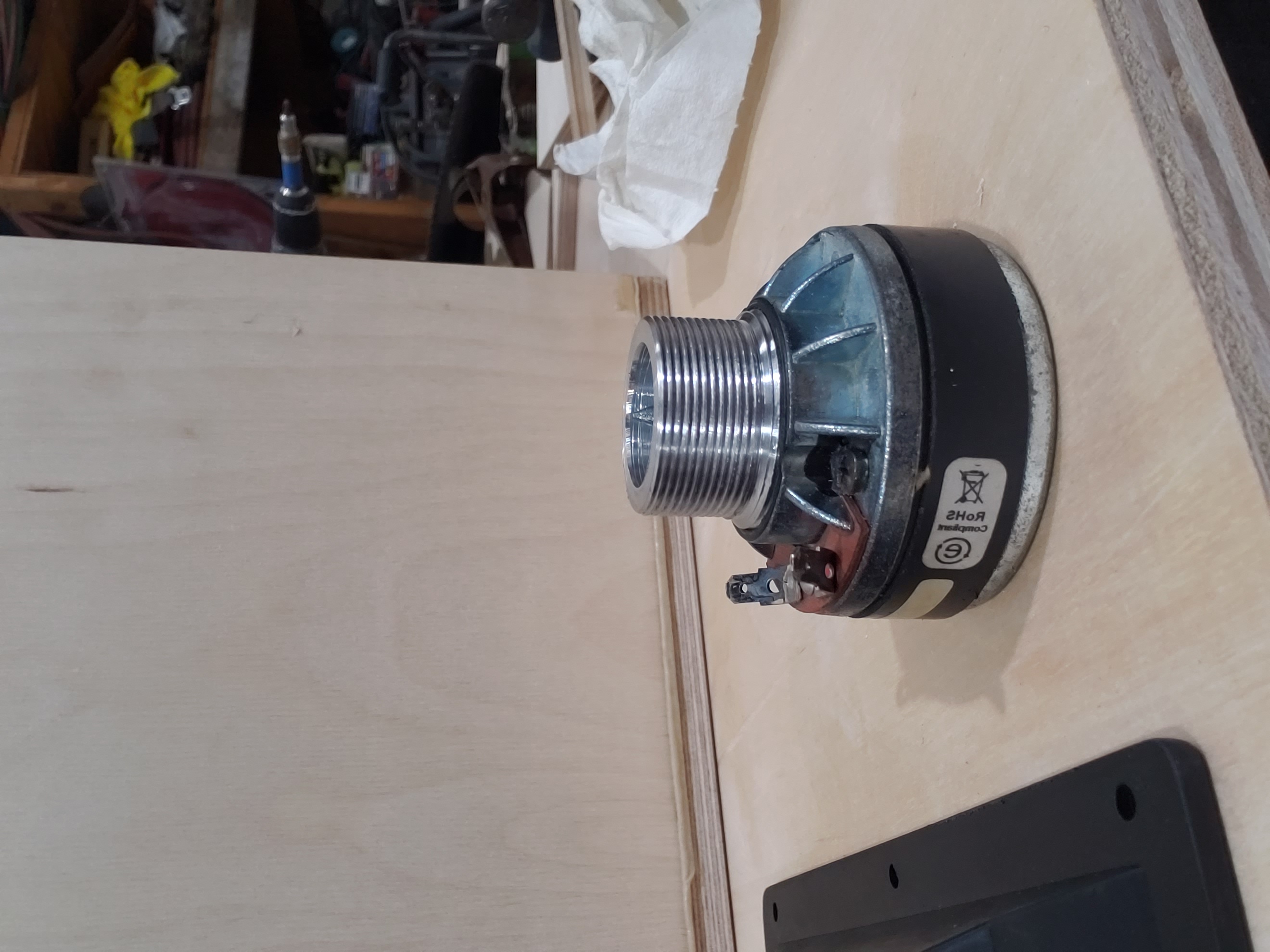

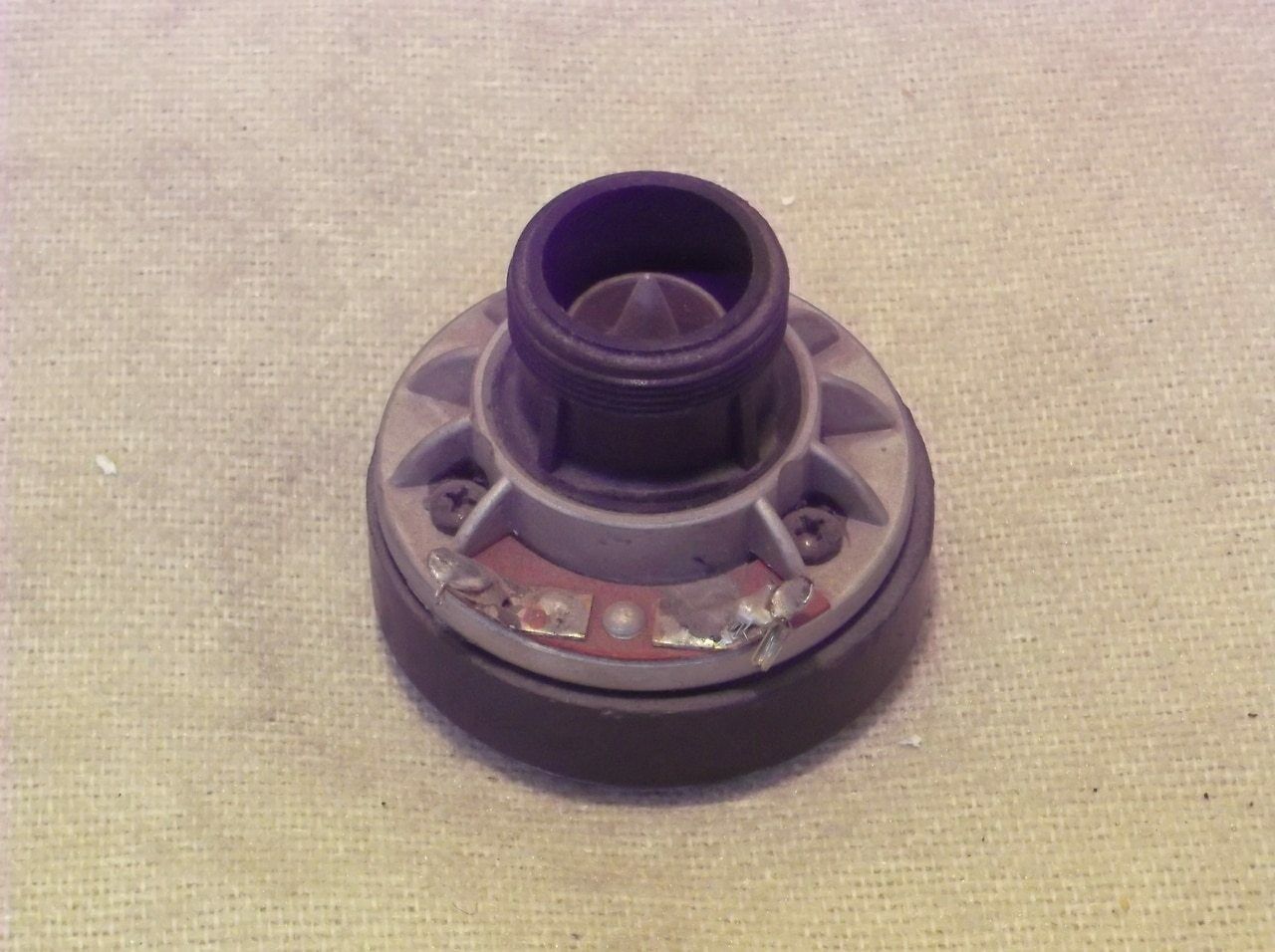

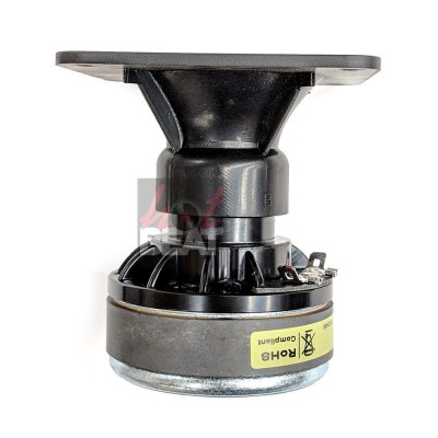

Absolutely, due to my messed up camera on my phone I have gotten bad about not taking pictures...
When I get home tonight I can get some pictures to illustrate the conundrum but in the interim these pictures of some drivers on ebay might tell the tale.
This is the driver I have, it came with a 80x80mm horn = APT80.
You can see the APT3 adapter is still attached to it after someone removed the horn.
The horn I have has female threads to allow the male threads of the adapter or equivalent 1 3/8"-18 driver to screw into it.
Weldon Carter

Here is a current production APT80 with male threaded driver and female threaded horn.
In short I need a old stock 150 horn or adapter or new APT50.

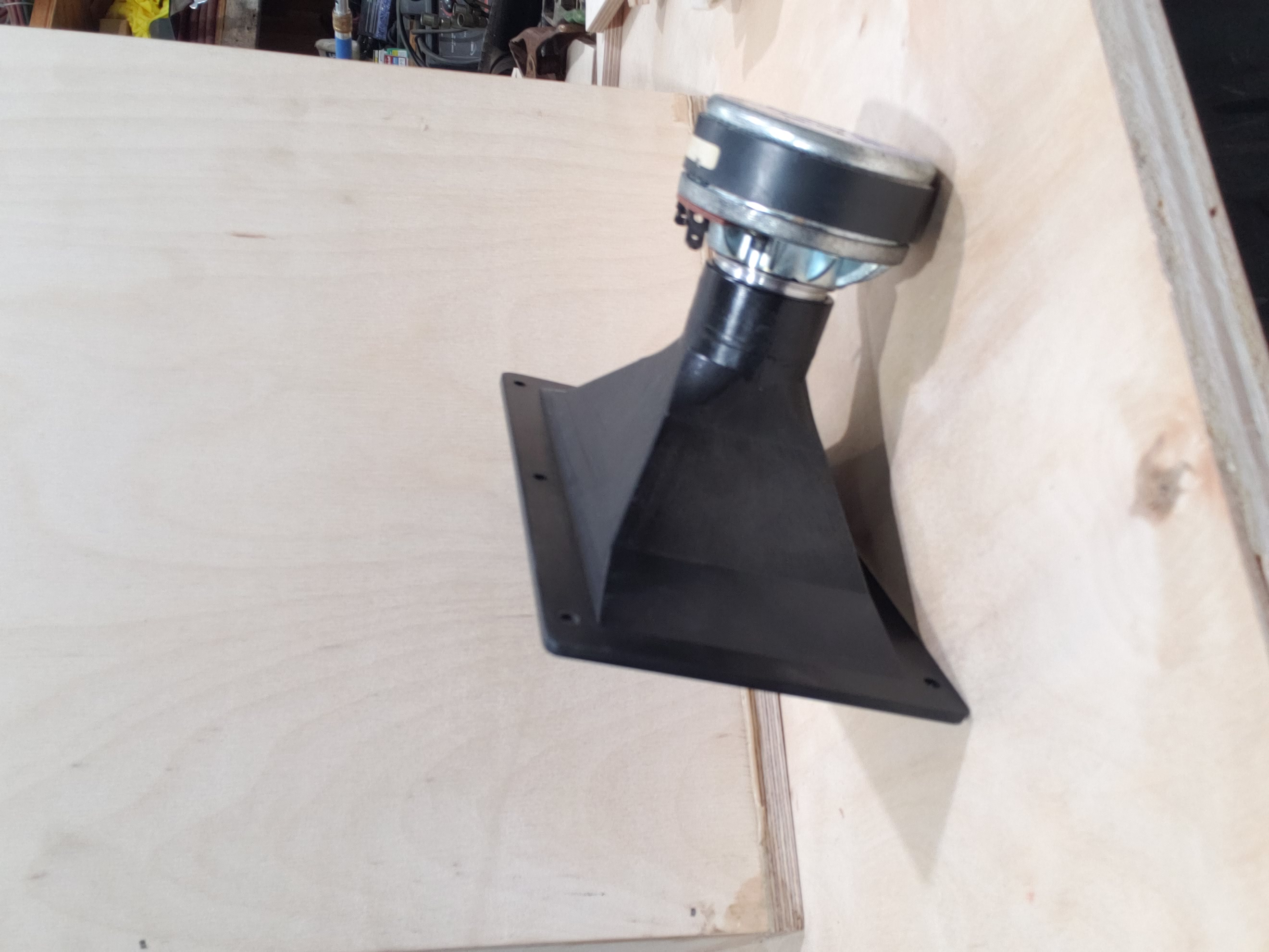

- Posts: 8677
Looks like the best bet is to take out that waveguide, fill the hole and cut the round hole for the APT80. Or, just put a different driver on the back of the that waveguide you have in there.

The driver swap is the most ideal solution, it just works.
I am a glutton for punishment so machining an adapter to allow the connection to the 150 horn it is
Since the other cabinet calls for dual ASD's I will have no use for this driver if I don't use it.

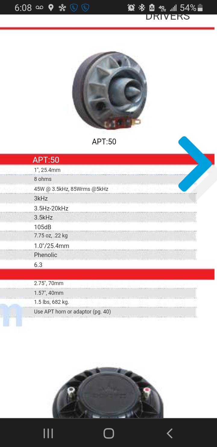

2008ish is when the tweeter had the 1.5 female threads.
The 2010 catalog has the adapter in it but the apt50 has male threads.
I started on the adapter last night but had a thought that I should try the 80 first Incase the dispersion is actually too wide for my intended use (I don't think so) but it's easy enough to make a adapter plate for the cab to test.
From the 2008 catalog

If it were me (I don't have a lathe) I'd be really tempted to attempt cutting off the threaded portions of each part and gluing the stock threads to the new horn.

Really it's just me being cheap and trying to use driver I got.
I am going to try and not mess up any parts permanently so that I can UN-DO all this tinkering.
That was my first thought...
But since the old horns/adapters are not available doing so in the event of failure would result in ruining a APT80 and a 100x50 horn flare...
It is a possibility though still...

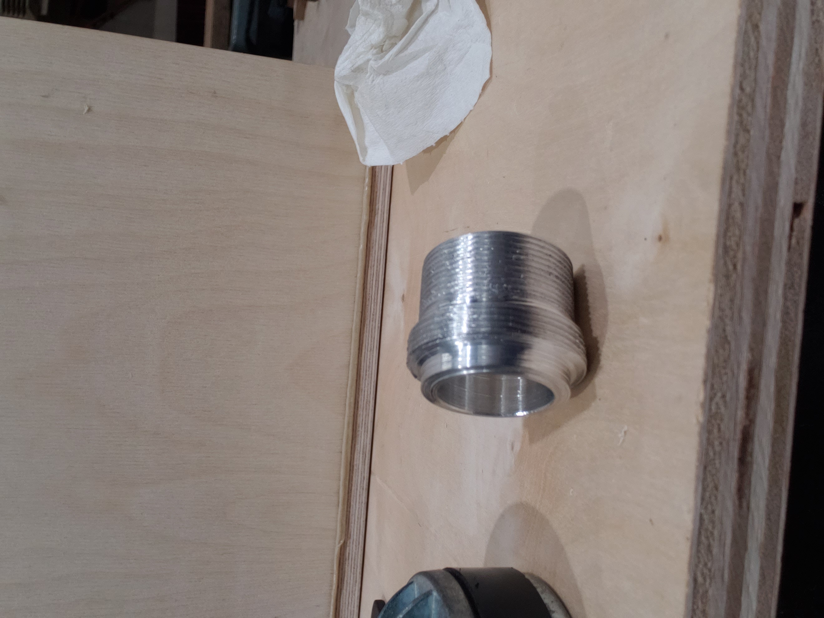

Pretty happy for my 1st and second thread I have ever cut.
Weldon Carter
Dude, that looks bitchen!
(California Speak, sorry)
