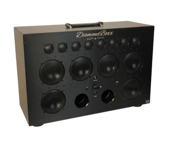

Hopefully compete with the direct radiating DiamondBoxx XL2 https://diamondboxx.com/collections/all ... oducts/xl2 Be "portable" I intend to integrate the wheels to the cabinet to make it easier to haul, handles etc.
