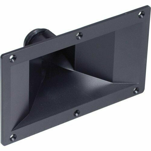

The 150 horn I bought has female threads. The current APT-50 driver has male threads...
The APT-50 I have has female threads and this horn on ebay has what appear to be male threads... I have contacted the seller to see if they can confirm the thread gender.

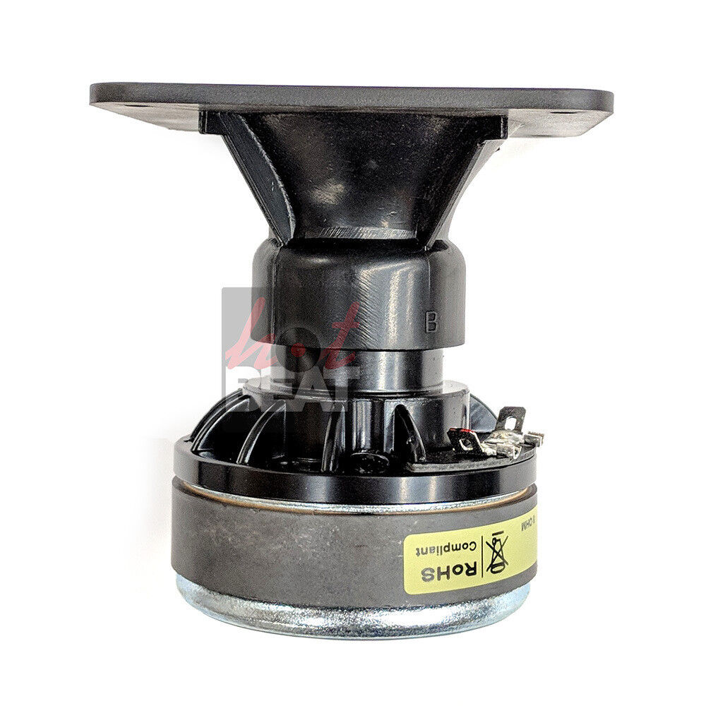

When I get home tonight I can get some pictures to illustrate the conundrum but in the interim these pictures of some drivers on ebay might tell the tale.
This is the driver I have, it came with a 80x80mm horn = APT80.
You can see the APT3 adapter is still attached to it after someone removed the horn.
The horn I have has female threads to allow the male threads of the adapter or equivalent 1 3/8"-18 driver to screw into it.

Here is a current production APT80 with male threaded driver and female threaded horn.
In short I need a old stock 150 horn or adapter or new APT50.
