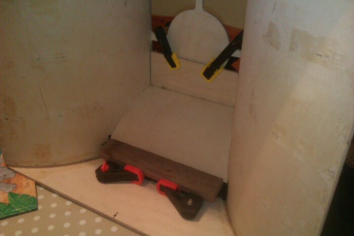

It's been very hard moving forward through these minor sheaths install phase, fiddly detail and numerous parts, but now there is progress to report.
Here's a picture of the top hat trial fitted, with a spacer the same shape as the top flange, for the screws to bite into. The upstand braces are not in the final position - this is dry run.

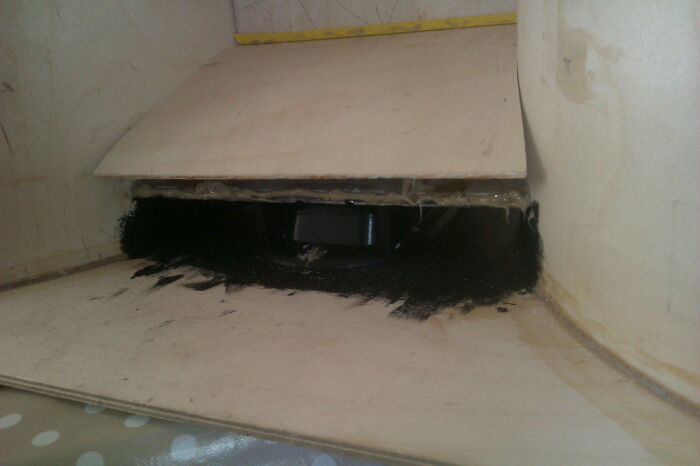

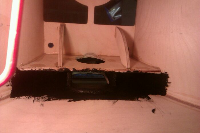

Rollered blackness, a combination of brush application and rollering with a custom roller I made.

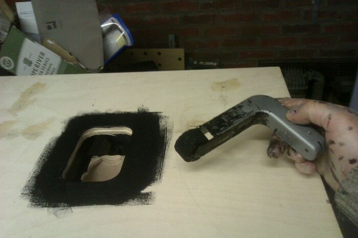

Here is the custom roller. 20mm wide standard (non textured) foam roller, cut down from a standard 4" roller element. Fitted into a plastic handle on something i was throwing away.

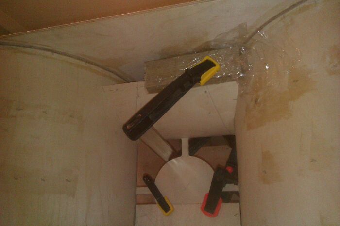

On the second one fitted via the use of staples, the staples punched through the 3mm ply at one side causing it to delaminate and not join properly, hence the clamp and batten to try and glue it back into place and line accordingly. I decided at this point that stapling these minor sheaths was a bit of a pigs ear job and not easy to do neatly.

Except that this one didn't work. The force conponent from the clamp is not onto the curved brace pieces. It's a stroke of luck if the clamps curve the wood and it curves in the profile shape of where It needs to be. May need a combo method or staples and clamps.
EDIT: On closer inspection, the sheath was too wide in the lower regions and being trapped between the side sheaths wouldnt fit down onto the profiles where it needed to be. Need to trim some width off.
