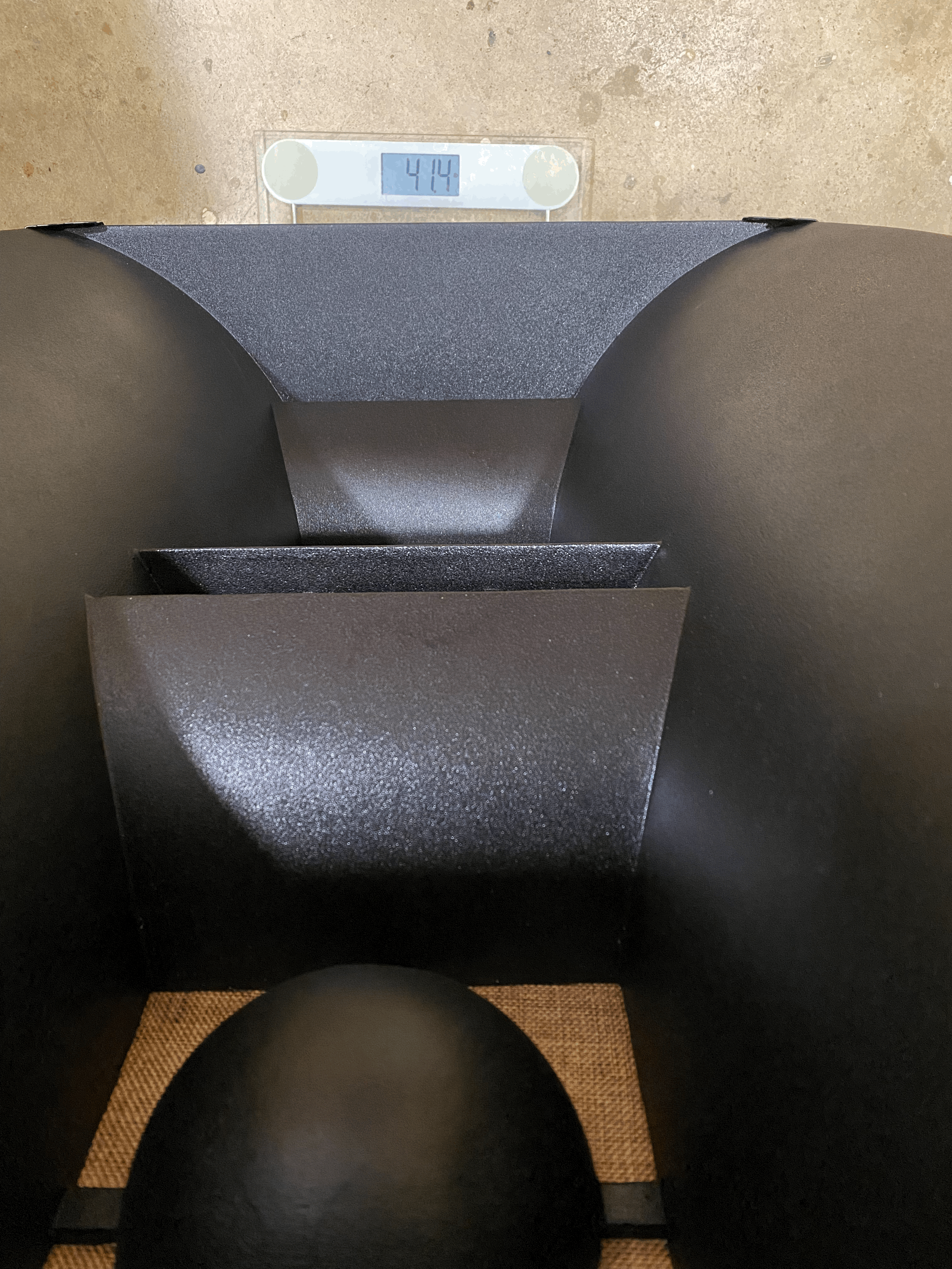

Ok, back to the thread. Sorry for the long delay in posts. Got real busy with holiday travel, family and work. Now that we're past all that back to the fun hobbies.

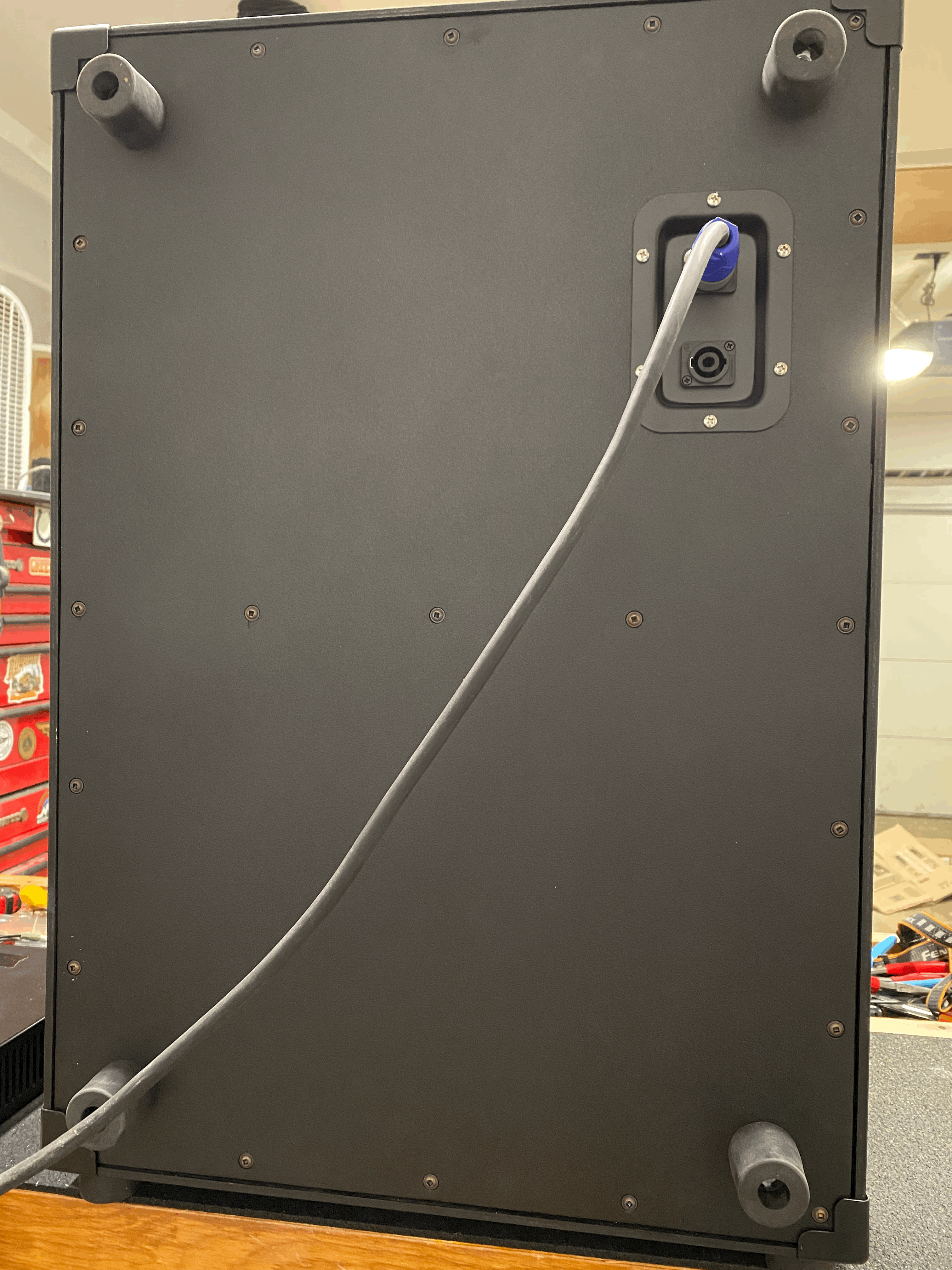

Guess how much this thing weighs? Could be a little lighter but I added rubber feet to the rear panel for transit and another handle on the bottom opposite of the top so you can carry it horizontally. :hyper:

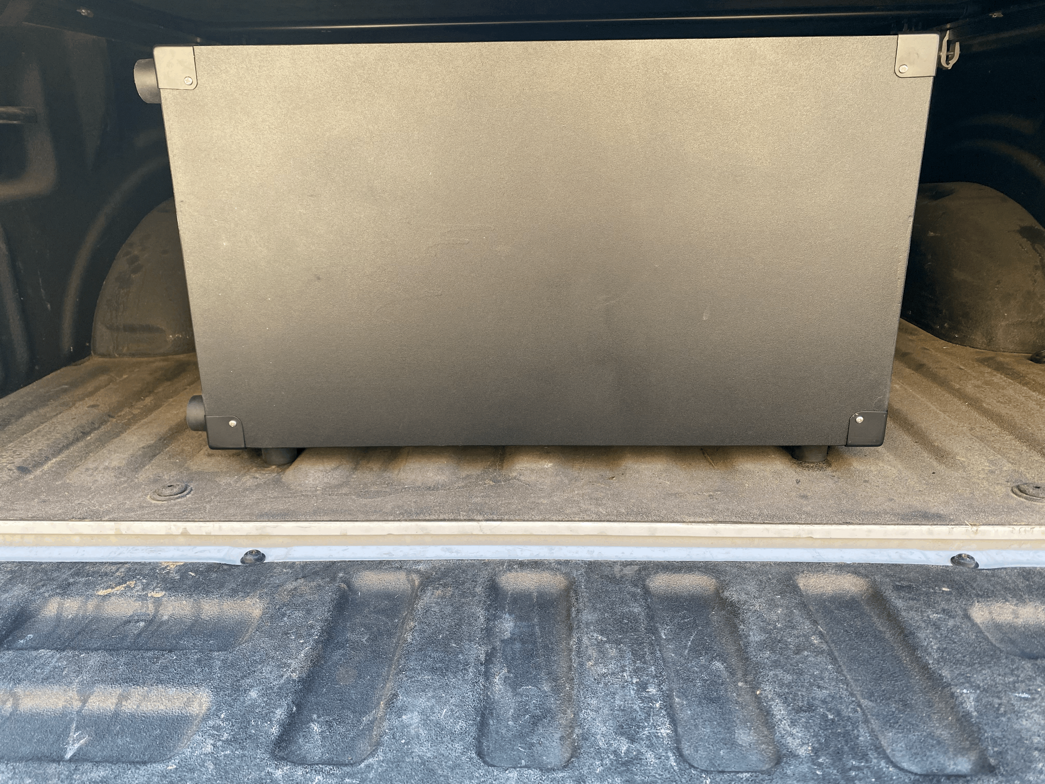

Take a look at how well it travels in the truck!
I'll try to get better pictures and post some more later.

#53 Post by Seth »
Still can't get over how good that came out. :thumbsup:

Really awesome job.
Weldon Carter
Posts: 7687
Re: J210 Lite Build
#55 Post by Tom Smit »
Good-lookin' cab!

Side note: I am curious... why you have a Matco toolbox in your garage? I only have a no-name brand one in my shed. LOL.

I bought it used from an old retired School Bus mechanic in Louisville. Kinda funny, he had it in his 10th floor apartment. I remember the weird looks the other apartment residents gave me while using the elevator to get it out. :lol: Luckily it fit in my subaru i had at the time.
