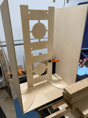

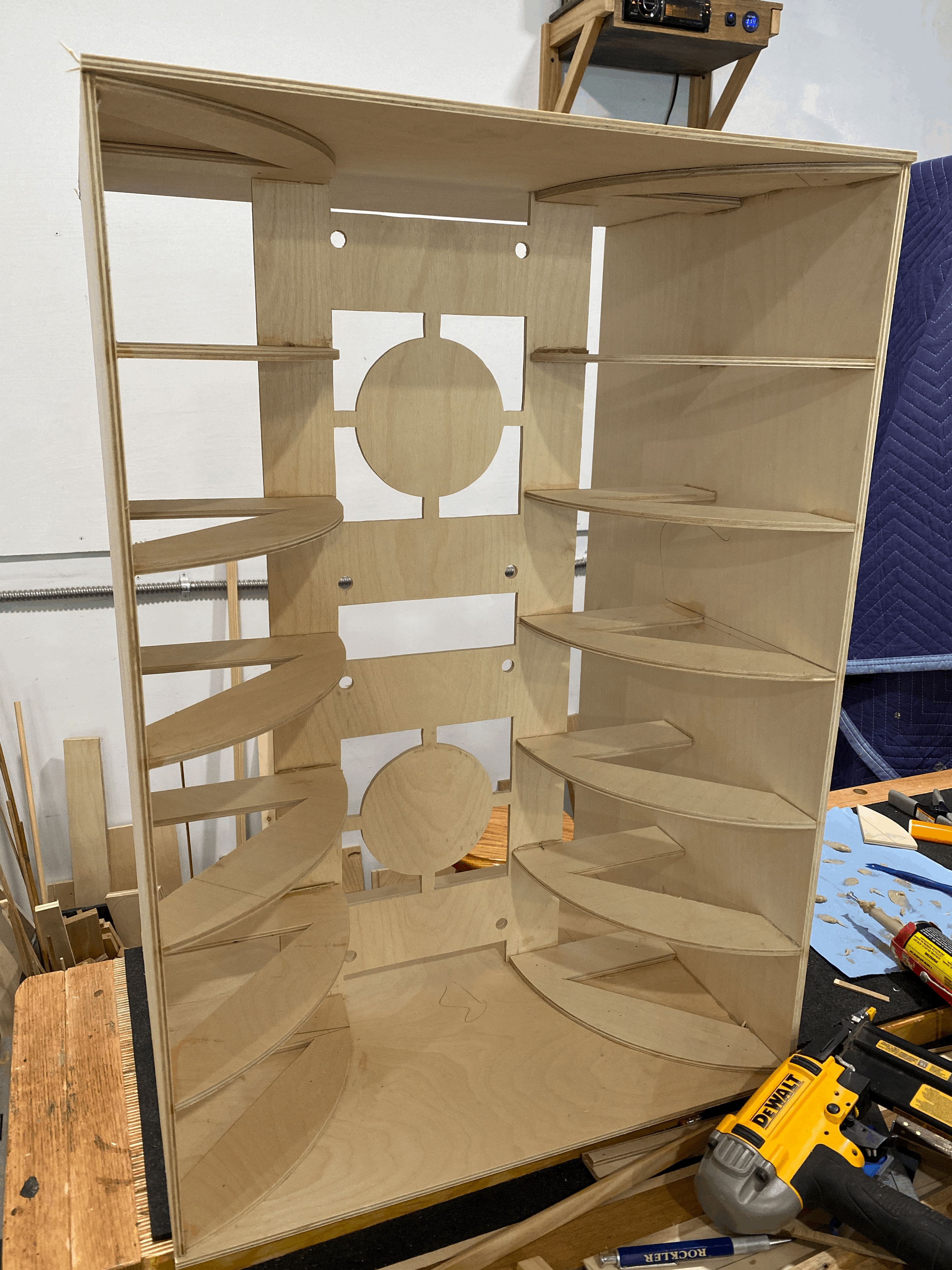

I wanted to share some progress pics with you guys.
Don't really have time to photograph, document and post each step of this process but wanted to share up to this point.
Sourcing the BB this year wasn't cheap. But luckily I live close to a Lumber supply company and they have plenty.

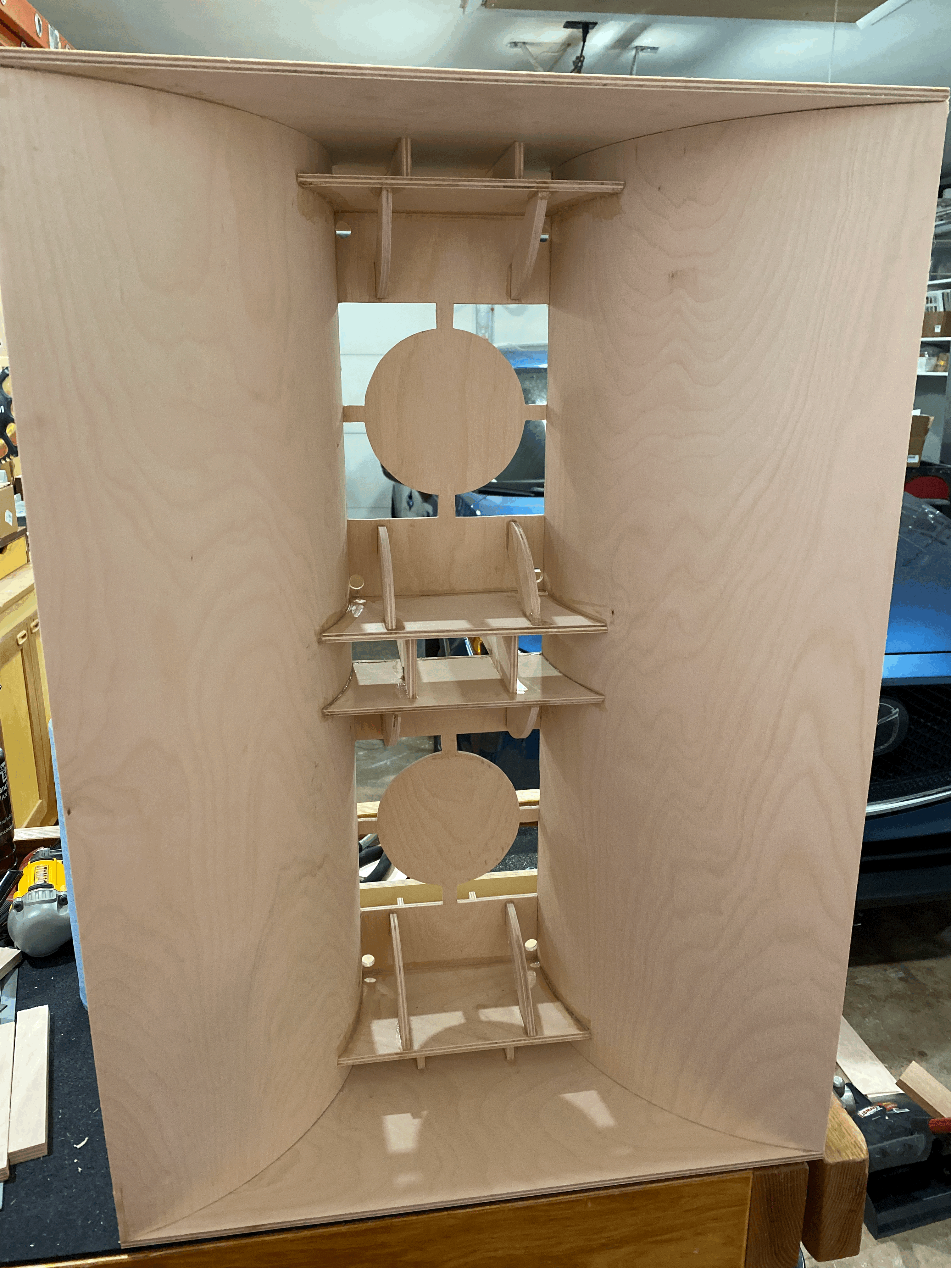

Its been a fun build so far. The glue ups were a little stressful. First time for me using ratchet straps as a clamping method :lol: wan't pretty but it worked.

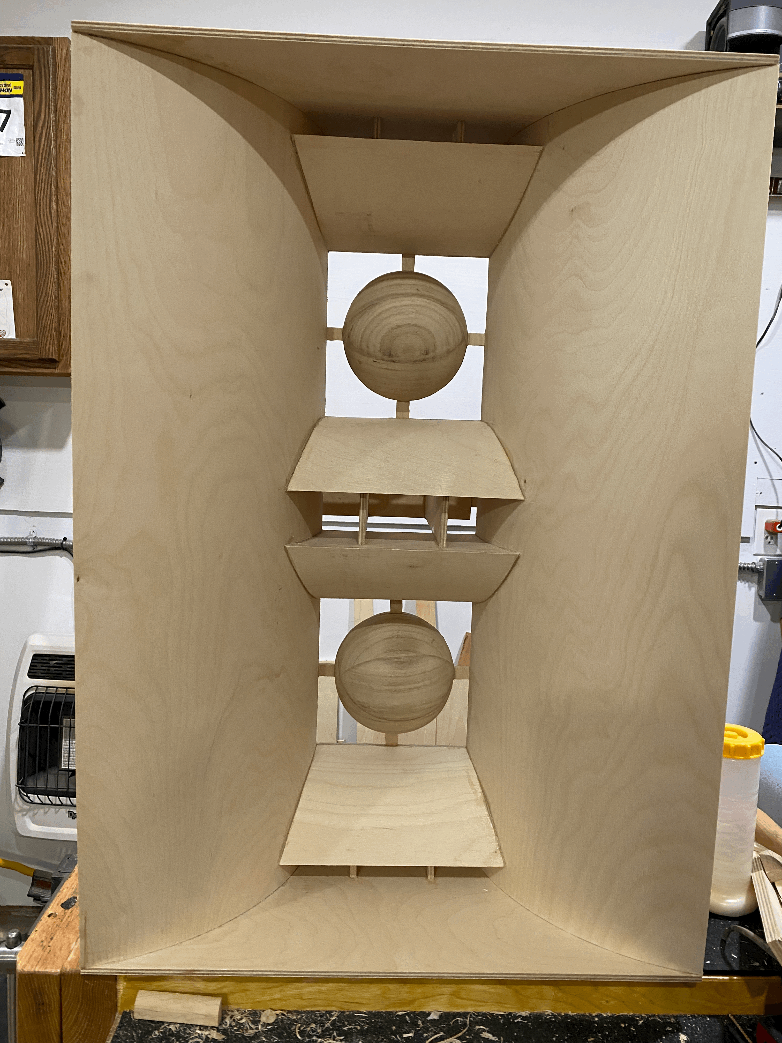

Looking great. Are the phase plugs wood?

9830Lark wrote: Sat Nov 26, 2022 7:35 am Looking great. Are the phase plugs wood?
Thanks,
Yes, found them on Amazon, then sliced em half. I thought they would finish a little better than the foam.

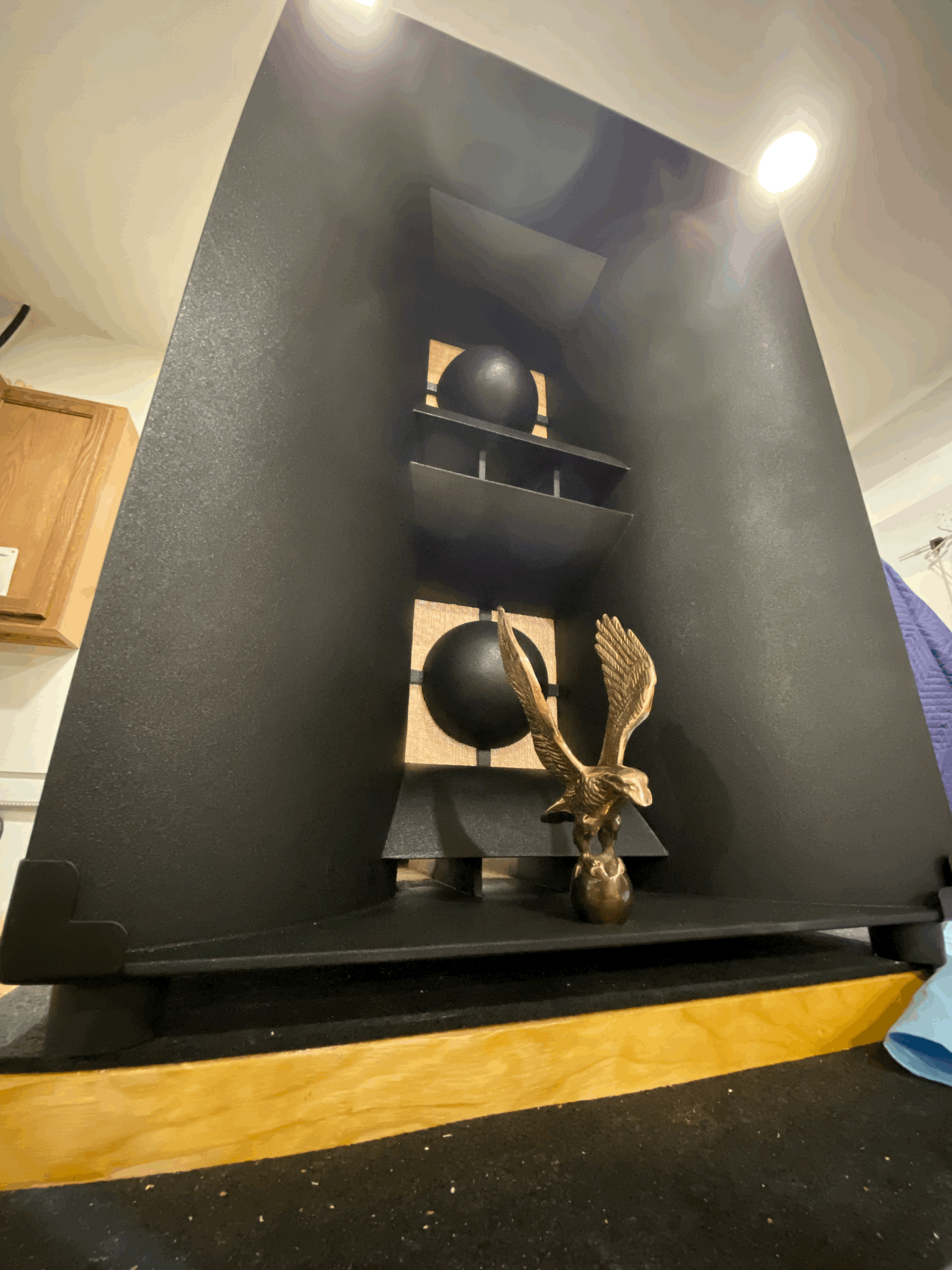

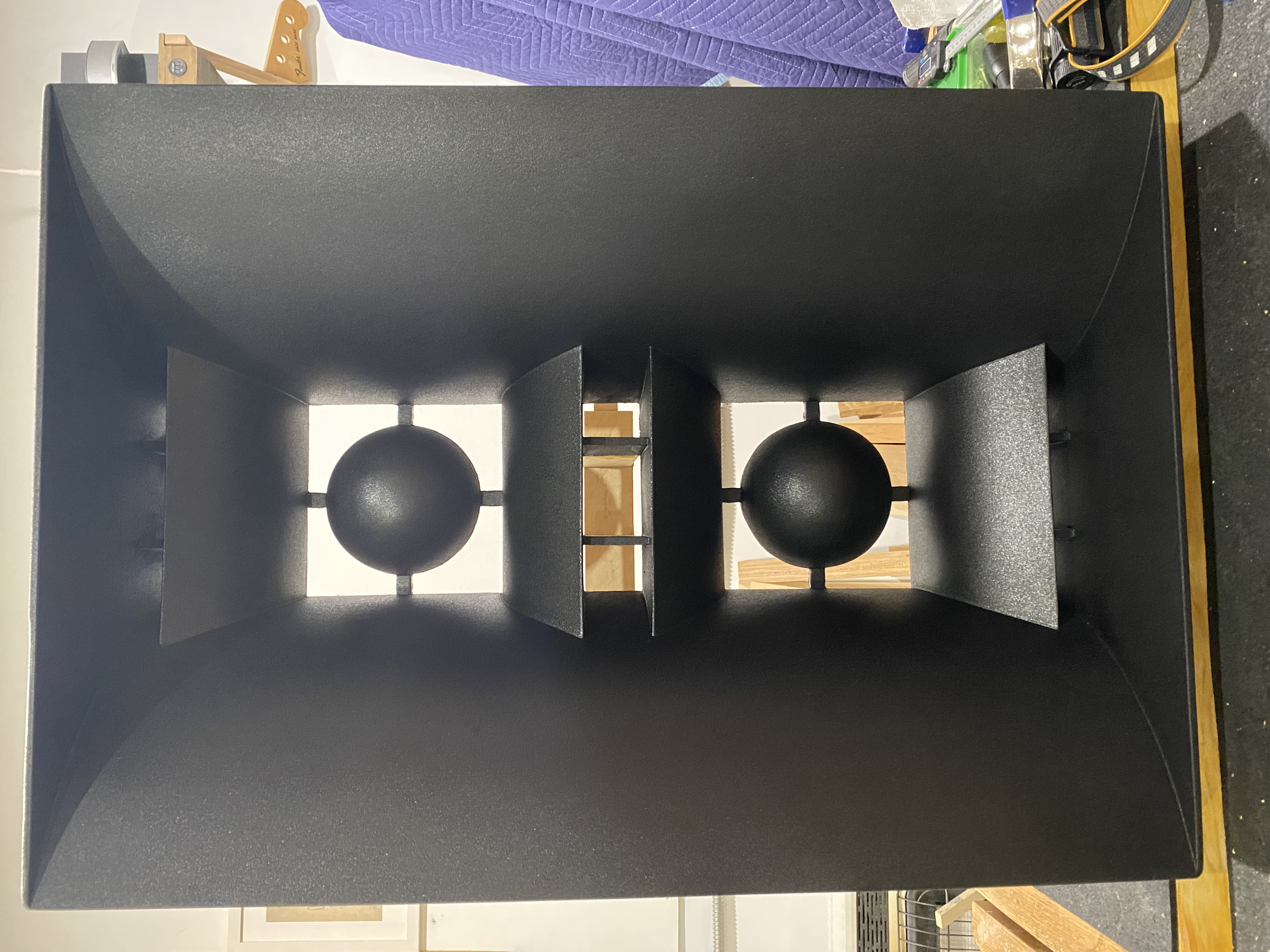

The exterior finish is done.
Now time to start on the inside.

One thing I did to keep it clean was for the smaller horn sheaths. My concern was smearing all of the PL from the sides onto the larger sheath in all of the wrong places so I only glued the the leading edge, trailing edge and the throat sheath brace supports for the clamp up. Once the PL dried/ cured, I went back taped off the the sides and squeezed the PL in the sides.
After all that, I noticed that the PL was appeared a little porous in a few spots so I went back over all of all of the sheath's PL joints with bondo just to make sure they're air tight. Rasps and files made quick work of the bondo 8).
So far this thing is a beast. I sat on it just to test the strength and its solid.
After Its done I'll attempt to weigh it on bathroom scale.

What do think?
Should I mount the bronze eagle on it? :lol:

Beautifully done. With or without the eagle.

Wow man, that's so precise and gorgeous!! How did you paint inside the throats?
