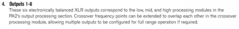

As for the Cross-over: I have had a look at the manual and found this part:
That part I was not aware of. Sounds to me, like either of the outputs can be set to anything from full-range to any frequency range than one desires. The lable at the back "Low" "Mid" or "High" are just suggestions when it comes to how to use those outputs. The advantage of digital cross-over compared to having actual coils doing the job. Nice flexiblity.

If you are going to get a driverack, look for a used PA, PA+, or PX. Much cheaper and will do everything you need. Xover, EQ, AFS (anti-feedback system), limiting, etc.
Setup would be Source (controller, mixer) to driverack to amps (mains and subs) to speakers.

Think about it for a minute......what is an active speaker? It's just and amp and a speaker box where the cable between them is really short since the amp lives inside. Take the amp outside of the box and put it 20 feet away......what's the difference? None.
The PX is merely a device designed for a two-way crossover instead of three-way. They priced it a little cheaper and marketed it to people buying powered (active) speakers. All of the functions are exactly the same. The only thing a PA2 will do for you that the PX won't is the addition of iPad control. You have no need for that - everything is available on the front screen and once you set it - you are done.
As far as all of the models in the PX (those are in the others too), you won't be using them. You will use a Custom setting, picking your own crossover points and gain for the tops and subs.
I own and use the PA, PA+, and the PX - all in one rack. While the actual interface varies a little from model to model - what they do is exactly the same. I've set up a few systems in my time with used PX units because they were the cheapest to find.
