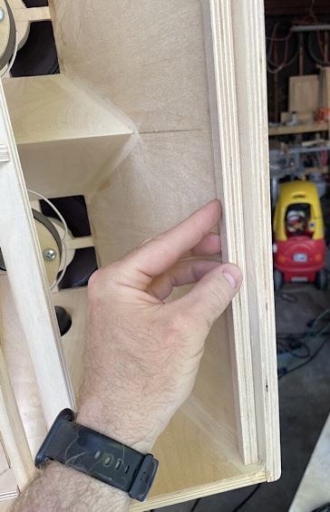

Would having a 1/2 inch edge along the inside of the cab cause any adverse effects? To mount a grill.

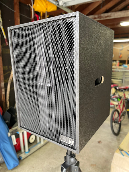

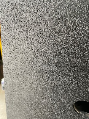

Finally getting around to putting some paint and duratex down.
It’s subtle, but I painted the cd horns a dark gray. I wanted them to stand out just a little bit so when people walked by they might take a second look.
That’s some interesting stuff, that Duratex. I had to go back and forth over the same area multiple times to get a consistent texture. I suppose spraying it would have yielded better results, but I’m happy with it.
Oh and the grills look reeeal nice!
Thanks Leland!
Thanks Leland!

Thanks!
I still have some touch up work to do, but they sure do look more suited for the wedding reception gig tomorrow.
