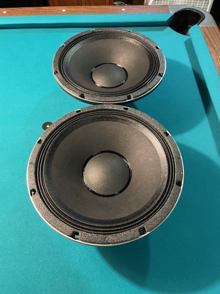

I’ve got it wired up to the ASDs and Betas for testing.
It makes music
It makes music

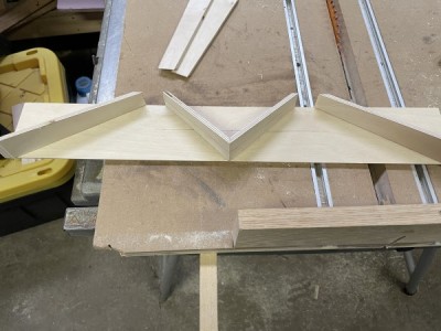

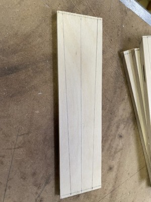

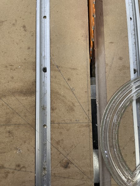

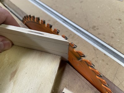

Here i drew a line a line on my cross cut sled, to help me line up a stop block for cutting the CD horn pieces. I also made my original cuts bigger than necessary, so that i could cut up to the line.

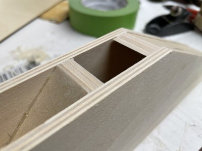

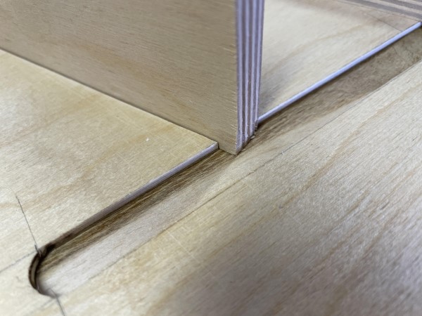

Test fit

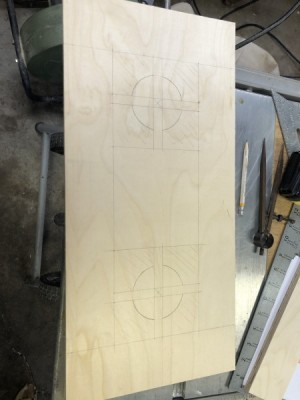

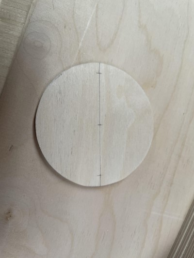

Drawing out the OT8 speaker mounting plate

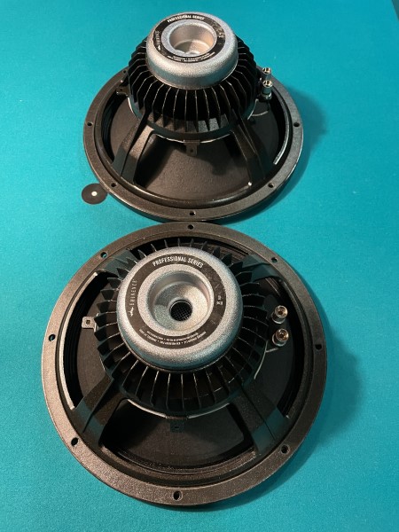

AND the mail man was nice to me today! worth the wait! Now i wish i would have ordered four...
Test fit

The OT8 plans call for a phase plug extension, these are flat disc. Would there be any advantage to making them similar to the throat filter called out in the DR plans?
- Posts: 29097
Re: Dunavin’s OTop 8 build
I tested various configurations, what's in the plans is what worked best.

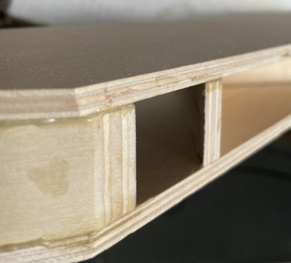

Working on the CD horn.
I tried to glue everything as straight as i could, but ended up with some unevenness.
Nothing a sanding block can't knock down.

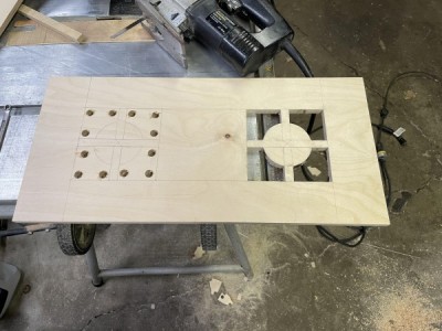

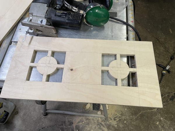

Just a blank for the CD driver, I did draw out the outline, center hole and mounting holes in QCad and then just used a pic to make the center holes.

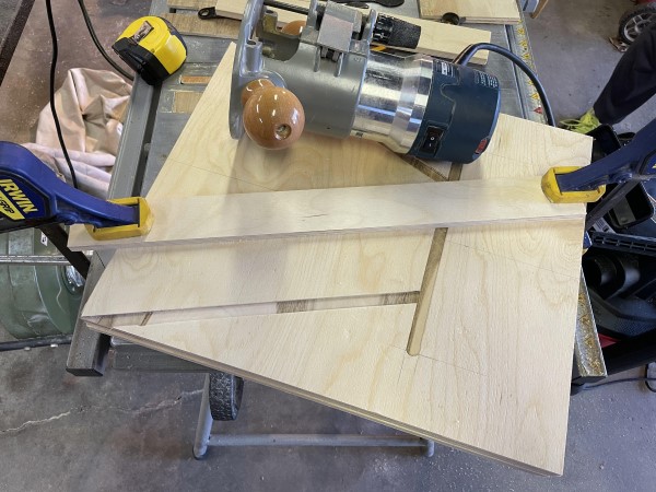

Cutting out the holes for the driver baffle. I know ... way too much extra work here, but i've gone the extra mile and am routering an 1/8th deep slot for the panels to fit into. No weight penalty and will make for a stronger cabinet. ( yes i made the appropriate panels 1/4 longer to accommodate )
