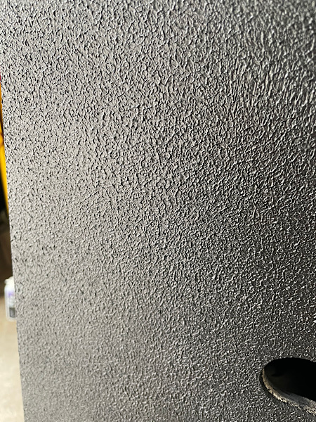

Finally getting around to putting some paint and duratex down.
It’s subtle, but I painted the cd horns a dark gray. I wanted them to stand out just a little bit so when people walked by they might take a second look.
That’s some interesting stuff, that Duratex. I had to go back and forth over the same area multiple times to get a consistent texture. I suppose spraying it would have yielded better results, but I’m happy with it.

Ooo…that turned out looking great!! :clap: :D
