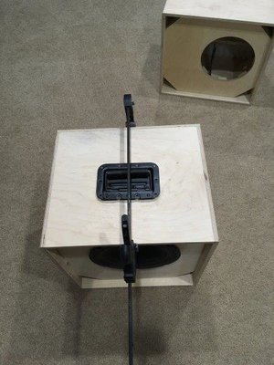

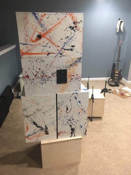

Back panels attached using finish nails and clamps and what I had available in the basement. Tomorrow is drilling for the speaker mounting screws for the purpose of temporarily installing the speakers so I can find the center of gravity for the handles.
I am really looking forward to getting these cabinets done so I can try them out.

Very EVH - certainly original.Das Jugghead wrote:Back panels attached using finish nails and clamps and what I had available in the basement. Tomorrow is drilling for the speaker mounting screws for the purpose of temporarily installing the speakers so I can find the center of gravity for the handles.
I do like the way people personalise their cabs, I think it adds to the live visual experience.

Hey Chris thanks for the compliment. The painted cabs were thrown together using scrap plywood I had and old Hartke speakers that were sitting in the basement to get them used in something. The paint was more of a tongue in cheek "let's put lipstick on a pig" joke than a serious effort and turned out surprisingly okay. I have to agree that I prefer to see elements that add to the visual performance; be it players who move around, gear that has a visual attraction, media that compliments the music, etc. .. . Nothing gets me to the next bar or club down the street faster than a band that has had their feet PL'd to the stage. I like being a little different from the standard issue black cabinets. Doesn't mean there is anything wrong with that - it's just not for me.Chris_Allen wrote:Very EVH - certainly original.Das Jugghead wrote:Back panels attached using finish nails and clamps and what I had available in the basement. Tomorrow is drilling for the speaker mounting screws for the purpose of temporarily installing the speakers so I can find the center of gravity for the handles.

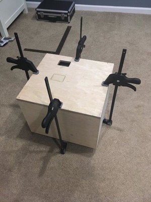

Here's another shot of the other cabinet setting up with cheap (albeit effective) Harbor Freight clamps.

More like Jackson Pollock. They could be worth millionsChris_Allen wrote: Very EVH

Ha - thanks! A friend of mine made the Jackson Pollock comment as well after seeing them. Not sure about the millions but if I can get the old cabinets sold and out of the basement for $100 I know my wife would be glad to see them out of there.Bill Fitzmaurice wrote:More like Jackson Pollock. They could be worth millionsChris_Allen wrote: Very EVH...after you're dead

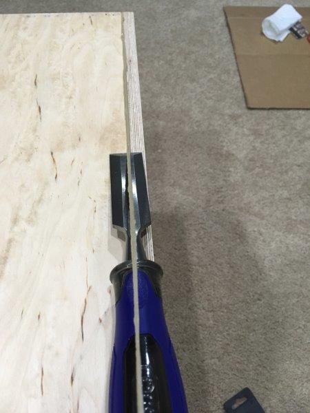

Cleaned up the excess PL with a sharp chisel.

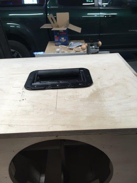

Rough handle placement prior to working out the center of gravity.

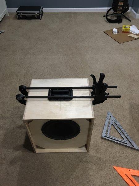

Finding the center of gravity left to right with driver temporarily installed.
Finding the center of gravity front to back with the handle.

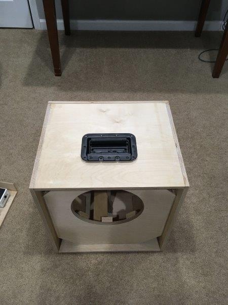

Handle pockets routed. Now to deliver cabinets to Colorship Media on Monday to be wrapped.
