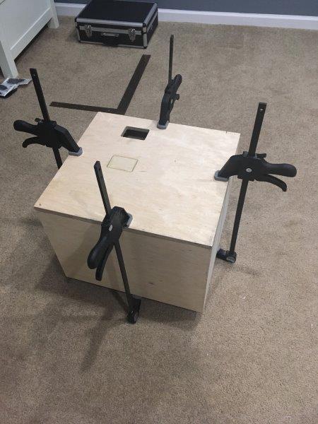

Here's another shot of the other cabinet setting up with cheap (albeit effective) Harbor Freight clamps.

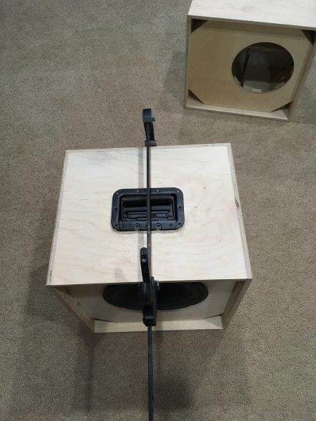

Finding the center of gravity left to right with driver temporarily installed.
Finding the center of gravity front to back with the handle.
