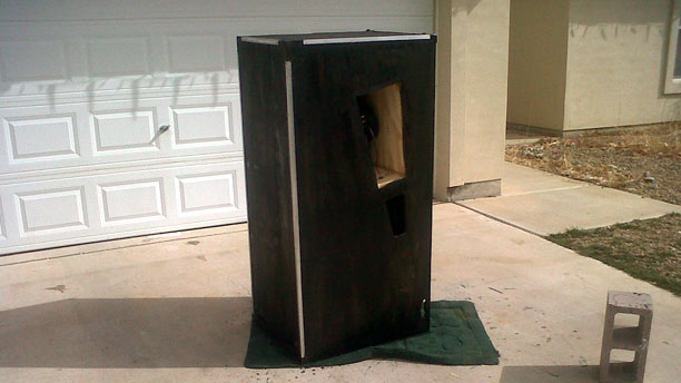

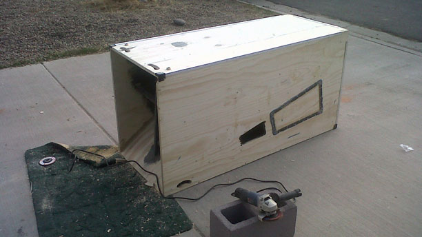

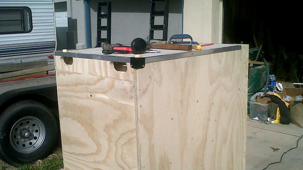

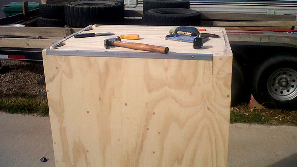

I choose to put the corners rails and corner brackets on before I Stain the wood to prevent the “unforeseen” slip of a hammer or sanding that could scratch the stain. I carefully mark the space for the Corner wheels. The Corner brackets are from reliable hardware as is the corner wheels.  The corner rails are actually corner wall protectors from Lowes.
The corner bracket gets placed after the corners rails.

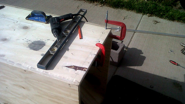

Of all the Handles the ones on the front horn are the most important. Here I’m drilling them out and using a scrap piece of wood to keep the drill from making a jagged rough hole.
Done, Filed and sanded smooth. Bamboo skews make excellent hole fillers with just a touch of PL and then sanded down.
The whole Tuba gets a twice sanding with 60 then a final sanding with 150.

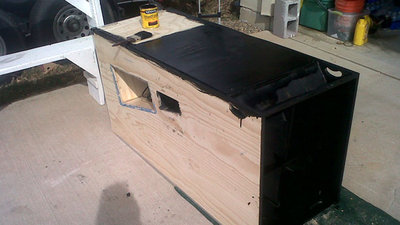

Finally Staining begins

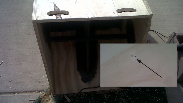

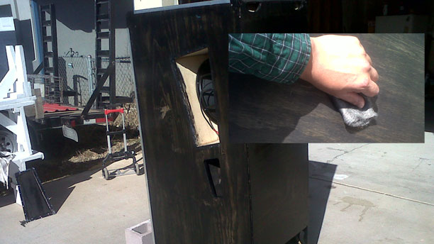

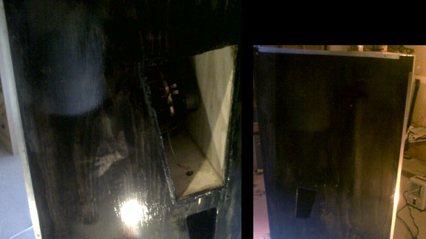

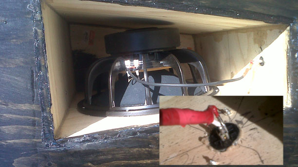

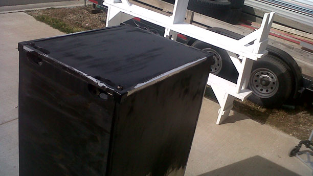

I removed the Driver access door because during testing there appeared to be a leak coming from inside the Speakon cable plug. Here I’m staining with the grain with minwax ebony wood finish. Initially we wanted to carpet the tuba or spray with duratex but settled on black wood finish with four coats of interior polyurethane.
We came to like the finish and wood grain that shows.
When Wiping off the excess stain be sure to wipe the aluminum clean.
The temperature was in the high 50s so the stain dried quickly enough to accept the first clot of ploy. About 5 hours

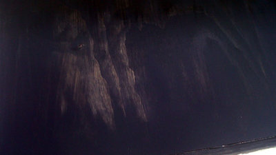

I do a final wipe of the black stain with a fine steel wool to smooth out any irregularities in the surface and staining.

The Speakon had a small area in the back seam were the glue didn’t seal the end so we globbed it with Blue silicone gasket maker to seal it.

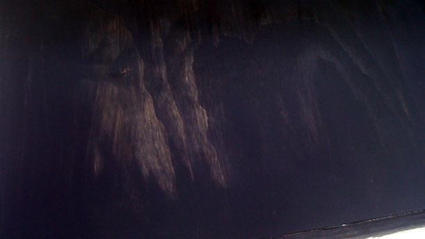

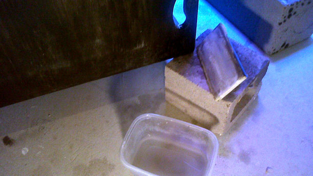

Wet sand, one coat poly and wait. If your Tubas is going to be outside alot, then pony up for exterior polyurethane to prevent the clear coats from getting a yellow tint to it.
The key to a nice water resistant finish is thin smooth coats of ploy so each coat is wet sanded with 400 grit sand paper 24 hours after the previous coat was put on. Feather sand until the surface feels like glass. Be gentle lol
Coat two drying; we use a semi-gloss it seems to have the middle of the benefits of flat and gloss. It over words it’s just right.

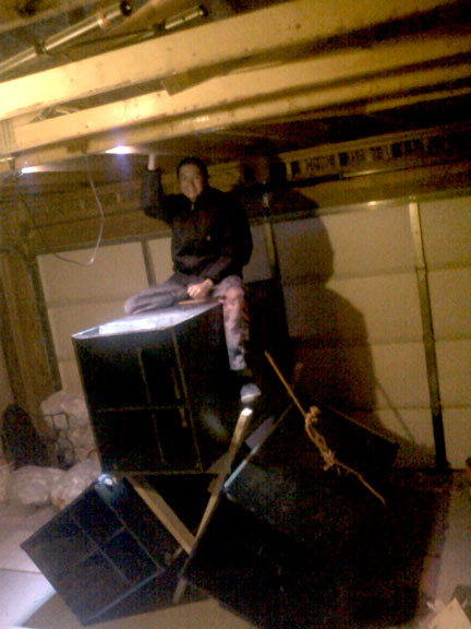

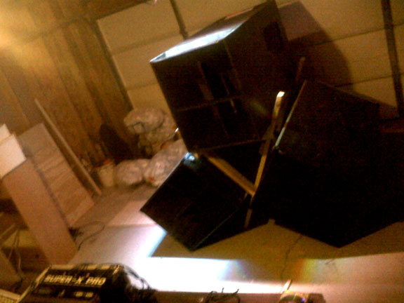

We didn't have enough time to build the four tuba so we did some experimenting with placement.....
:noob:
The thought in my head...
The execution
The execution
The reaction :D
The reaction :D
88h88
Posts: 1618
Location: Coventry, UK
Re: Zefren's Reservation Tuba 60
#53 Post by 88h88 »
It looks like the missile pod for a massive sci-fi robot... I approve. :mrgreen:

Bruce Weldy wrote:You look like Slim Pickens riding the bomb in Dr. Stranglove....

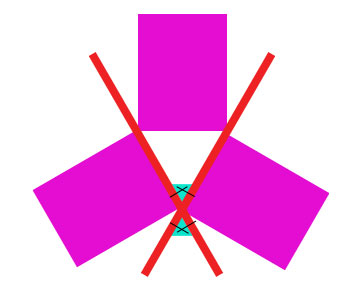

Testing the Tri pod Stand
#57 Post by zefrenm »

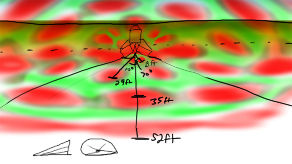

It was going good until the tubas woke everyone working Grave yard in a 100 yrd radius from my house but managed to listen to how the three tubas performed this way heres a picture of what i heard in a 150 hz wipe to 5 hZ played in 30 secs over and over again marking places that was louder and places that sounded like only one tube vs three.
The test a cone shaped cross section

That tone sweep video is bloody gnarly, you've got some serious warfare. With the above "graph" which colour represents which? Did you do this by ear, or do you have some special desert storm technology out there?

The teepee arrangement seems pointless unless you count the visual appeal. How about wall or corner loading them according to Hoyle?
