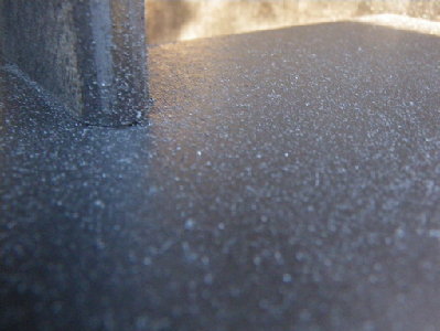

hmmm... actually 2 of of them isn't really enough for a big beast like a 22" T39. 3 would do, 4 wouldn't hurt.
Saying so, apart from the bottom panel that hasn't been done, I still got a decent finish out of those with just a single coat. It looks quite tidy and that will do for now until it needs some touching up, or until I can source a bit more of them.
Texture close up :
it looks more authoritative in Black!

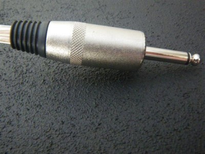

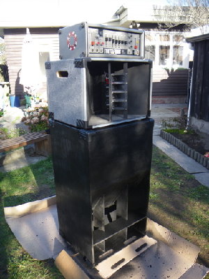

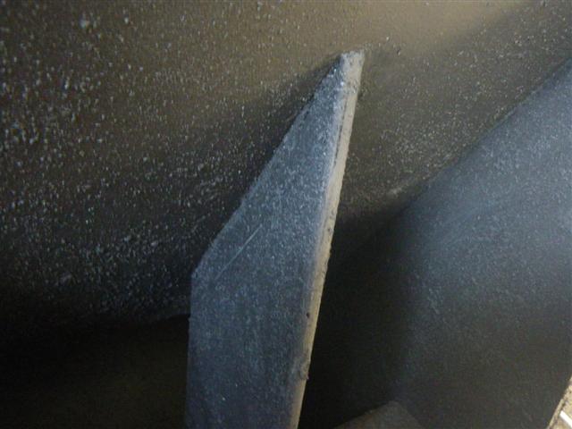

So here it is, I've finally done my refinishing on the T39 using the Easytread from Phoenix paint, available from kemtek in NZ.
I paid NZ$100 for 4L delivered to my doorstep.
The finish is pretty good, at times I struggled a bit to obtain an even texture, but I'd put that on the technique used.
The paint is very black, thick, gooey-ish, covers really well, it's not stinky, and can be used indoors. Still, a generous tarp to cover the working area is mandatory as there are some drops and quite a few black particles are splattered around.
I used the standard paint small rollers, not the textured ones and maybe that's a mistake.
I found it's best to not put too much pressure on the roller, as this would lead to particle buildup on the roller, sort of an imbalance in the ratio of wet paint and particles which eventually will mess up your job once all those particles are released on the surface, or more likely on the edges, mouth braces, etc... Then some light sanding between coats will be required in those places.
Also painting vertical surfaces is definitely trickier, as any excess on the roller is likely to end up on the floor before you have time to roll it around. That's the nature of the goo. This gets better as technique gets refined though.
Here are a couple of shots
With a Neutrik jack for scale of particles:
In the hard to reach parts, it's a bit harder to get the even result...
