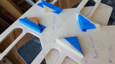

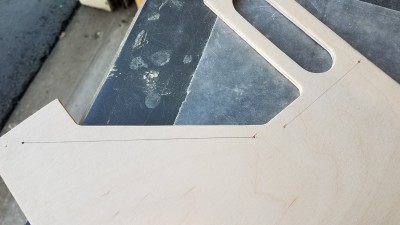

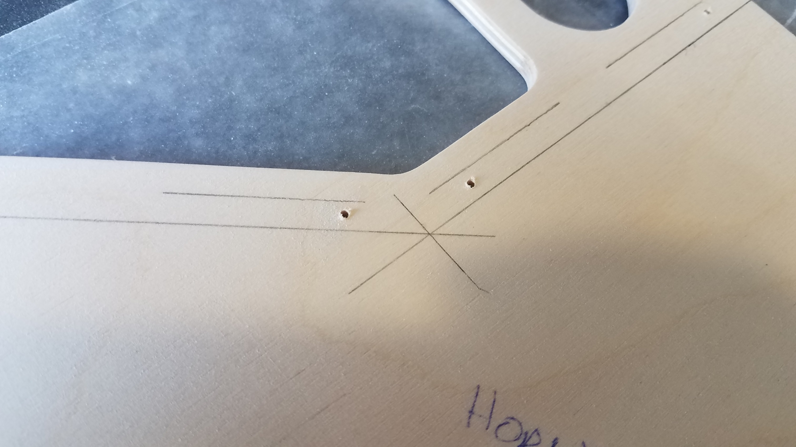

The plans mentioned predrilling the top and bottom before assembly. I assume that's for assembling with ½" ply and screws. But, I took it as a que to utilize the method in some of the other plans of marking where to drive the fasteners in from the other side. So, I got a little piece of ¼" scrap, marked the width, and drilled a hole through the end of each panel location.
I flipped the panel over and connected the dots. These lines should indicate the centerline of the attaching panels.

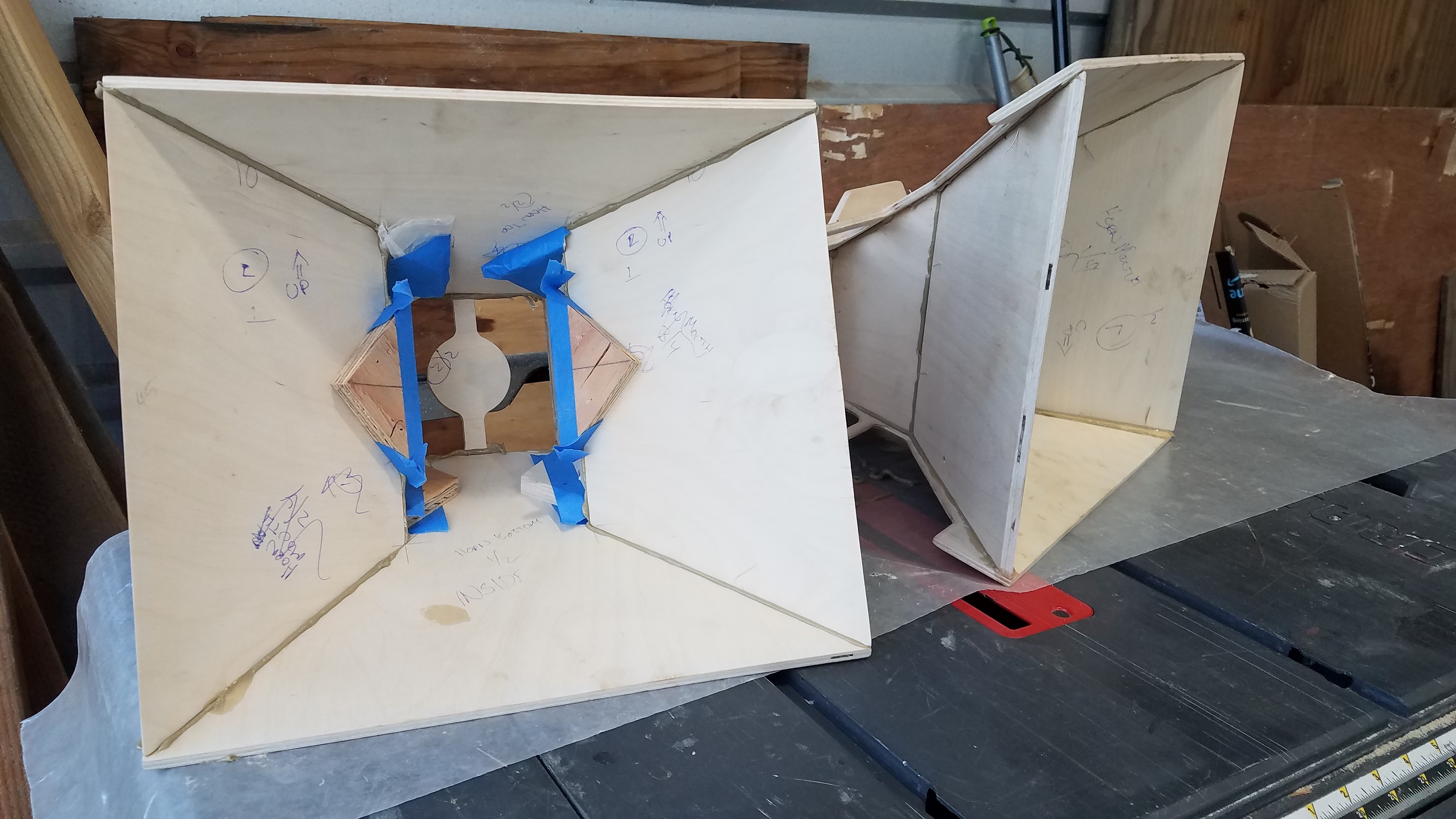

Two bottom horn panels ready to go. I got tired of wrapping everything in wax paper and just put blue painters tape on the temporary guides. Hopefully it's not too difficult to remove later. Guides are tacked in place with a couple 23 gauge pin brads/nails.

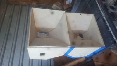

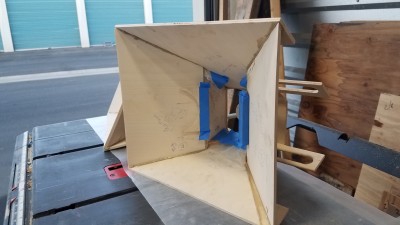

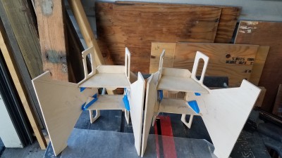

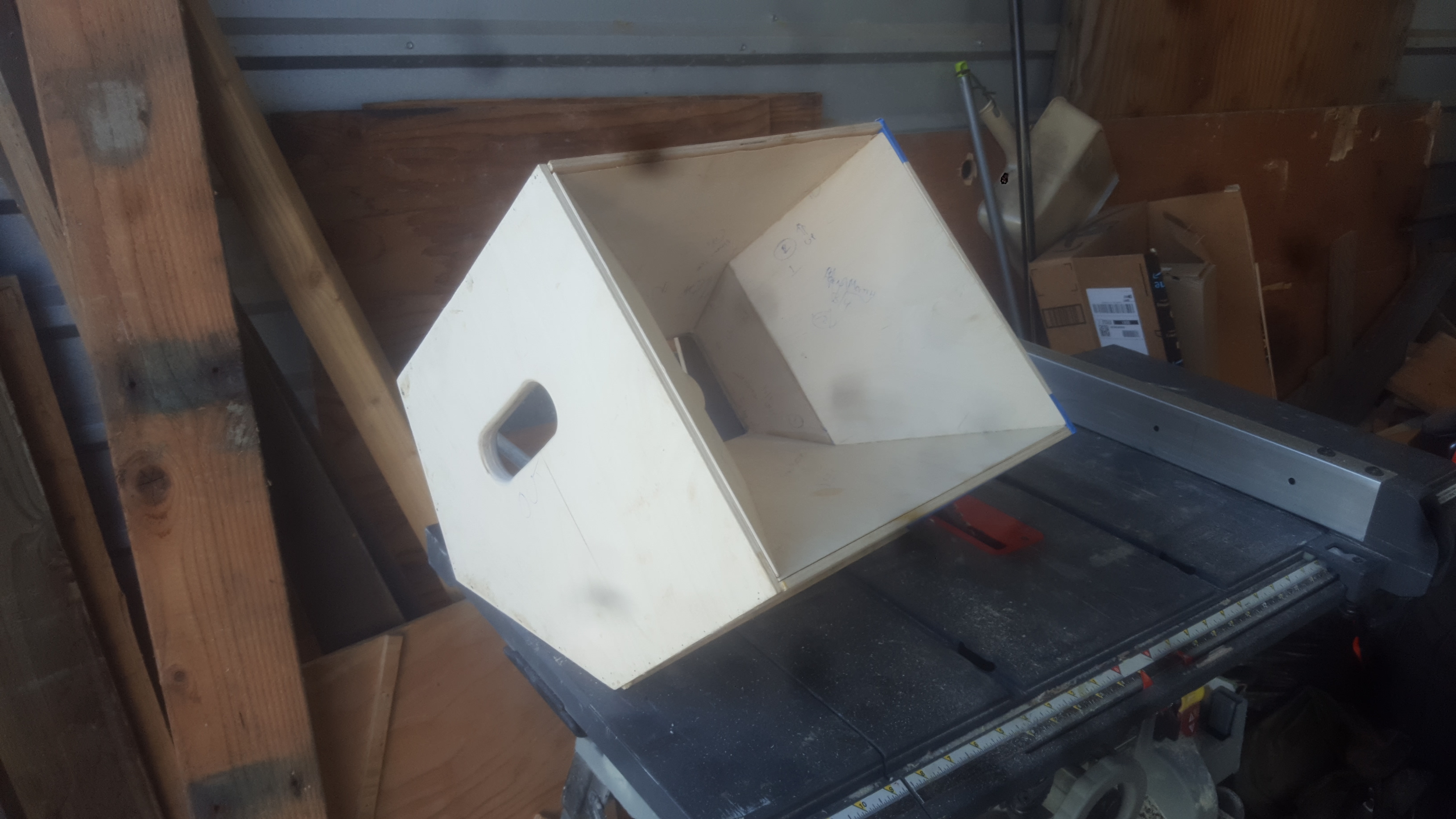

Top and bottom horn panels installed. They're on their sides in this pic, top of the horns together in the center.

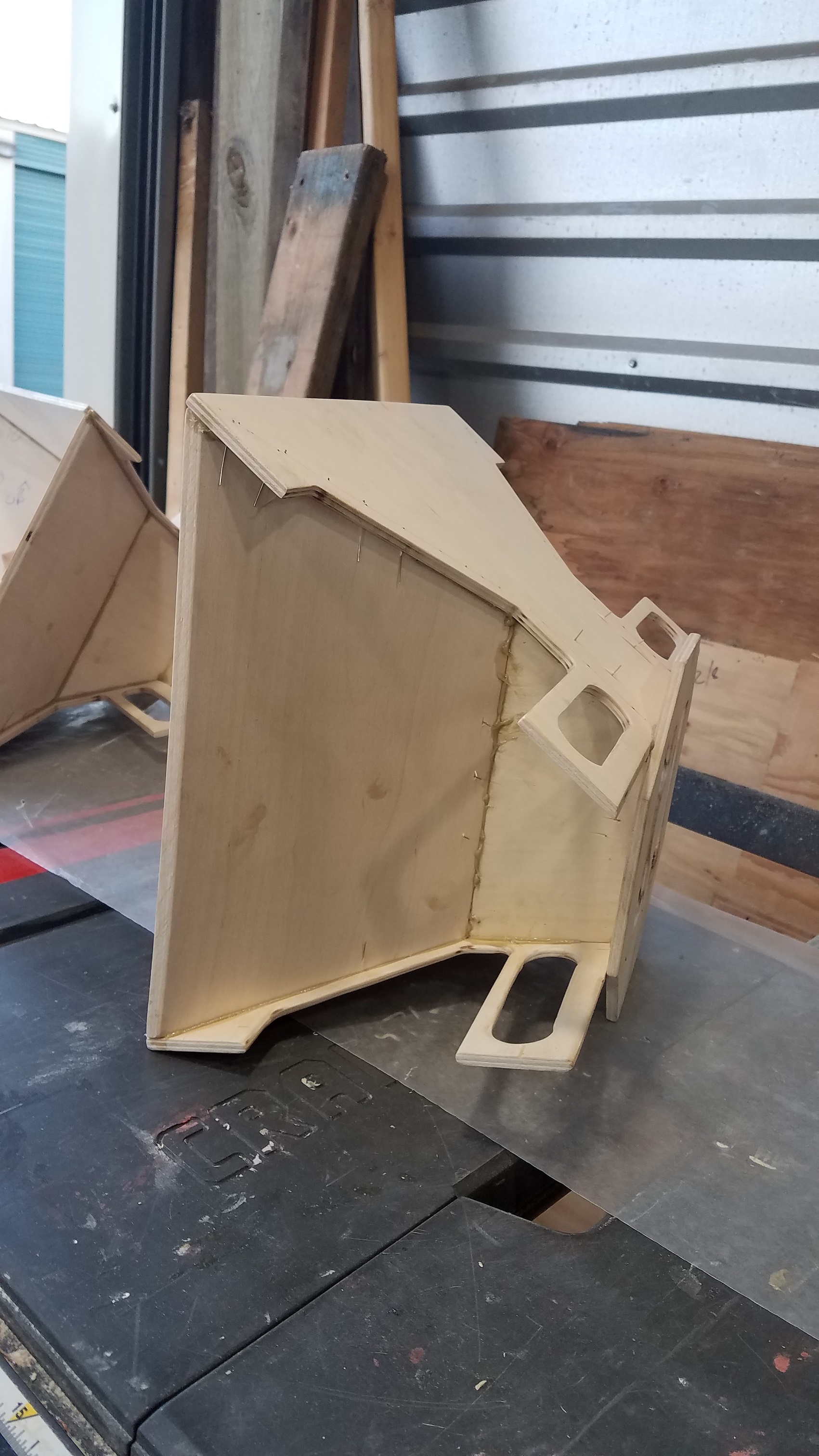

Horn sides attached. Left one is right-side up, right one is upside down

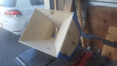

Another angle, this one's upside down.
And... another angle, also upside down.

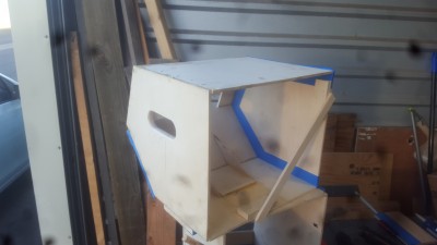

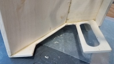

Detail showing how much I removed and how much I left from the original design. The oval lightening holes aren't centered. I was originally going to thin those parts, and the holes were drilled/cut based on those dimensions. But changed my mind, so the holes are not centered. Not worried about it. Wasn't worth my time to shave a couple grams of weight off the build.

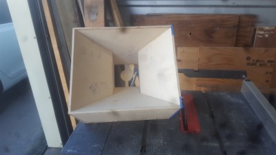

The horns are done for now, other than gluing on the woofer spacers, phase plugs, and tweeter supports (which are all later in the plans anyway). Looks like I'll be getting started on the outer shell assembly tomorrow.

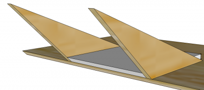

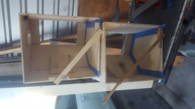

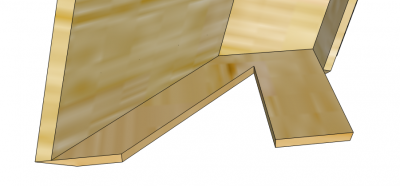

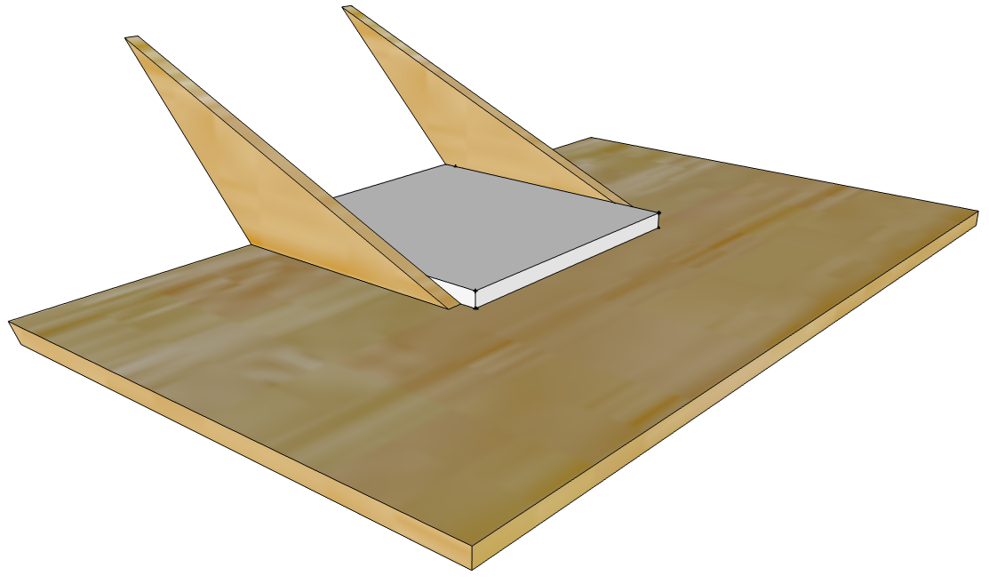

Both outer shells are put together. After careful consideration and review of the SketchUp renderings, I'm fairly certain a top hat pole mount will just barely fit in the rear of the bottom panel, which I plan to recess into the panel so the top hat mounting flange is flush with the cab surface. So, to accommodate that modification, I glued a backer to the inside of the bottom panel, between the support braces to keep the area rigid when the recess gets routed out. Pics I took of that are no longer accessible, so here's part of the SketchUp to get an idea of what I did.
I also cut the matching angle into the rear edge of the backer to match up with the braces and adjoining panel.

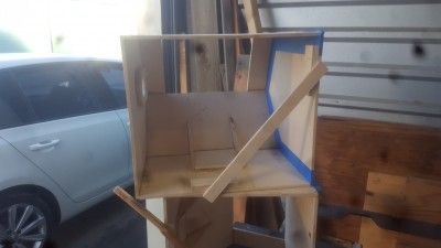

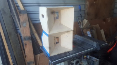

Here's the completed outer shells:

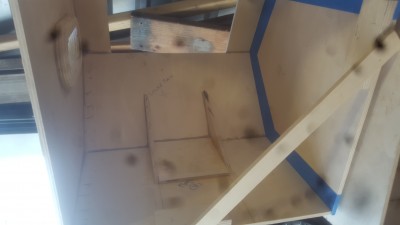

Not sure why these next two are showing in the wrong orientation. If you click on them, they'll show in the correct orientation. Enjoy!
You can see the additional backer I added in these next few.
Gonna do a little more reading ahead and make a plan for tomorrows goals. Maybe take on doing the melded arrays.
OH! I almost forgot to mention that using the blue painters tape in leu of wax paper worked like a charm. Didn't stick to the glue at all. It's way easier to work with it than futzing with the wax paper. I recommend you give it a try on your next build.

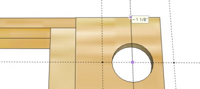

I'm starting to get the hang of using SketchUp... and I'm liking it more and more. You guys weren't kidding about it being an invaluable tool. I'd say it's especially the case when wanting to make customizations. Here is an example, I want to know where to drill my hole to put in the ¼" jack on the top right of the upper right side panel. Move everything out of the way so I can see and measure the space available, avoiding other parts in the area. Then get the measurements I need without having to futz with penciling it out in the workshop.
I need to drill my 15/16" hole, 1 1/8" from the top and 15/16" from the side to have the jacks mounting flange land ¼" down from the top and directly between the side and the access panel flange.

What a GREAT tool! Took less than an hour of YouTube's and fiddling to get the basics down. Kinda fun too!

Here's the daily horn porn.
