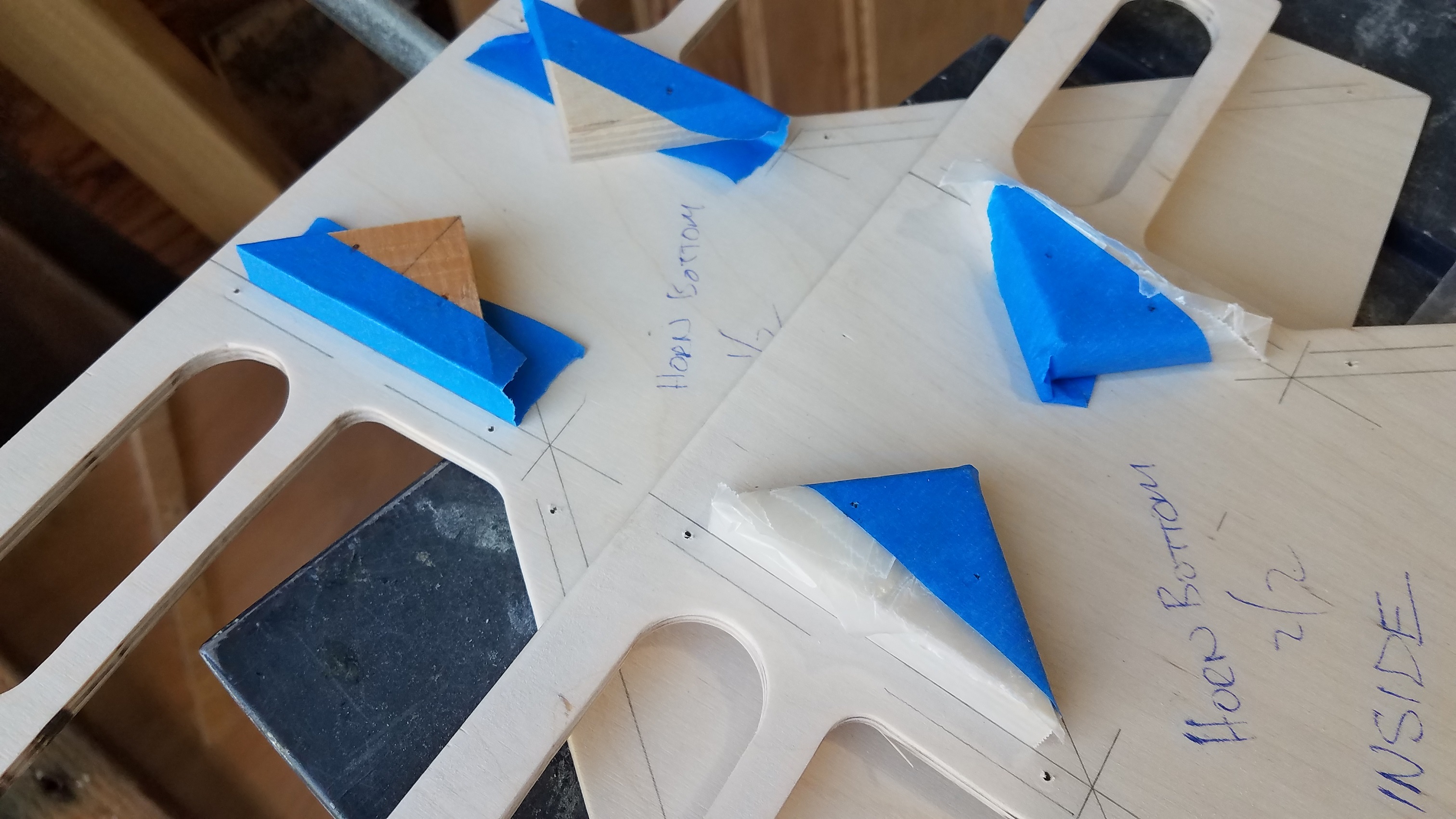

Two bottom horn panels ready to go. I got tired of wrapping everything in wax paper and just put blue painters tape on the temporary guides. Hopefully it's not too difficult to remove later. Guides are tacked in place with a couple 23 gauge pin brads/nails.

OH! I almost forgot to mention that using the blue painters tape in leu of wax paper worked like a charm. Didn't stick to the glue at all. It's way easier to work with it than futzing with the wax paper. I recommend you give it a try on your next build.
