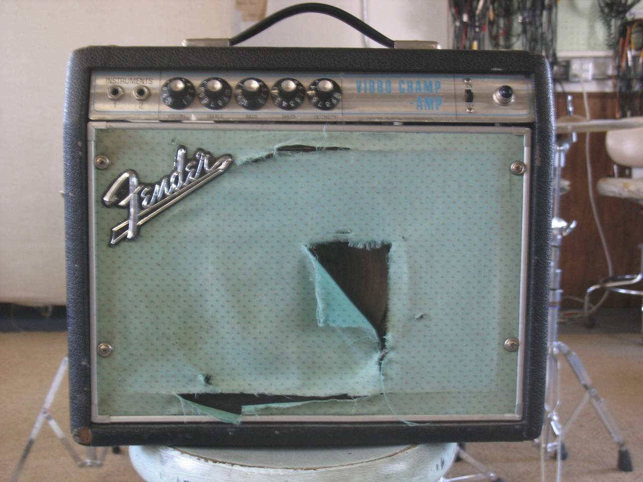

This is the one I built....

I would pay some money for that little vibro champ.

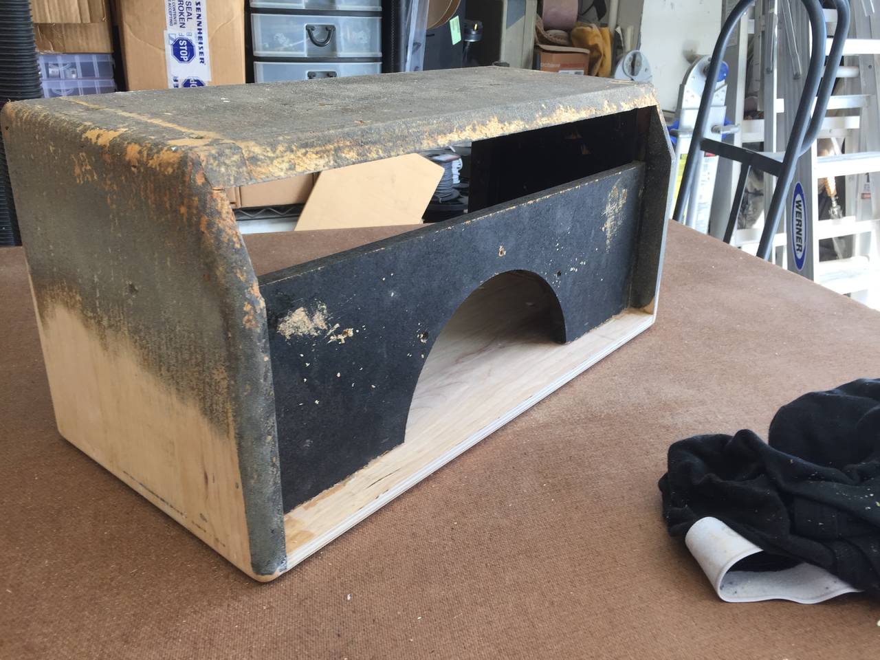

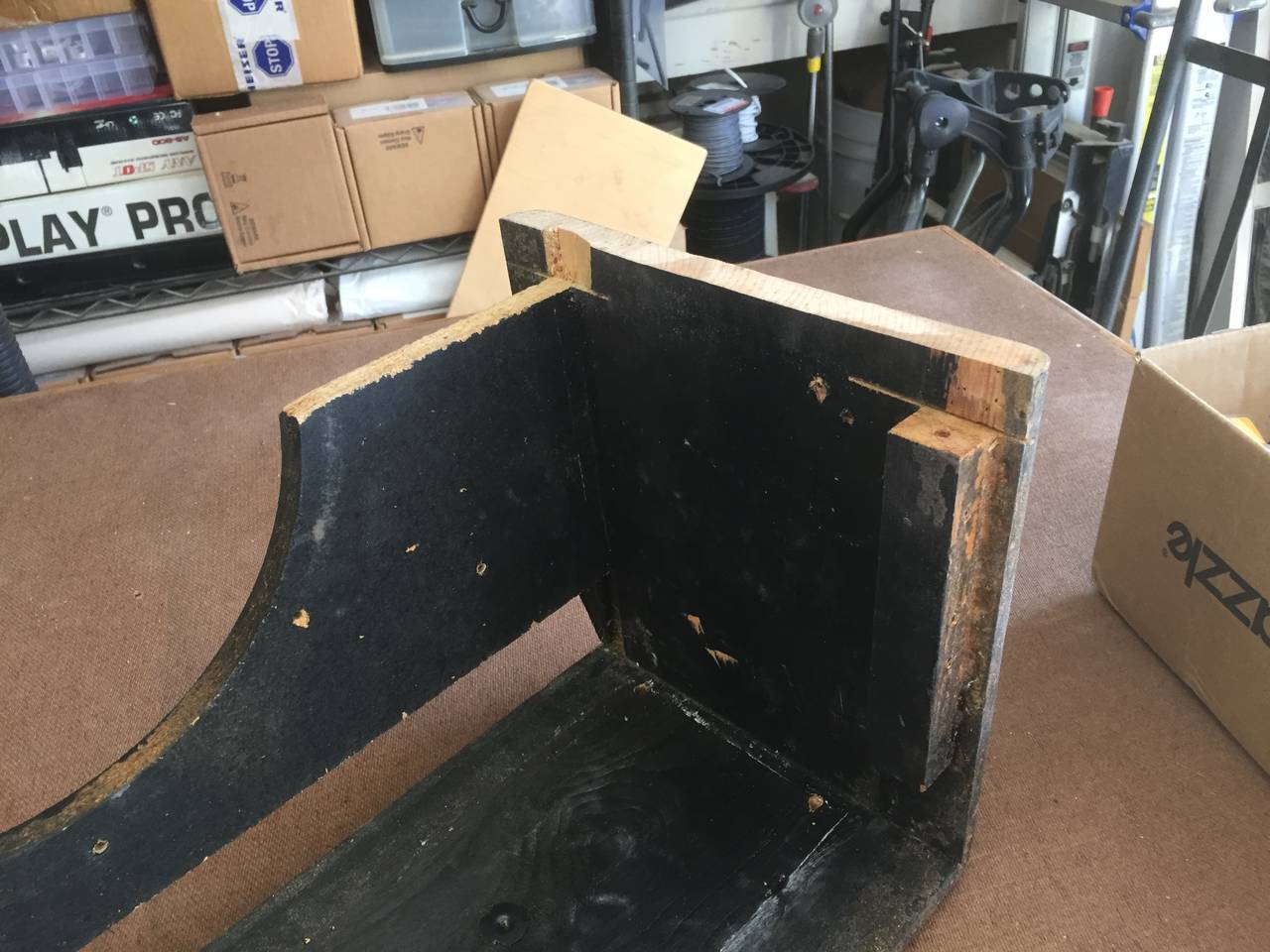

I haven't touched a Princeton pretty much in my life until I built this one.....then yesterday a local amp repair guy brought me a Princeton cab that had been cut down to make it a head.....looked like it had been done with an ax.....maybe a circular saw....and the bottom was missing.
So, I put a new bottom in it for him....he didn't do this, he's fixing it for a customer..

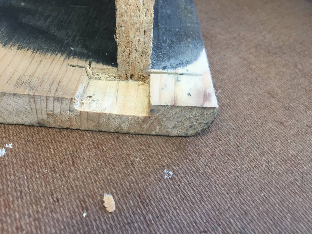

What a mess.... Cleaned up the gouges with a chisel.... Filled 'em with some scrap BB I had laying around.... Put on the new bottom, flush cut it, then routed the edges to a 1/2 roundover to match the rest of the cab...
- Posts: 8646
Re: Princeton Reverb Build
Ready for more sanding and new tolex.....that's his job....I just did the woodworking...
