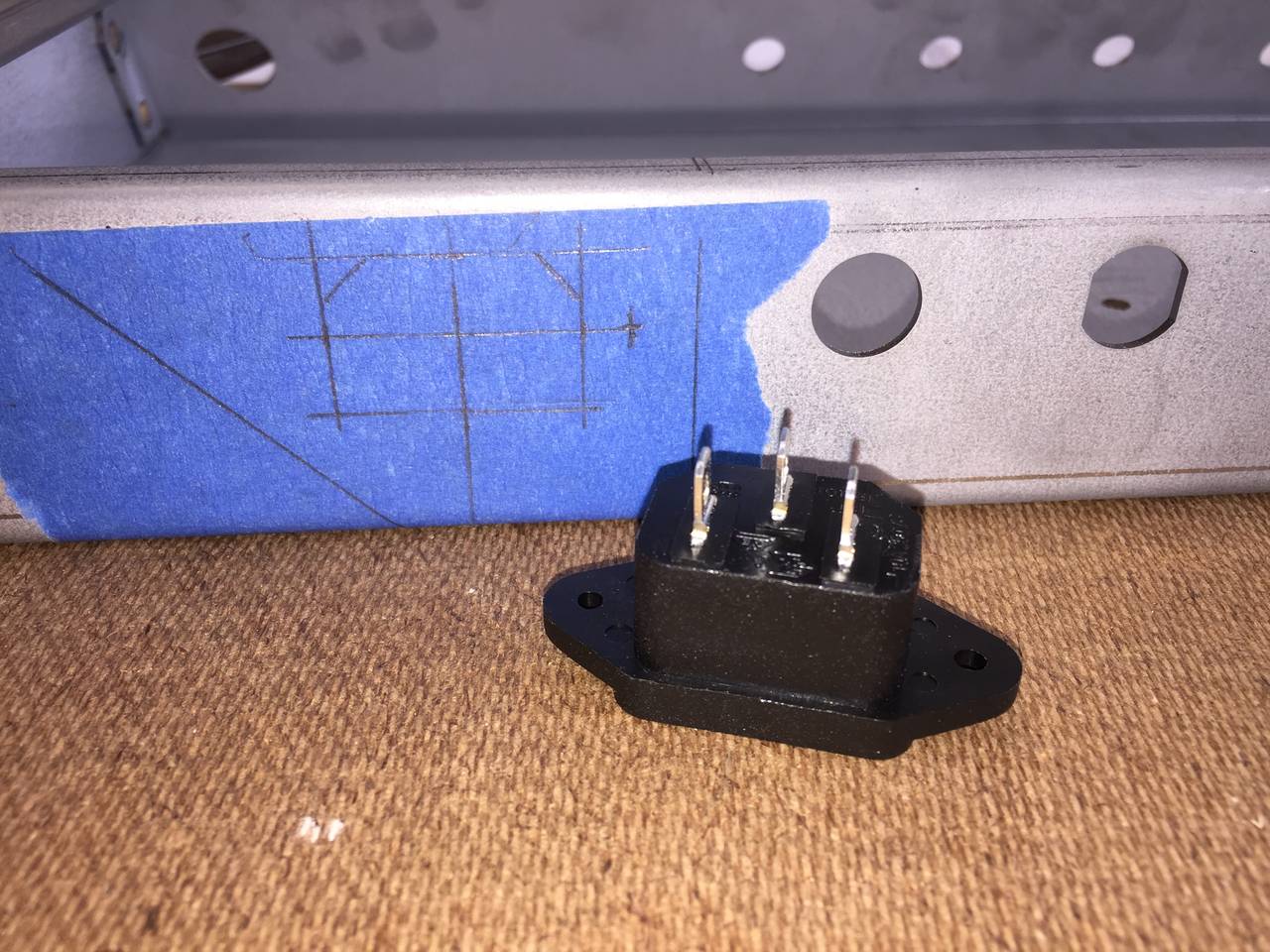

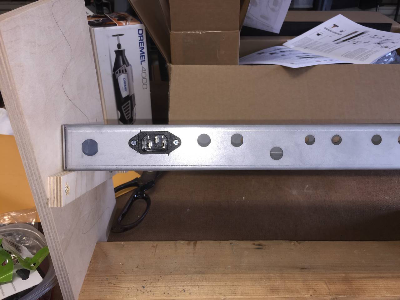

First move was to take care of one of my two mods that I'm doing to the amp. The kit is true to the original '65 Princeton with the attached AC cable, however, I'd prefer the IEC connector. So, it took a little planning and measuring to put it where it's accessible and not in the way of anything else. I used a Dremel tool with a cutoff wheel to make the cuts and then a hacksaw blade in a handle to finish it off.
Drilled the holes and installed it.

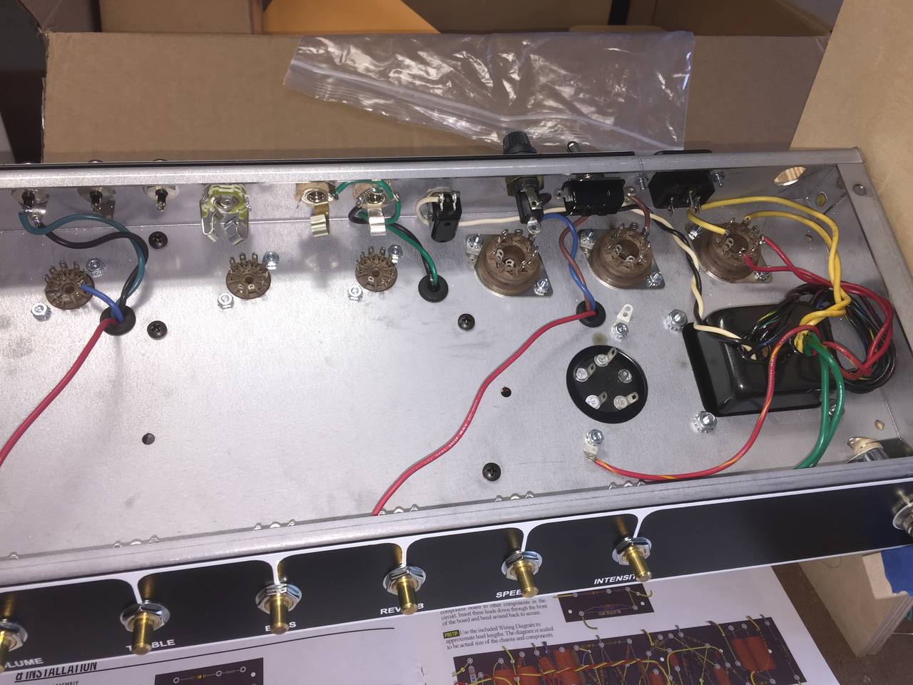

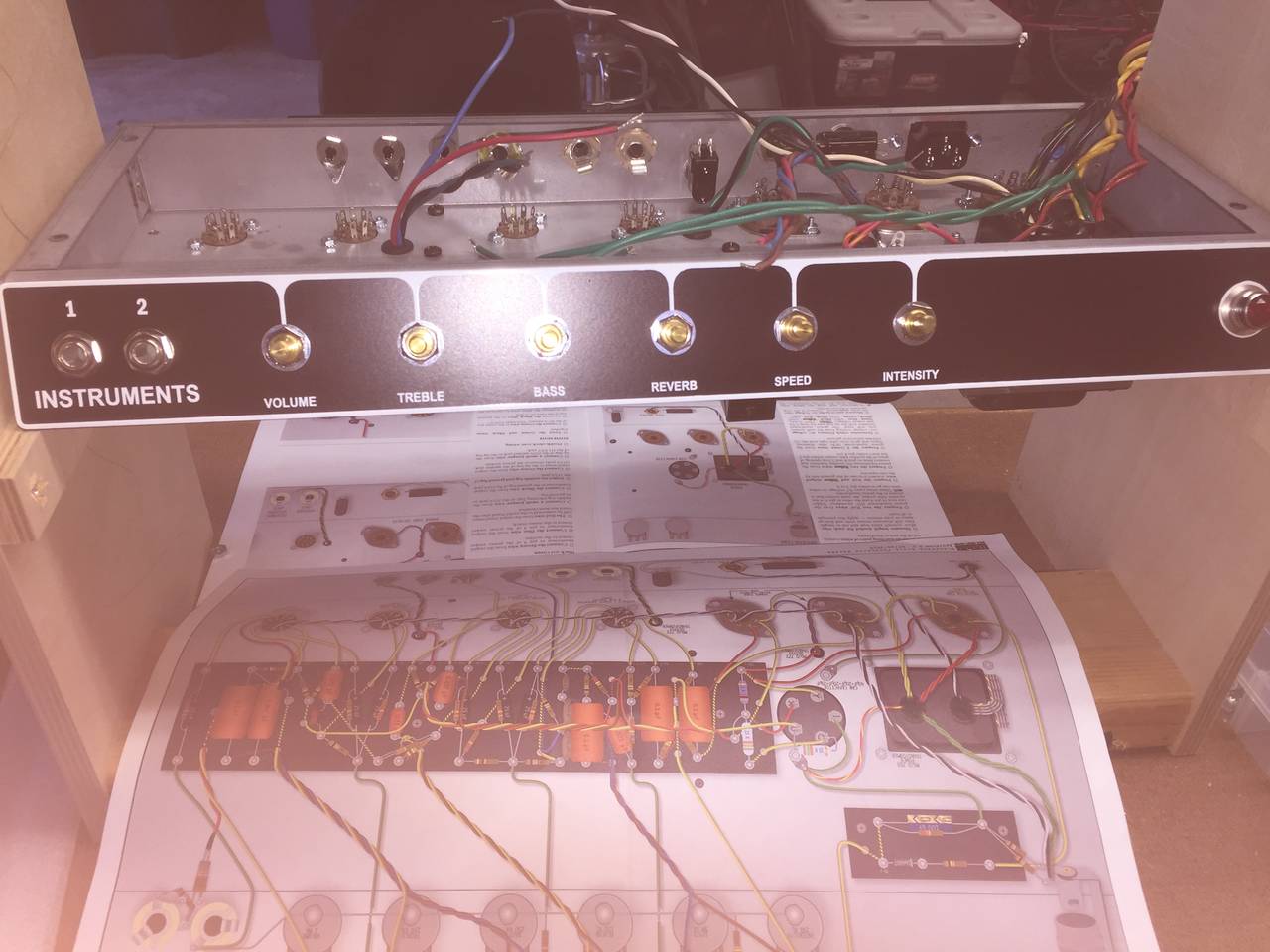

Time to crack the book of instructions and the wiring layout and get to work. By the way, the little jig to hold the chassis at different angles is amazing! Can't imagine how hard this would be without it.
Installed all of the Jacks, Pots, Indicator light on the front panel along with the transformers and the reverb driver. Flipped it around the installed the jacks, switches, fuse holder on the back. My second mod is on this panel - I installed a TRS jack to handle the footswitch for Reverb and Vibrato. The original used two RCA jacks......I didn't like that, thus the mod. And I'll replace the RCAs on the footswitch cable with a single TRS.

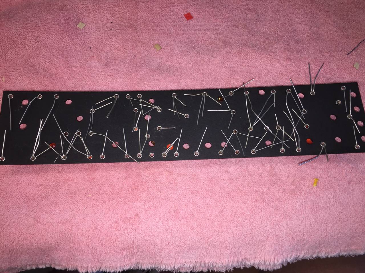

And even with the trays, I missed the slot and ended up putting two of the resistors in the wrong place. Fortunately, I caught it this morning and fixed it. Only mistake so far....that I've caught.....hope there aren't any more.NukePooch wrote: ↑Thu Feb 20, 2020 6:41 pmI don't have to imagine. Picture balancing the chassis on random stacks of blocks which slide and squirm whenever you move anything....Bruce Weldy wrote: ↑Sun Feb 16, 2020 9:00 pm By the way, the little jig to hold the chassis at different angles is amazing! Can't imagine how hard this would be without it.Man, I wish I'd have known about the jig before I did mine...
That's a sweet kit for sure. I think it's worth the money just to get the plastic trays, LOL.
I'll post some pics later tonight or tomorrow. The eyelet board is in and I'm in the process of tying all of those wires back to the chassis - tube sockets, jacks, etc. Easy way to get brain-fried quickly.

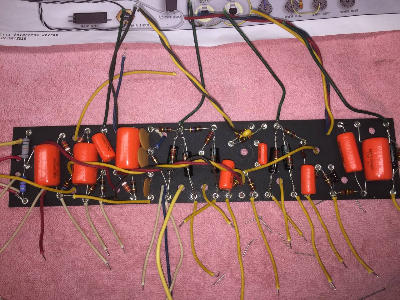

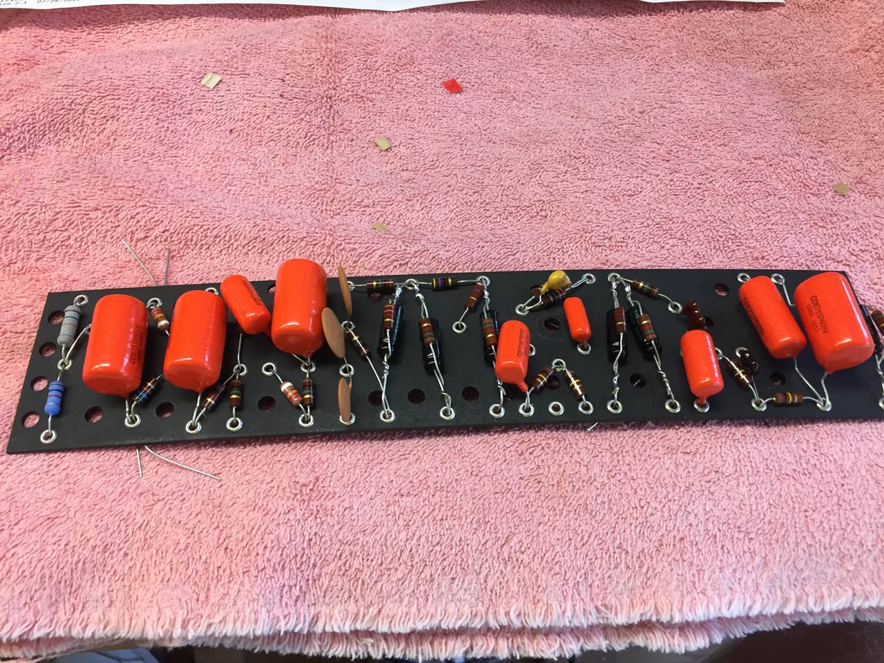

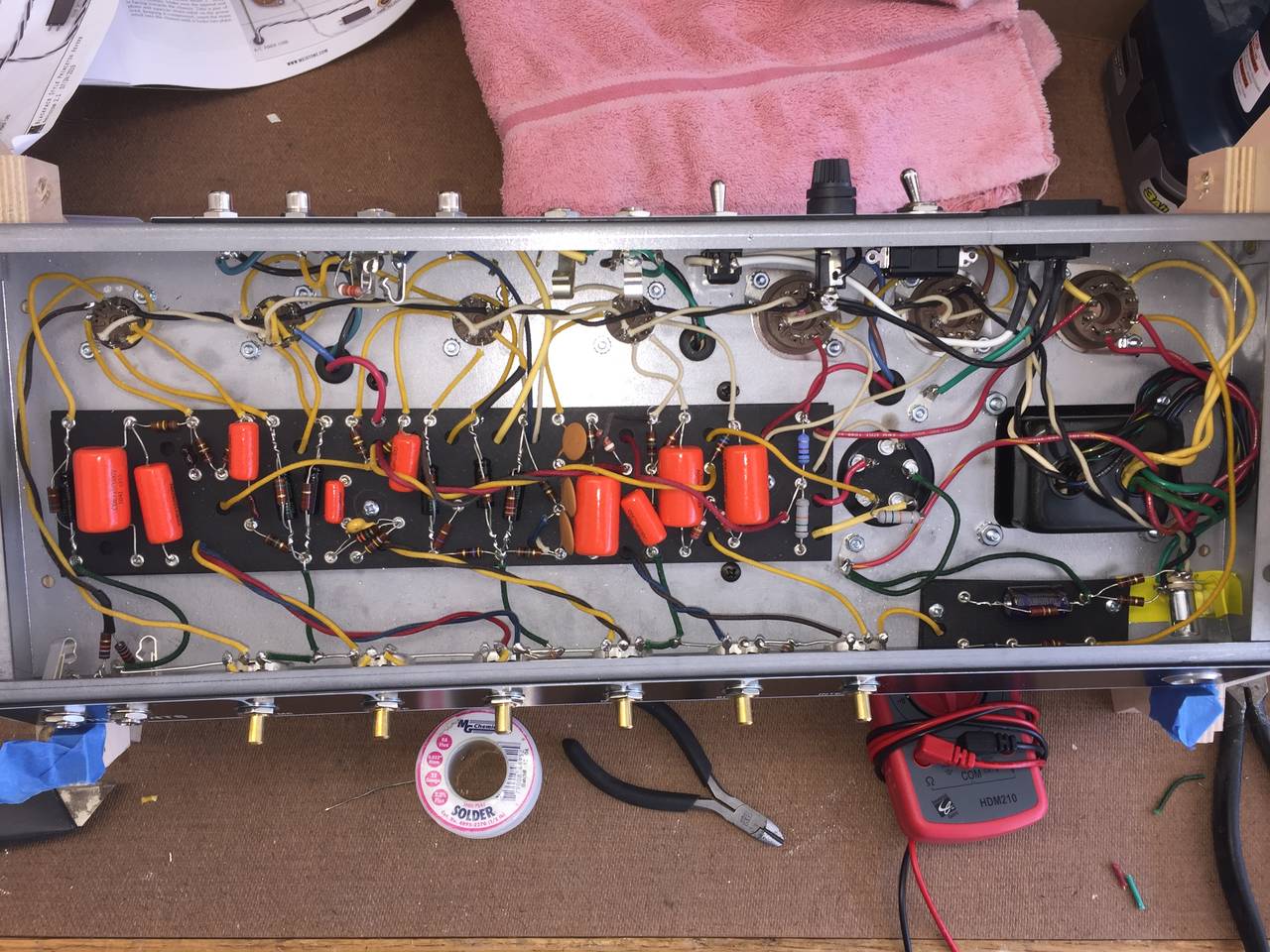

Ok, time to catch up on the build......
Laid out and populated the diode board and the main board....
From the top... From the bottom.... Once all the parts are in place, it's time to start soldering the components and jumper wires to the board.....yes, this takes a while... Now it's time to install the board and wire it up to all of the sockets, jacks, pots, and every other damned thing that seems to be lurking under the hood.....

So, those few pictures took quite a while to complete.....my brain was getting fried every couple of hours. After every thing was complete, i checked and double checked every connection on the board before continuing. I did catch a couple of mistakes while I was building out the board and got them fixed right away.....

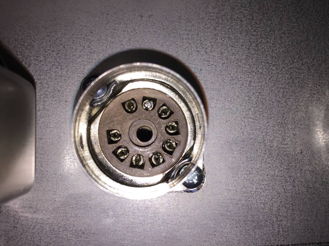

Once everything was in place, it was time to start the initial testing. Fired it up with no tubes - all ok. Installed the rectifier tube - all ok. Next up was the preamp tubes - not ok.
Seems as though some solder flowed through the socket while I was putting the wire on that connection.
My amp-building friend told me I was screwed and would have to put in a new socket....and, oh by the way, "I always put the preamp tubes in while I solder the connections to keep from this happening." Would have been nice if Mojotone would have imparted those words of wisdom.....
Anyway, I wasn't about to wait a week for a replacement, so I set about trying to clear the solder. I had bought a solder sucker just for this build.....mainly because I needed to get a few more bucks in my Parts Express order to hit the free shipping.... Glad I did. It help in a couple of different places and a little bit with this problem. However, the final fix was heating it up and using a very tiny metal pick to push the solder back where it came from. Took a bit, but eventually it was clear enough to accept the tube.
Success!

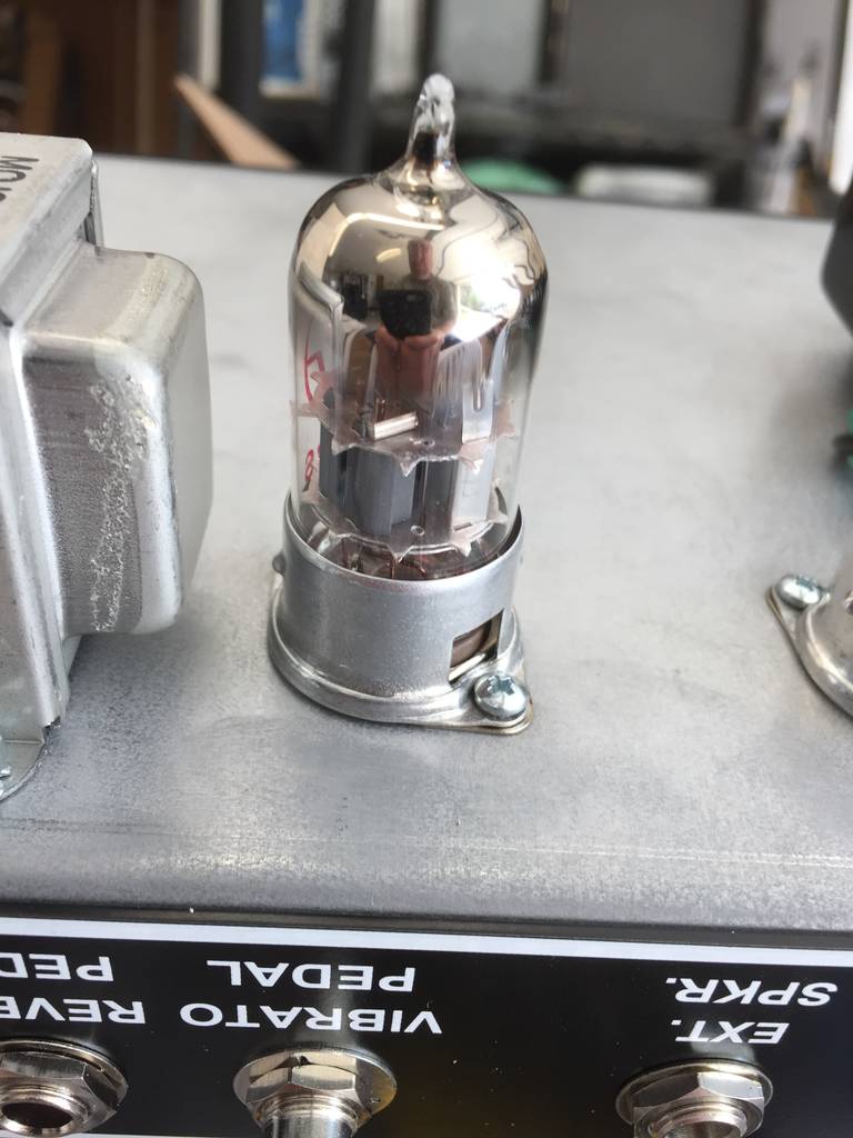

Now, for my second big screwup......When putting in the power tubes, one tube was rotated off by one pin. Inexcusable. But in my defense, the tube sockets came with the hold downs and they are really, really tight making it hard to put in the tube. I thought I had it lined up and pushed it in - I was wrong. I'm surprised that the key on the tube would even allow it to go in wrong, but it did.
So, with the tube situated incorrectly, I hooked up a speaker to give it a load and hit the on switch....about 3 seconds later the speaker made a GUHZZZ sound and that was all she wrote. It blew the fuse.
Obviously, something was wrong - when I looked down on the tube socket from the inside, it was clearly off by one pin. Re-positioned the tube and went in search of a 1A Slo Blo fuse. Guess what - they don't exist in my town on a Saturday afternoon. Tried the big box building stores and the Auto parts stores - no luck.

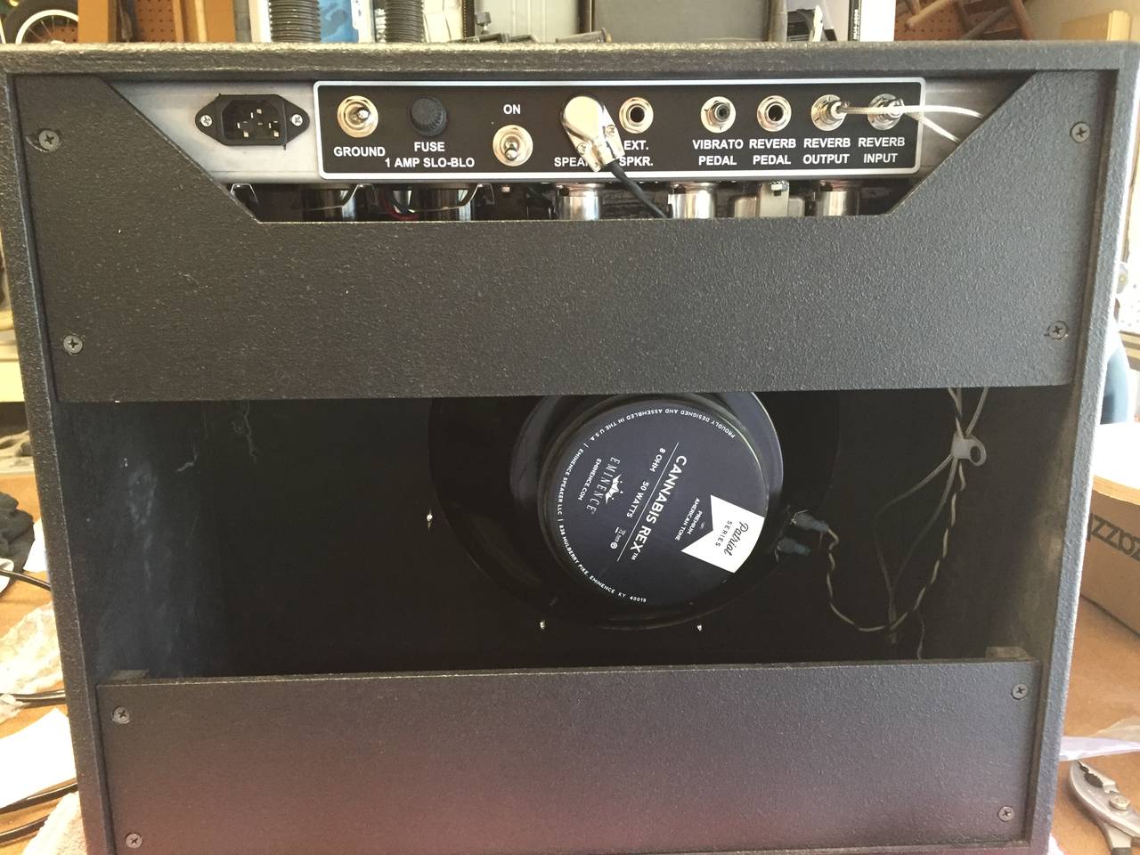

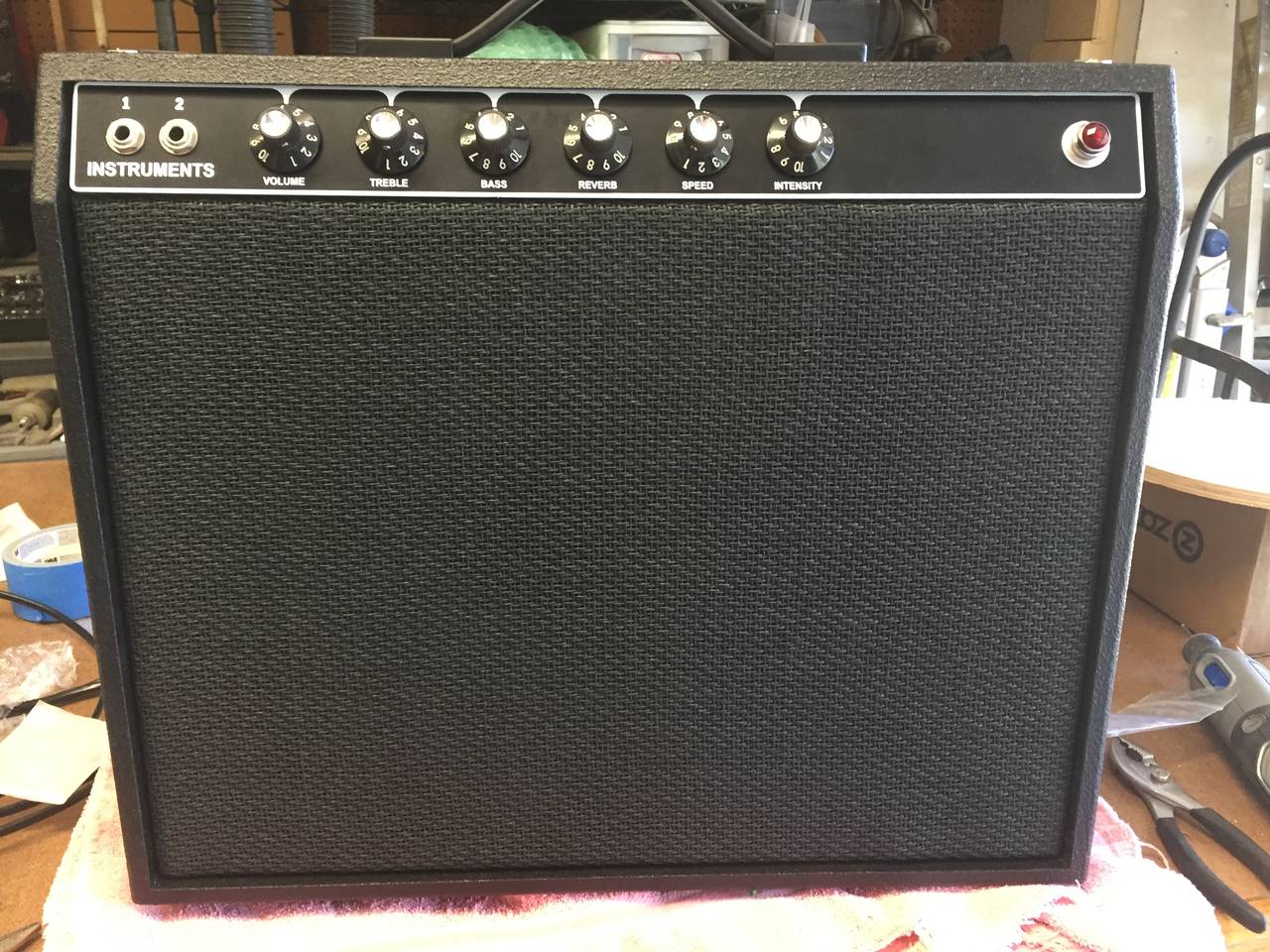

Got to work and finished it up. Everything works. The Vibrato is a little weak, but I'm not that interested in it anyway....reverb, like all Fenders, is way too much if you get past about 3. Otherwise, pretty happy with the build.

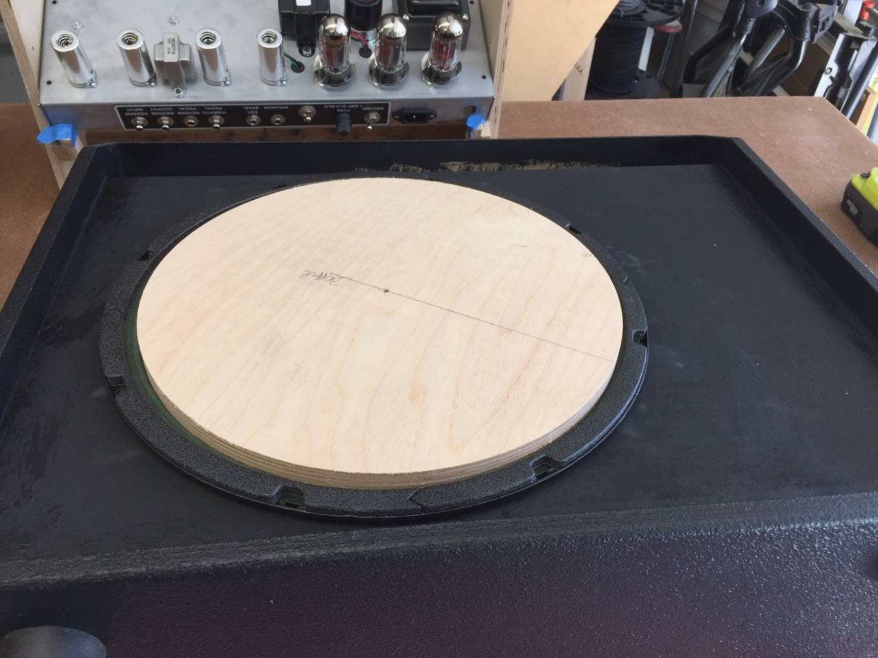

First a little tip when installing a speaker......use the circle cutout to place on the speaker while drilling and putting the screws....a little slip will hit the wood and save your speaker.
On to the final product....

7 is the magic number.......5-6 is pretty clean.Bryan Cox wrote: ↑Wed Feb 26, 2020 8:26 pm Looking good, Bruce! I've read a ton of horror stories about amps blowing up during builds so I think your issues were minimal in comparison. Good job! And I love the cab. I think you pretty much nailed that blackface thing. Now it's just time to let her rip.
But out of curiosity, how far on the dial do you have to get to get breakup?
I took it to my Rock band practice tonight to give it a good burn-in. It sounded really good with my LP. It won't be taking the place of my Boogie in this band, but I'm really looking forward to some country gigs with the Tele now.

Top tip with the circle cutout to protect the driver when installing.

Great looking amp, for sure.
I almost got the Cannibis Rex speaker...I really liked the sound clips I heard of it. I ended up with a GB128...I think it was because I got it on sale. Now I wonder how much different the Rex would be...
It'd be cool if you could somehow get a badge for the upper left of the grille...in Fender script...that says 'Bruce"
