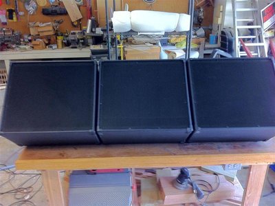

I need a little help. I'm having trouble with the frames to make a pet screen grill. I first tried making the angled cuts on all sides before assembly, but the frames fell apart almost right away. I then tried building the frames with flat stock first and then cutting the angles, also a disaster. Any tips?
- Posts: 8664
Re: WH10 build started
Don't mean to sound harsh, but you should abandon this whole idea. These are not cabs that sit in your living room. They need to be able to stand life on the road....even if it's just a few nights a month.Preston wrote:I need a little help. I'm having trouble with the frames to make a pet screen grill. I first tried making the angled cuts on all sides before assembly, but the frames fell apart almost right away. I then tried building the frames with flat stock first and then cutting the angles, also a disaster. Any tips?

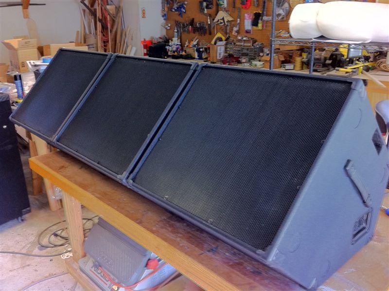

Put grills on them and back 'em with some foam. They will look professional and the be much more rugged.
Here's what that looks like on the WH10s I built a few years ago.

Thank you Bruce. I'll see if I can source some metal grills for them. I was going to use pet screen because that's what I have on my OT12's and it's held up wonderfully with many years of regular gigging.

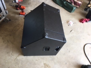

Just a shot of some corners and input jack installed.
