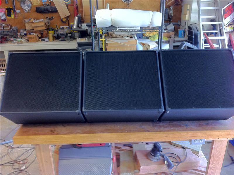

Preston
Posts: 194
Location: Springfield, IL
Re: WH10 build started
#44 Post by Preston »
I built and installed the frames for the metal grills
grill frames.jpg (17.75 KiB) Viewed 1498 times
