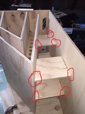

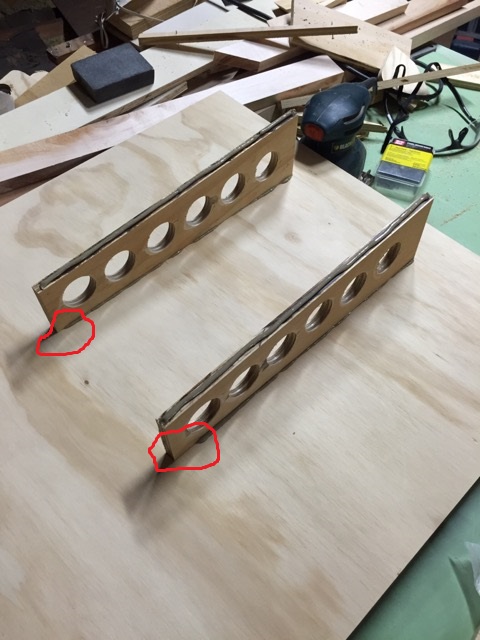

The circled area's will more than likely be rattles

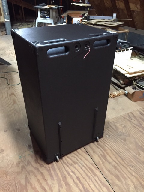

Hmm. Hope not, but we'll see. I still haven't fired the first one up yet, although I'm very close. DuraTex is done, and hardware is mounted. While I'm loving the integrated handles at the top, I decided not to cut them at the bottom, as I've read here from others about needing the vertex of the v-plate to be airtight. So instead I put a strap handle on the underside. Its mounting screws go through the mouth braces.
I also put skid rails on the lower backside.
Hope to be able to wire in the jacks and the driver over the next couple of days, and do the leak test!

Looking sharp indeed. Although it may have been prudent to leak test before applying the finish. Hopefully it tests up all good :fingers:

[quote="djtrumptight"]The circled area's will more than likely be rattles
What are you seeing that indicates rattles are likely in these spots? thanks

himhimself wrote:
djtrumptight wrote:The circled area's will more than likely be rattles
Those braces arent glued all the way to the end.I circled the area's that arent glued.Being near the end of the horn they may not have an effect but with so many unglued area's the chances of rattles increase.
I'm glad you pointed that out, DJTT. I did actually go back and smear some PL out to the ends of those braces. Better safe than sorry, right? 8)
