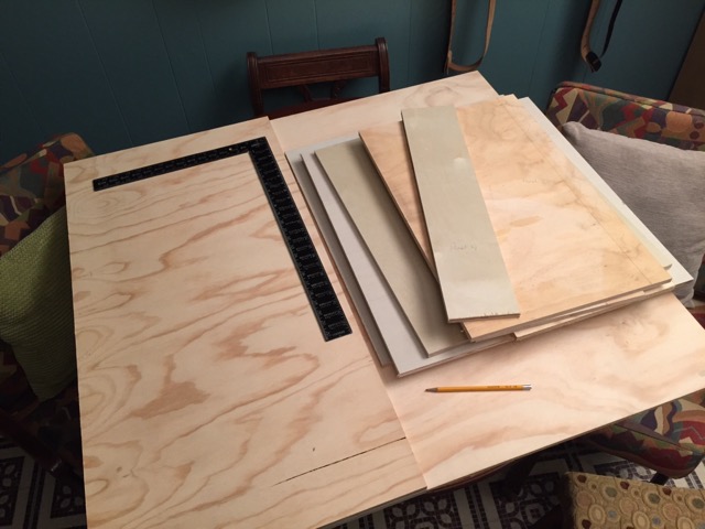

Not much to show, but it is proof that the build is underway - panels cut to rough dimensions! After dinner I'll sharpen my pencil and begin marking the sides. Doubt I'll glue anything up tonight, and tomorrow it's back to the day job. :chainsaw:

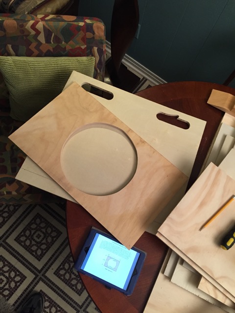

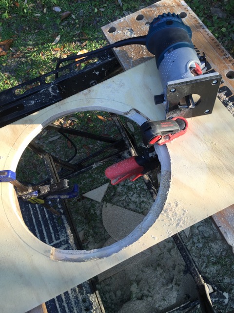

Had a little bit of time on Saturday though. Got the top (panel 1) and the baffle (panel 2) cut out to spec. My router slipped a bit when making one of the hand holds; will have to figure out how to fix that. :chainsaw:
Then, after that amazing amount of progress, last night I re-read the text describing how to do the baffle and the driver anchor, and after consulting SketchUp, realized that I had it all completely wrong. :chainsaw: I didn't realize that the driver is actually inlaid into the baffle, and screwed only to the anchor behind it. So today started with me trying to fix that with my little laminate router.
Tedious and time-consuming, but it worked.

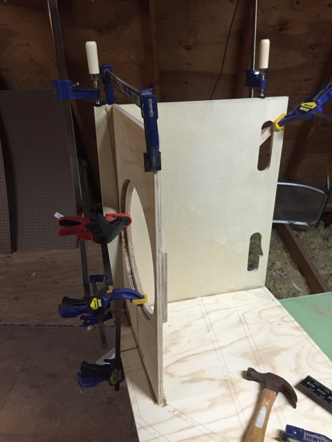

Dry fit everything and checked for square, pretty good so far, but we're just getting started.... Then made a mess with PL. :evil:
That's all for this weekend, and next week promises to be hellaciously busy at the day job again.....

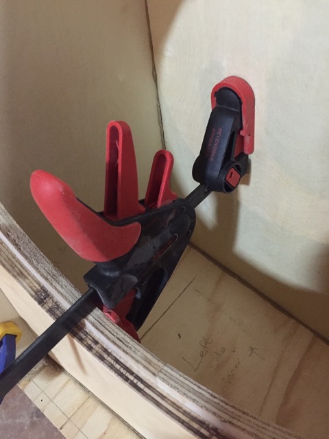

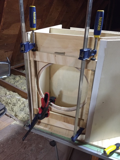

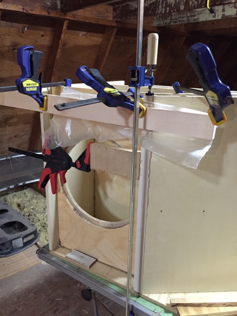

Panels 3 and 4 fitted this evening! Numerous little scrap jigs and clamps used to hold the panels while the PL sets. I actually added a couple more after this shot was taken:
I love this little spreader clamp!
Yup, they are handy, aren't they?

ctmullins wrote:Panels 3 and 4 fitted this evening! Numerous little scrap jigs and clamps used to hold the panels while the PL sets. I actually added a couple more after this shot was taken:
That looks about the same number of scrap jigs as when I built my subs. I see insulation, are you in an attic :shock: ? You are only supposed to build your tops in the attic, subs are supposed to be built in the basement :wink: !

CoronaOperator wrote: That looks about the same number of scrap jigs as when I built my subs. I see insulation, are you in an attic :shock: ? You are only supposed to build your tops in the attic, subs are supposed to be built in the basement :wink: !
Ha ha! Yep, our house has a barn roof, so the attic is massive! It's currently unfinished, but I have a drill press, a small table saw, and a drafting table/workbench up there, as well as good lighting that I installed, so it works well. Of course, it's only usable during half the year, as our brutal six-month summers here mean 120+ temps up there. No basements in the Gulf South, they'd just be full of swamp water anyway.
I'm building 24" T39s, so they should fit through the door after they're built. :fingers:

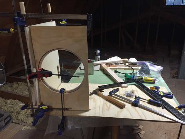

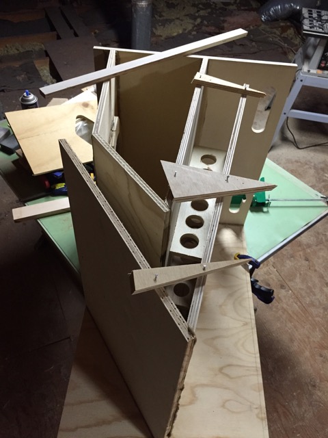

Panels 5 and 6, and their associated braces, fitted today! I swiss-cheesed the braces, not that it helps much, but the drill press was sitting right there...
I must not have understood the plans regarding panel 6. The measured length shows as 17 3/8", but the required length, when I went to test-fit, was 16 3/4". :confused: :confused: :confused: I double-checked Sketchup, cut it down to 16 3/4", and glued it in.
The panel 6 extension is not glued in yet, although it appears in the photo, astride the driver chamber...
How many more cabs will I need to build before I don't make a complete mess with the PL? :wall: :lol:

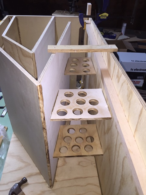

Baby steps...
Here's the collection of clamps and guideboards necessary to keep the panel 6 extension in place while the PL sets. I had hoped to do the flanges as well, but there's no way to do that until the panel 6 extension is fully glued in...
My fabulous spreader clamp makes another appearance! :hyper:

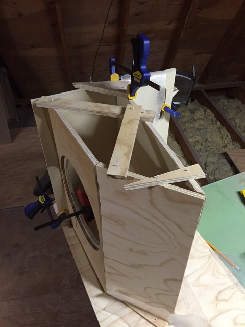

Slowly getting the "fiddly bits" (access panel flanges and associated tiny little braces) done...
-todd
