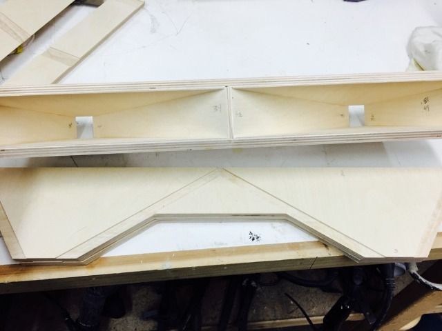

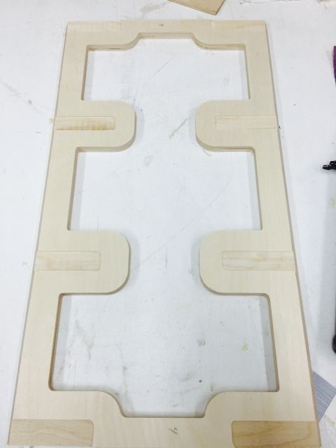

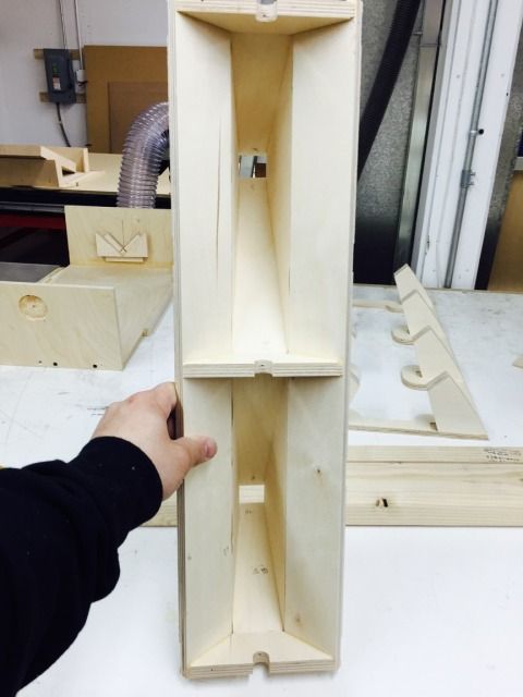

So reworking the CNC software to allow for dados has proven to be a good decision.. I can now assemble perfect compression driver modules in about 10 minutes! If you have done these before you know what I'm talking about, these little parts move all around slipping on the glue while you are trying to fasten them. More importantly no tape measure needed..
Re: At it again!! Night club number 2 sporting a BFM rig!
That's astounding, both time wise and result wisehifibob wrote:So reworking the CNC software to allow for dados has proven to be a good decision.. I can now assemble perfect compression driver modules in about 10 minutes!

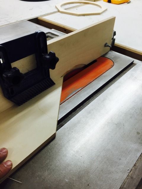

So do you have a bit changer or are cutting the angles by hand? I gotta tell you this is killing me.

No Leland I cut with straight up or down cut bits only.. The cnc parts are cut to exact size then I just run the part against a sacrificial fence with the blade buried into it at the appropriate angle. That way I still keep the edge the cnc has already cut and dont have to do any measurements..LelandCrooks wrote:So do you have a bit changer or are cutting the angles by hand? I gotta tell you this is killing me.
You can see in this pic how I put the cnc cut edge against the sacrificial fence and the blade on applies the angle to the edge without changing the actual dimensions of the part..The larger pieces I do on my slider for ease..
