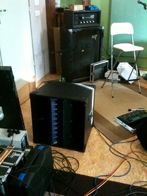

so only 9 rows of 2 piezzos instead of ten in my arrays.
DR 250 in France...
Re: DR 250 in France...
you're right...but in fact i've made a mistake cutting the piezzos...i cut them too wide, not really too wide but just 1,5 mm too wide
and i glued them without verifying the total size

some little news without any pics...so i've soldered all the filters, put'em in place, put the 2510 in front of the throat fillers, screwed them, connected evreything including the array modules, screwed them...
and tomorrow for the first day of 2015 i'll make the speakon connections and i will fire them to live for the first time !

and no f****** sound out of the boxes...
well i think it's a cable problem in fact. i wired my speakon connectors for the passthrough function (1+/1- for the subs and 2+/2- for the DR), and i think that my LA24 poweramp is wired with the 1+/1- version...
i'll check that tomorrow

Yes that's done !!!!!
just a little manipulation in my neutriks connectors and they live !!!!
My god, it's just amazing.
what could i say: sharp, the sound is sharp...maybe a little bit aggressive over 5k but with a good sound analysis and the help of my equalizer, everything will run
i'm also quite impressed by the fact that the bottom is also quite decent...very punchy !
next stage for me will be 2 jack 12 and two T30 !

Good job. Good for you for not giving up, and being able to figure things out.

ok so this evening i've tried them on footstands, made just a little real time analysis with Smaart, used the full parametric system of my 24.4 to equalize the sound in my room...not very difficult.
i've launched itunes, looked for a masterpiece...Lisa Hannigan "ocean and a rock" (yes, to my ears it's the perfect masterpiece to test a FOH) ....BAAAAAMMMMMMM
my god, incredible !
a true dream ! i was about to cry (seriously no joke)...pure sound, pure emotion..."les poils dressés" as we're saying here
tomorrow i'll try with a 31 bands eq to have something perfect.
