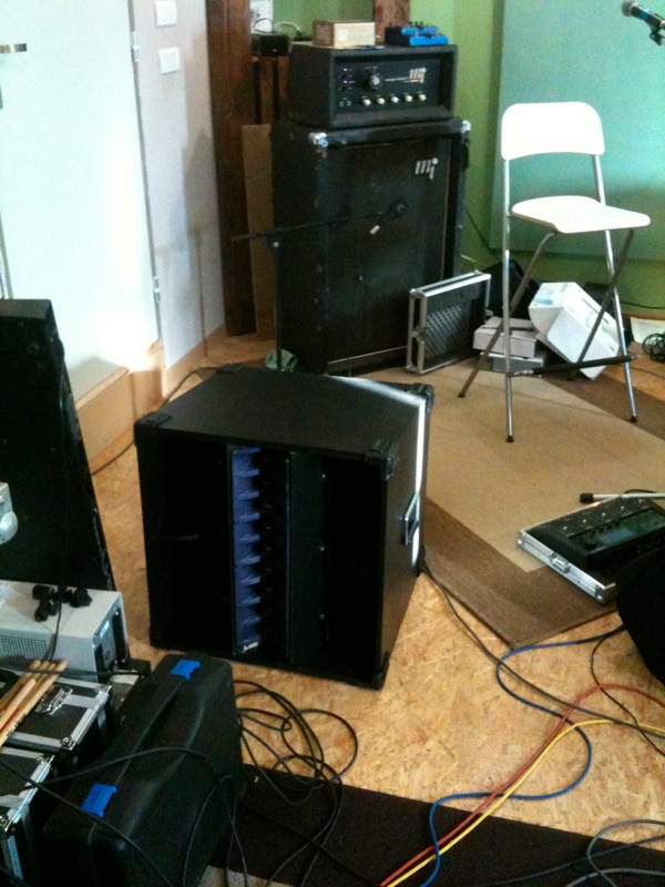

i'm also quite impressed by the fact that the bottom is also quite decent...very punchy !
next stage for me will be 2 jack 12 and two T30 !
ok it's an original support for a DR...but it's a mess in my studio !!! i need to clean all this stuff
on the floor, the bass spectrum is really present
