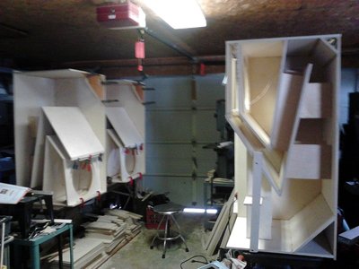

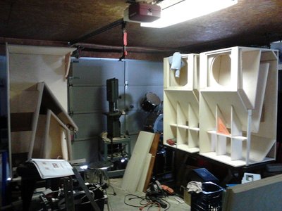

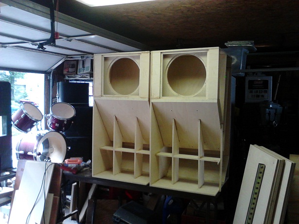

This evening's progress includes:
panel 10 (bottom), panel 11, the rest of the driver flange and prepping panel(s) 7.
I want to mention that I severely dislike the camera on my cheap cell. It has fisheye that always makes my cabinetwork look out of square. Honest, I double-checked, it's spot on....
Panel(s)7 are laying inside the driver chamber. Don't panic, I did not add any extra bracing.

NICE! Looking great. This last pic you posted was exactly the step I was dreading in regards to using the new plans...it scared me off. Yours is looking spot-on. Glad you commented about the braces in the driver chamber. I was about to say "Um...WTH?" :loler: BTW, i'm digging your bent metal handle on the alignment jig. Very snazzy. Wait...or is that one of those hand drills?
Posts: 2068
Re: yet another T48 and OT12 build thread.....
#33 Post by Radian »
miked wrote:BTW, i'm digging your bent metal handle on the alignment jig. Very snazzy. Wait...or is that one of those hand drills?
That's a speed handle. Great for screws in the absence of a powered driver.
He is strong with the way of the wrench. :ugeek:

Dude! That's my cordless rechargable screwdriver! It runs on Mountain Dew....

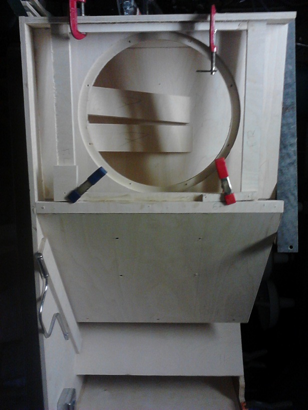

Regarding the front-loading flange: It had me concerned at first, but then I decided that if the instructions were worth their salt, I would trust them.
Cheers Bill. You didn't let me down!

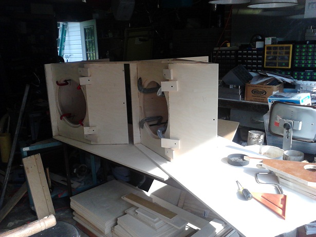

Trying to keep my pace up, without compromising.
First two cabinets nearly done, need some cure time, sides put on, driver and access cover.
Next two cabinets started going together today. Panels 1 through 4 done. I'm going to let the PL tighten up overnight and then carry on tomeorrow afternoon.

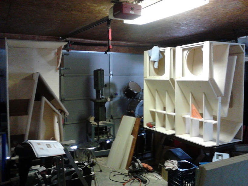

draehn wrote:Trying to keep my pace up, without compromising.
I guess while I wait, I might as well start making up the baffles for my OT12s.....
You started after me and you'll finish before me. How'd you do that, man? LOL! They are looking GREAT, draehn!! I see you're putting the 6/10 braces in before putting the second side on. I am thinking about doing that as well. Then, I could paint the whole mouth assembly, including the braces, before slapping the 2nd side on. And there'd be nothing to tape off, either. Hmm.
The OTop baffles are a huge PITA. If you are making more than 2 tops, I'd suggest making that first baffle perfect and using it as a routing template to do the rest. Keep up the great work, buddy!

Here's the OT12 baffles. I guess I haven't lost my touch with Mr. Jigsaw. I may still cut out the plugs tonight.

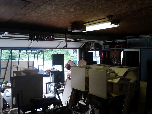

Still making progress. Just a little slower. The second pair of cabinets has almost caught up with the first pair:
