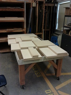

After long deliberation and many changes of heart along the way, I finally decided to build some speakers. I found out how difficult it is find BB at a decent price in my area, but my searching was rewarded by finding a good company that would not only sell me BB/BB at $36, but would also deliver it for an additional $18 provided my order was in excess of $350..... No problem, says I, because 15 sheets comes out to a lot more than $350.....
My gracious employer also permitted me to use their 14" table saw for a couple hours Thursday afternoon to break down my panels. I figure that 2 hours with the saw saves me a week at home...
So I had the wood shipped to my work, which is 2 hours away from home, cut it up and graciously gave the borrowed shop a cleaning that left it nicer than when I arrived.
My focus is on the T48s at this time so that's where I'll do most of the work. I have the kits from SpeakerParts including 3015LFs so this should be at least enjoyable!

NICE! 14" table saw, eh? I'll bet it was one of the fancy sliding table ones. I'm jealous. Something with that kind of horsepower laughs at 1/2" BB. Can't tell in the pics if there are angles on the panels, but I'm assuming not. How do you plan to cut the required angles (and compound miters for the OTops)? Good luck and remember to ask questions any time. Better to ask and wait a day for a correct answer than to screw up expensive BB.
I'm about 80% with my T48s, but my OTops are done. Check my OTop build thread (in sig). It might be helpful for you.
