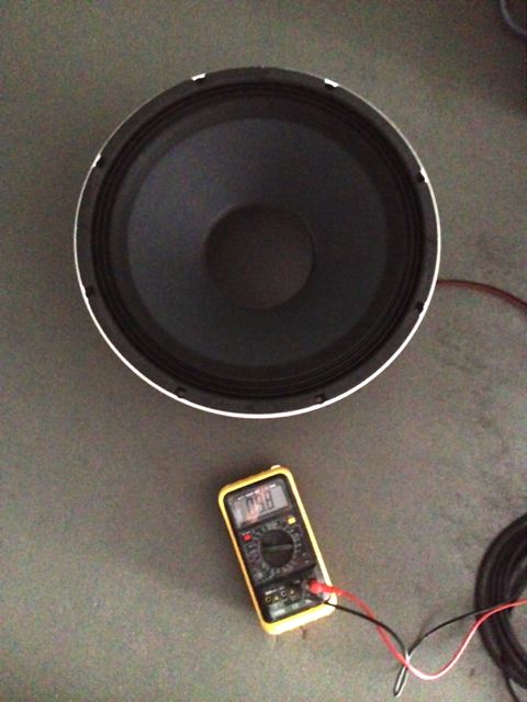

I hesitated a while about breaking in drivers, but after reading Bill's post about it, I'm finally breaking in my woofer. I guess the tweeter doesn't need this. Should I break in the Mid Range driver too? If so, should I use 30kHz/10V or is that different for mid range drivers

Rickyvt wrote:Should I break in the Mid Range driver too? If so, should I use 30kHz/10V or is that different for mid range drivers
NO. :-) Something in the driver's pass-band. Give them a comfortable voltage. Start low and turn up... let the cones move a bit, but ease off well before they start bottoming out. It's not an exact science. Any is better than none, but even none will work itself out with a little use.

I skipped breaking in the midrange driver 30kHz is OK, but 550kHz is driving me nuts. :fruit:

Rickyvt wrote:I skipped breaking in the midrange driver 30kHz is OK, but 550kHz is driving me nuts.
Unless you are a dog, you shouldn't have any problem with 30khz.....but it's also not going to do a very good job of breaking in your driver. :fruit:
