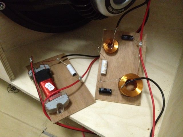

Today I did the low pass and mid range band pass, could not resist to play some bass at low level
The crossovers seem to be OK...
Still need to do the braces and insulation, high pass filter and access panel.

You should have one of the coils standing up to avoid cross-talkRickyvt wrote:I skipped breaking in the midrange driver 30kHz is OK, but 550kHz is driving me nuts.![]()
Today I did the low pass and mid range band pass, could not resist to play some bass at low levelThe crossovers seem to be OK...
If you're interested in knowing why:
http://www.audioholics.com/education/lo ... alk-basics

Thanks for the info, nice to know someone with knowledge and experience is looking over my shoulderMichael Ewald Hansen wrote:

Crosstalk can be a problem when the LP/BP/HP filters are on the same board. When mounted on separate boards the coils are too far apart for it to be a concern.Michael Ewald Hansen wrote: You should have one of the coils standing up to avoid cross-talk![]()
