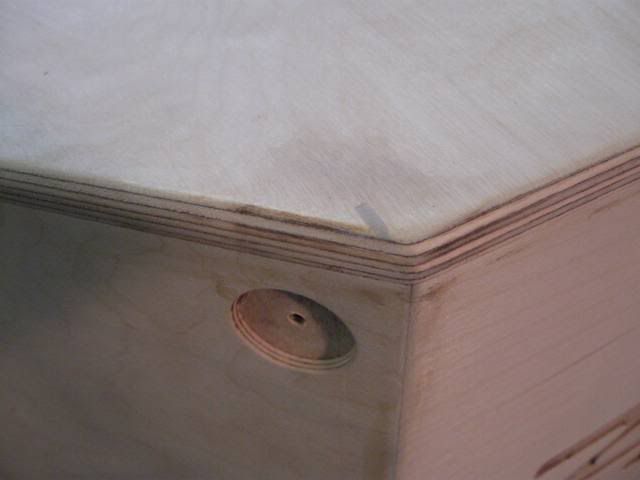

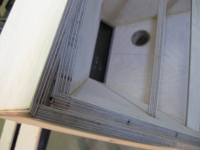

All pilot holes for the different accessories done. Here the ones for the grill:

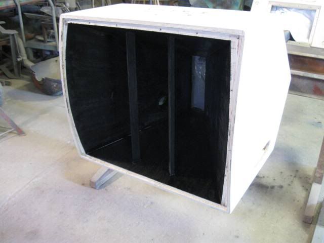

Bondo repair on all defects and final sanding of the cab's exterior:

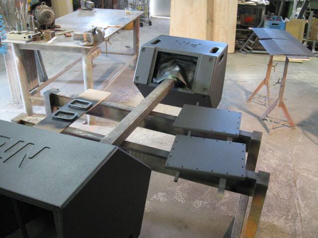

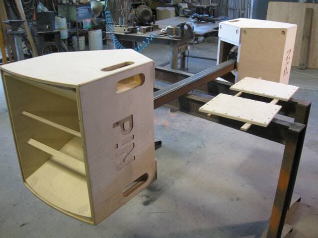

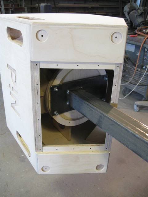

Cabs mounted on a square beam for painting. The cabs are positioned symmetrically so rotating the beam is easily done with one hand at 90 deg. increments:
The beam attaches to the cab at the speaker baffle.
The horn is painted with basic black paint. This isn't going to be seen through the foam backed grill:

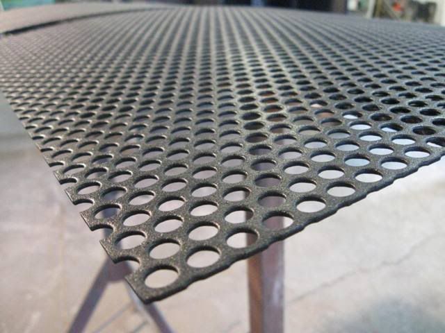

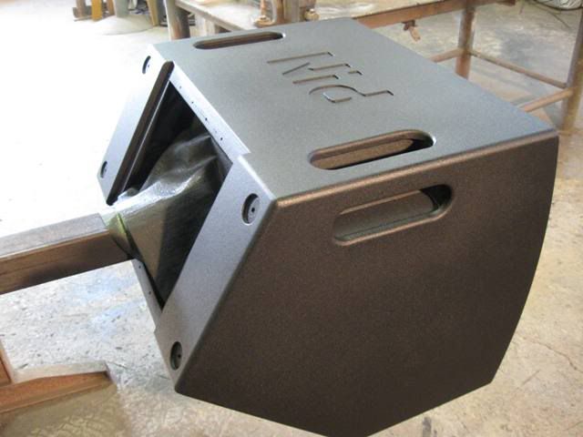

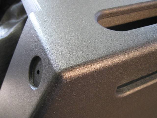

Textured polyurethane paint is applied to the outer shells, access covers and grills:
Close-up of the grills:
Close-up of the cab:
Closer – up:

N.Webber wrote: Textured polyurethane paint is applied to the outer shells, access covers and grills:
Is there any particular brand here in the states that makes textured polyurethane paint?
