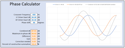

#212 Post by Seth »
Mid to woofer needs 0.63ms delay between them. Not sure which.
Mid to tweeter needs 0.08ms delay between them. Not sure which.
Might take a little juggling to figure out which driver needs no delay and which needs the most. If the mid is not the baseline that doesn't need any delay, the one that needs the most is actually going to need both of those figures combined, 0.71ms.
It's confusing. We'll work it out when you get there.

Less than 2ms is inaudible.

#214 Post by Seth »
Bill, I'm a little confused... 180º out of phase at 2.5kHz is 0.2ms. 1.25ms at 400Hz, also 180º out. Both less than 2ms and both dead cancellations at their respective frequencies. Inaudible?
Posts: 3182
#215 Post by Seth »
... At about -2dB from 100% summation, I could certainly see anything less than 2ms at a subwoofer crossover point being inaudible.
Posts: 29152
#216 Post by Bill Fitzmaurice »
Seth wrote: Sun Feb 19, 2023 9:28 am Bill, I'm a little confused... 180º out of phase at 2.5kHz is 0.2ms. 1.25ms at 400Hz, also 180º out. Both less than 2ms and both dead cancellations at their respective frequencies. Inaudible?
Audible if you have two sources playing the same frequency at 180 degrees apart, which doesn't happen thanks to the crossover. What's of concern with time align is the perceptible arrival time difference of the two sources. At 500-800Hz, where we're most sensitive to it, the minimum detection threshold for the average person is 2 to 3ms.
Posts: 3182
#217 Post by Seth »
Ah. I'm talking phase alignment, you're talking time alignment. Understood.
