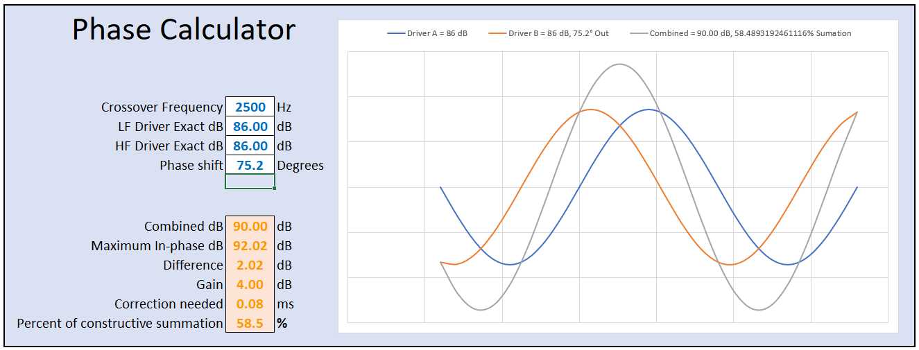

Mid to woofer needs 0.63ms delay between them. Not sure which.
Mid to tweeter needs 0.08ms delay between them. Not sure which.
Might take a little juggling to figure out which driver needs no delay and which needs the most. If the mid is not the baseline that doesn't need any delay, the one that needs the most is actually going to need both of those figures combined, 0.71ms.

Bill, I'm a little confused... 180º out of phase at 2.5kHz is 0.2ms. 1.25ms at 400Hz, also 180º out. Both less than 2ms and both dead cancellations at their respective frequencies. Inaudible?
... At about -2dB from 100% summation, I could certainly see anything less than 2ms at a subwoofer crossover point being inaudible.
- Posts: 29042
Audible if you have two sources playing the same frequency at 180 degrees apart, which doesn't happen thanks to the crossover. What's of concern with time align is the perceptible arrival time difference of the two sources. At 500-800Hz, where we're most sensitive to it, the minimum detection threshold for the average person is 2 to 3ms.
Ah. I'm talking phase alignment, you're talking time alignment. Understood.
- Posts: 29042
They are related. There's a specific procedure to time align the HF horn atop an Altec A7 with the woofer horn. The HF horn polarity is reversed, placing the drivers 180 degrees apart. A 500 or 800Hz tone is played through the system, depending on the crossover. The horn sled is moved forward and backward until a sound meter shows minimum output, indicating perfect time align. The HF horn polarity is then returned to normal.
