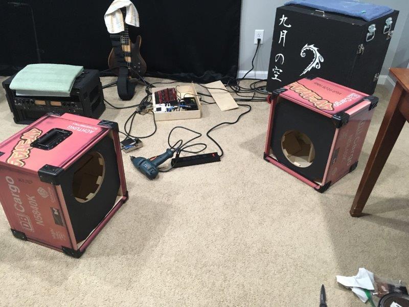

Glued the Speakon jacks to the jack plates with hot glue and also screwed them into place. Put some thin foam insulation along the flanges of the jack plates to help get them completely sealed.
I applied two coats of black paint to the baffles while the cabinets were in the basement and have the cabinets sitting upstairs now in the family room where I have some sun occasionally peeking through the clouds to help the paint dry. Tomorrow afternoon I will reinstall the speakers and do some playing.
This coming week I will make a decision on whether to go with a clothe grill or with a metal grill. Getting closer to having this build wrapped up. Again, I just wanted to express how amazed and grateful I am with the process and the results.
Das Jugghead
- Posts: 142
- Location: Indianapolis
Re: Simplexx 110 Build
Paint on the baffles is dry and I painted the ports black as well. I reinstalled the speaker jack plates, the speakers, and hooked everything up to play. I detected no air leaks around the flanges of the speaker jack plates nor the Speakon connectors. Rack positioned up top is not ideal.

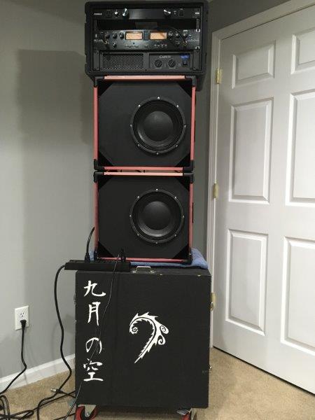

On another tack I am toying around with the idea of building (out of wood or metal) some type of folding stand to set the speakers on with a shelf below for the rack. Nothing concrete as of yet but thought it might be nice to have something easier to transport. Around here there is actually an advantage to bulkier gear as thieves are less inclined to steal something they have to work for. The bottom case in the pictures was originally built to house two bass amps (Acoustic and Hartke), a pedal board, a wireless, cords, cables, etc. .. It weighed in well over 200 lbs but I never had anything stolen. These days, as I age sans grace, I find lighter and less cumbersome to be an attractive way to go.
Das Jugghead
- Posts: 142
Another update for the gentle reader.
Today we had rehearsal after several weeks off. I had the speaker cabinets up on top of an old road case which placed them about 30" above the floor. Drummer commented that he could hear me "very well" and the lead guitarist asked me to turn down TWICE. Bass sound, to put it mildly, was simply excellent. First time in years where I did not strain to hear myself and could hear myself everywhere in our rehearsal space. I was only running at about half power. Always nice to cruise along like that knowing you have all that power in reserve if you need it and especially nice being able to cut through two very loud guitarists and a drummer.

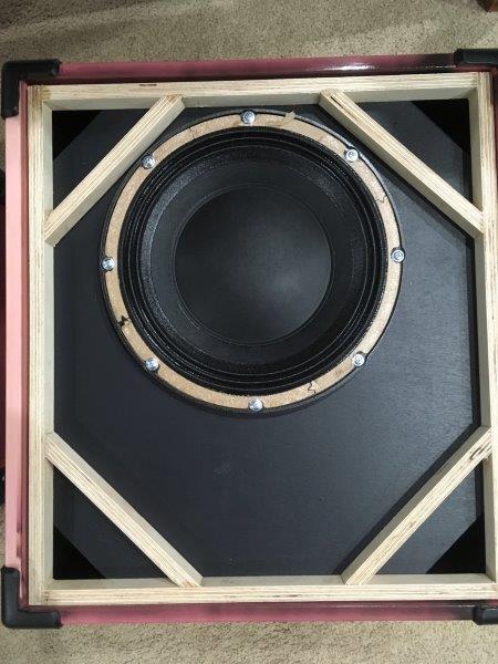

Hey Bill another question as I try to get this build wrapped up and make plans for the next build. I am building the frames to hold the speaker grill clothe and when I did a test fit it really looks like they block too much of the port openings. I have included a picture. Can you please advise?
Many thanks in advance.
- Posts: 29050
I'd say that's borderline. My preference is to leave them unblocked.
