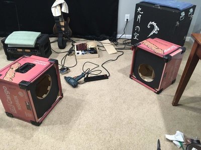

I applied two coats of black paint to the baffles while the cabinets were in the basement and have the cabinets sitting upstairs now in the family room where I have some sun occasionally peeking through the clouds to help the paint dry. Tomorrow afternoon I will reinstall the speakers and do some playing.

Paint on the baffles is dry and I painted the ports black as well. I reinstalled the speaker jack plates, the speakers, and hooked everything up to play. I detected no air leaks around the flanges of the speaker jack plates nor the Speakon connectors. Rack positioned up top is not ideal.

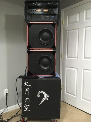

After that I am strongly considering building my own custom rack system to house my rack stuff, cords, pedal board, and associated gear sundries that I can set the speakers on and get them up off the floor.

I did that once for a guitar rig. Had a couple of drawers to hold everything and the cab sat on top. The problem I found is the the box acted like a passive radiator and make a mess of some low notes. Make sure and leave some spaces around the sides so that it can't vibrate.Das Jugghead wrote: ↑Mon Apr 02, 2018 5:46 pm

I had wondered about that. Can you describe in a little more detail the "leaving some space around the sides" comment?Bruce Weldy wrote: ↑Mon Apr 02, 2018 7:33 pmI did that once for a guitar rig. Had a couple of drawers to hold everything and the cab sat on top. The problem I found is the the box acted like a passive radiator and make a mess of some low notes. Make sure and leave some spaces around the sides so that it can't vibrate.Das Jugghead wrote: ↑Mon Apr 02, 2018 5:46 pm

Leave the back and the sides open - the more air that can escape, the better. On the other hand, you might like the extra bottom end.Das Jugghead wrote: ↑Mon Apr 02, 2018 8:17 pmI had wondered about that. Can you describe in a little more detail the "leaving some space aroundBruce Weldy wrote: ↑Mon Apr 02, 2018 7:33 pmI did that once for a guitar rig. Had a couple of drawers to hold everything and the cab sat on top. The problem I found is the the box acted like a passive radiator and make a mess of some low notes. Make sure and leave some spaces around the sides so that it can't vibrate.Das Jugghead wrote: ↑Mon Apr 02, 2018 5:46 pm

So is what you are describing like a box within a box? Somewhat like a shock rack? I am thinking of putting some anti-vibration foam on the top of the proposed cabinet for the speaker to sit on to try and cut down on the amount of vibrations transferred down into the rack - pretty sure all my gear does not need the shaking.Bruce Weldy wrote: ↑Mon Apr 02, 2018 11:31 pmLeave the back and the sides open - the more air that can escape, the better. On the other hand, you might like the extra bottom end.Das Jugghead wrote: ↑Mon Apr 02, 2018 8:17 pmI had wondered about that. Can you describe in a little more detail the "leaving some space aroundBruce Weldy wrote: ↑Mon Apr 02, 2018 7:33 pm
the sides" comment?![]()
On another tack I am toying around with the idea of building (out of wood or metal) some type of folding stand to set the speakers on with a shelf below for the rack. Nothing concrete as of yet but thought it might be nice to have something easier to transport. Around here there is actually an advantage to bulkier gear as thieves are less inclined to steal something they have to work for. The bottom case in the pictures was originally built to house two bass amps (Acoustic and Hartke), a pedal board, a wireless, cords, cables, etc. .. It weighed in well over 200 lbs but I never had anything stolen. These days, as I age sans grace, I find lighter and less cumbersome to be an attractive way to go.

Today we had rehearsal after several weeks off. I had the speaker cabinets up on top of an old road case which placed them about 30" above the floor. Drummer commented that he could hear me "very well" and the lead guitarist asked me to turn down TWICE. Bass sound, to put it mildly, was simply excellent. First time in years where I did not strain to hear myself and could hear myself everywhere in our rehearsal space. I was only running at about half power. Always nice to cruise along like that knowing you have all that power in reserve if you need it and especially nice being able to cut through two very loud guitarists and a drummer.

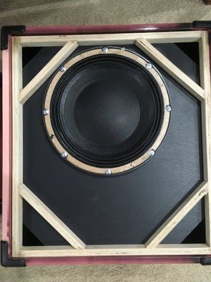

Hey Bill another question as I try to get this build wrapped up and make plans for the next build. I am building the frames to hold the speaker grill clothe and when I did a test fit it really looks like they block too much of the port openings. I have included a picture. Can you please advise?
Many thanks in advance.
- Posts: 28916
Re: Simplexx 110 Build
I'd say that's borderline. My preference is to leave them unblocked.
