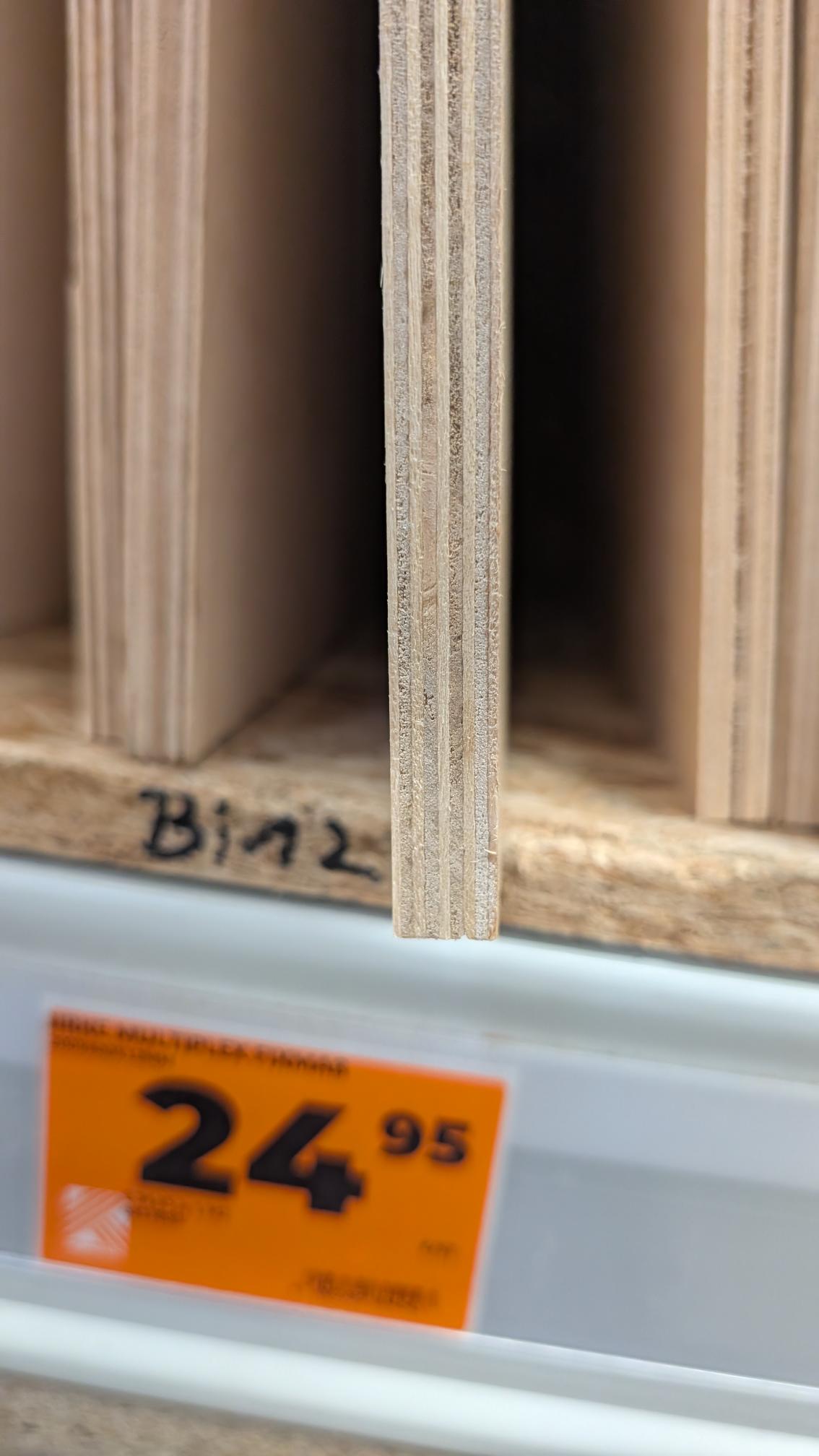

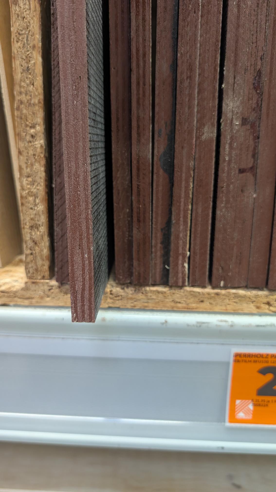

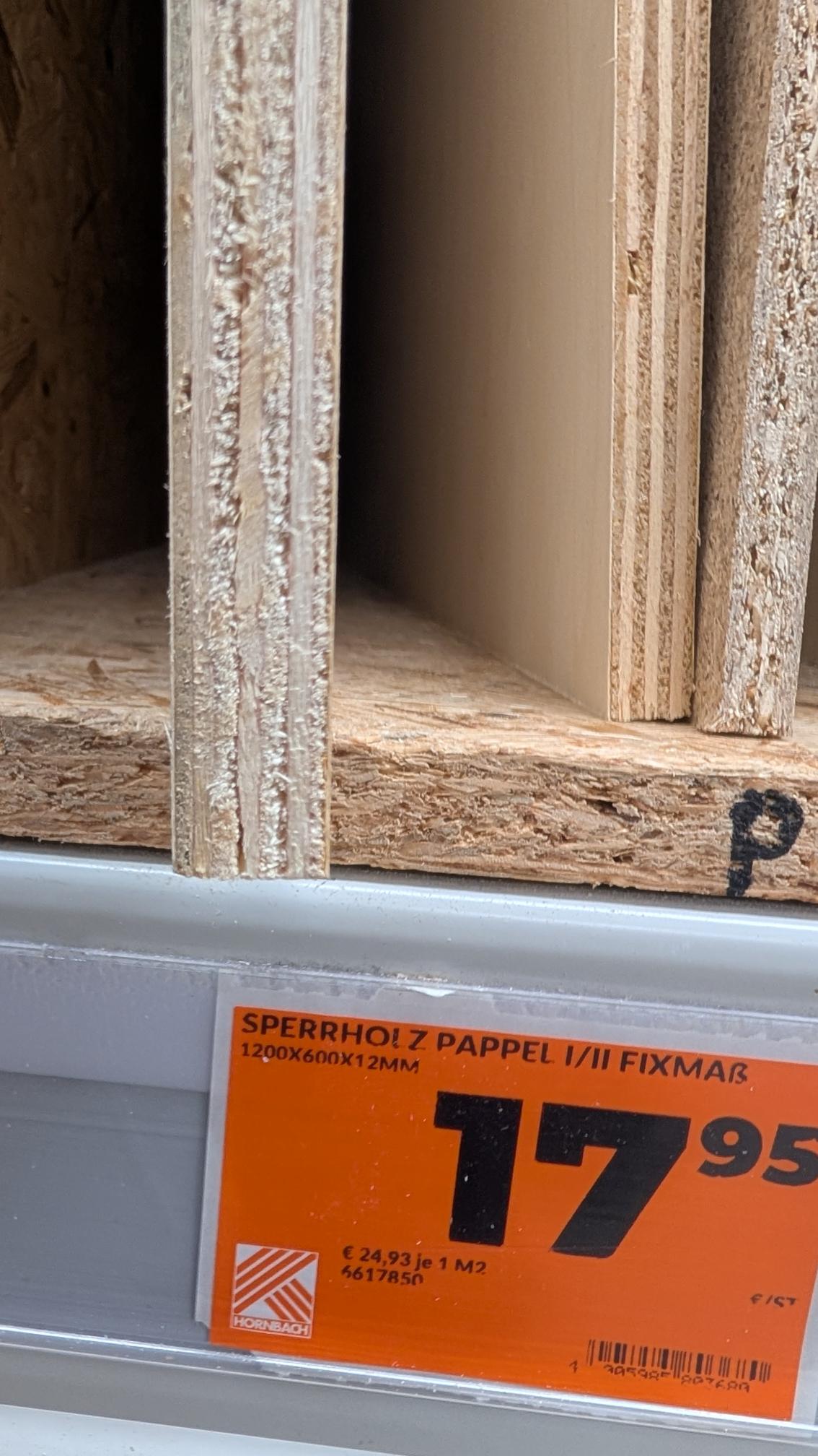

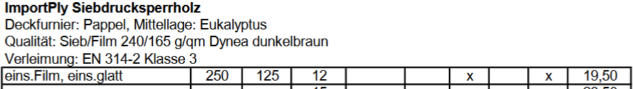

We have the BalticBirch, which is commonly made from 9 Plies in the desired thickness of 12mm, then some poplar with the problematic thin veneer as the toppings around 7 "real plies", and then some interesting poplar/eucalyptus with 7 plies: (And without a picture, the construction pine as well. But not a good idea) The pricing on them, when bought at reasonable sources, is about 106,36 €/sheet (4 by 8 feet, or 1250 by 2500mm) for baltic birch, and 72,23€/sheet (1220 by 2500mm) for the poplar/eucalyptus-combination (30mm smaller, but not crucial for cuttings i tried to arrange). Poplar with thin outer veneer comes at quite similar prices, but not worth it. As well as construction grade pine, all within the same range when not buying in huge bulks.
The poplar/eucalyptus has one side as "Siebdruck"; the common surface for truckbeds and Flightcases, and the other side has a film added. The film is somewhat annoying, as it won't hold paint before sanding completely. But by fixing holes and such, i think i will be sanding the whole surface no matter if there is a film applied or not. Maybe removing the film with a wire brush or something similar will do it faster and render less sanding paper unuseable. And for glueing, the roughed side should be fine as the surface is increased by that pattern. Even the common wood glue holds super well on that.
So I'd say its good to go for the poplar/eucal-Variant in Germany; saves a quarter of the price and some weight in the end as well; was recommended somewhere else in here to go for poplar due to weight. Warping should be quite similar, as it is firmly pressed in the production.
Edit: And i found them in the full sheet, at the same pricing: Price is per m² before tax, so it is 23,21 €/m² and 72,53€/sheet
