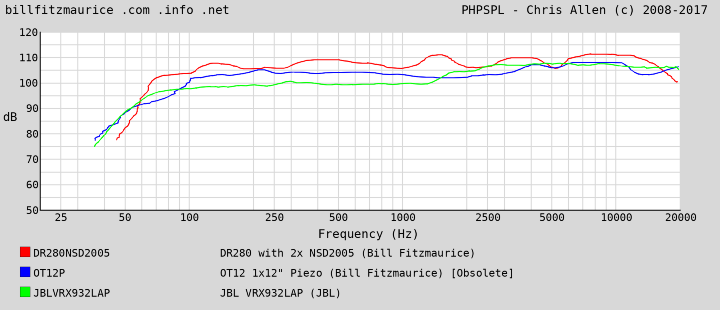

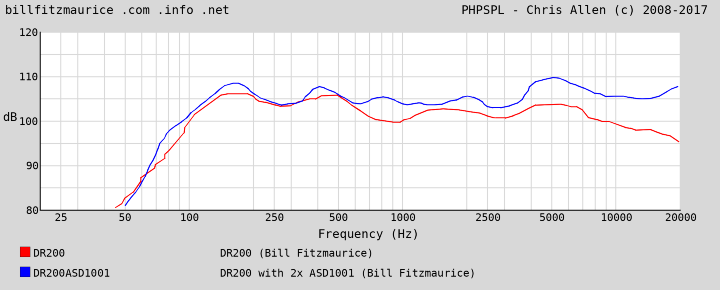

Re: Introducing SPL Chart

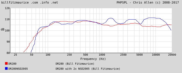

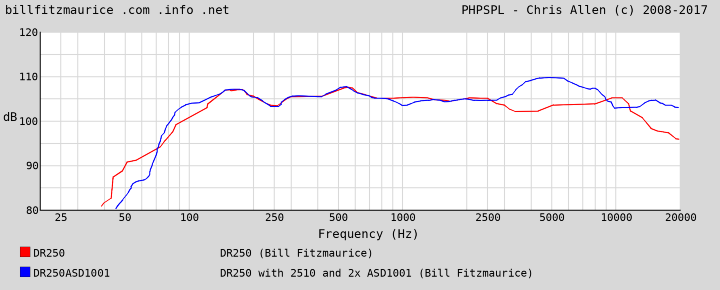

Just wanted to highlight that there are charts of the DR's that are ported and unported. All those with the compression drivers are ported. Also, the original DR200, DR250 and DR280 will be unfiltered and have the original curved horn.

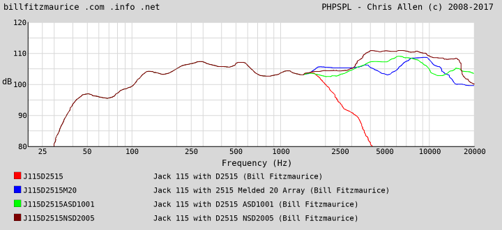

The new Jack 115:
Code: Select all
[spl]J115D2515,J115D2515M20,J115D2515ASD1001,J115D2515NSD2005&dbmin=80[/spl]

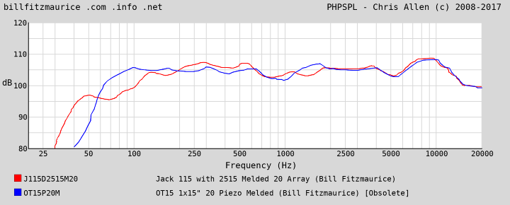

which chart is right? this one is different
- Posts: 29105
Read the fine print on his OTop chart.
- Chris_Allen
- Posts: 3358
- Location: Huddersfield, UK

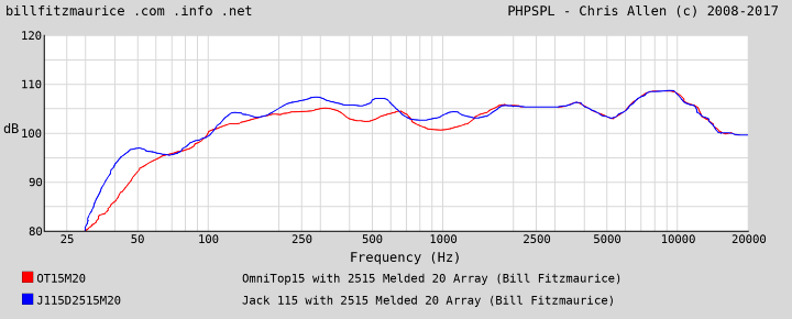

I'll verify against the latest plans, the OT15 was one of the first charts.
Yeah, as Bill says, I obsoleted it. Was replaced with this one:
My mistake with the previous post - I've updated the first page.
Code: Select all
[spl]OT15M20,J115D2515M20&dbmin=80[/spl]My mistake with the previous post - I've updated the first page.

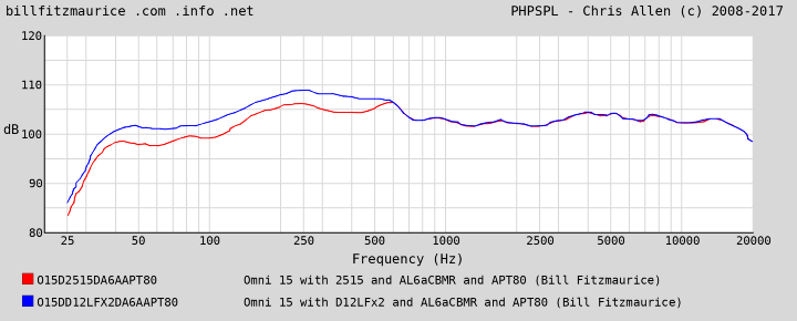

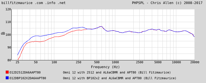

The new Omni 12 and Omni 15's with lower crossover frequency, different mid horn, phase plug and APT80 HF driver:
Sorry for the long names!
Code: Select all
[spl]O12D2512DA6AAPT80,O12DBP102X2DA6AAPT80&dbmin=80[/spl]Code: Select all
[spl dbmin=80]O15D2515DA6AAPT80,O15DD12LFX2DA6AAPT80&dbmin=80[/spl]Sorry for the long names!

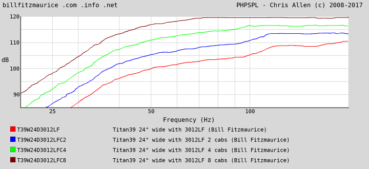

Chris, would you please add the 24"w 3012LF T39? It's in the SPL charts section ...
http://billfitzmaurice.info/forum/viewt ... f=12&t=487
Thank You!!!
Thank You!!!
Albert Einstein
Albert Einstein
- Chris_Allen
- Posts: 3358
Here are all the multiples on 24" wide T39's:Mikey wrote:Chris, would you please add the 24"w 3012LF T39? It's in the SPL charts section ...
Thank You!!!
Code: Select all
[spl]T39W24D3012LF,T39W24D3012LFC2,T39W24D3012LFC4,T39W24D3012LFC8&dbmin=85&fmax=200[/spl]

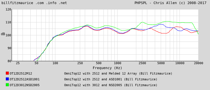

Here are the new OmniTop 12's with the phase plug:
I need to double check the sampling range on the NSD version.
Code: Select all
[spl]OT12D2512M12,OT12D2512ASD1001,OT12D3012NSD2005&dbmin=80[/spl]I need to double check the sampling range on the NSD version.
