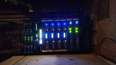

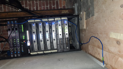

Thank you Seth! I think this was the most work I've ever done in 1 month in my life
I will post videos of the shows on YouTube later. And maybe I'll upload a video walkthrough of my signal flow. It's sorta complicated with the matrix processing between the system DSP, matrix DSP, and console. The system processor didn't have nearly enough IO to do what I wanted so I had to offload some of it to another unit. I honestly don't even know where to start
it's complicated on the back end but I've made it easy for the house engineers when I'm not around. I've never designed anything even half as complicated as this, and it sorta blew my mind when it just worked
but because I've aux fed and grouped things the way that I have, I have an unbelievable level of control of the djs mic volume on either side of all 4 zones without causing the house techs too much grief. You know how djs are with pointing the mic all over the place. Plus this means with quick programmable preset buttons on the AHM that I can quickly reorient the room for comedy nights with one button. Anyways in the meantime here's the rack.
