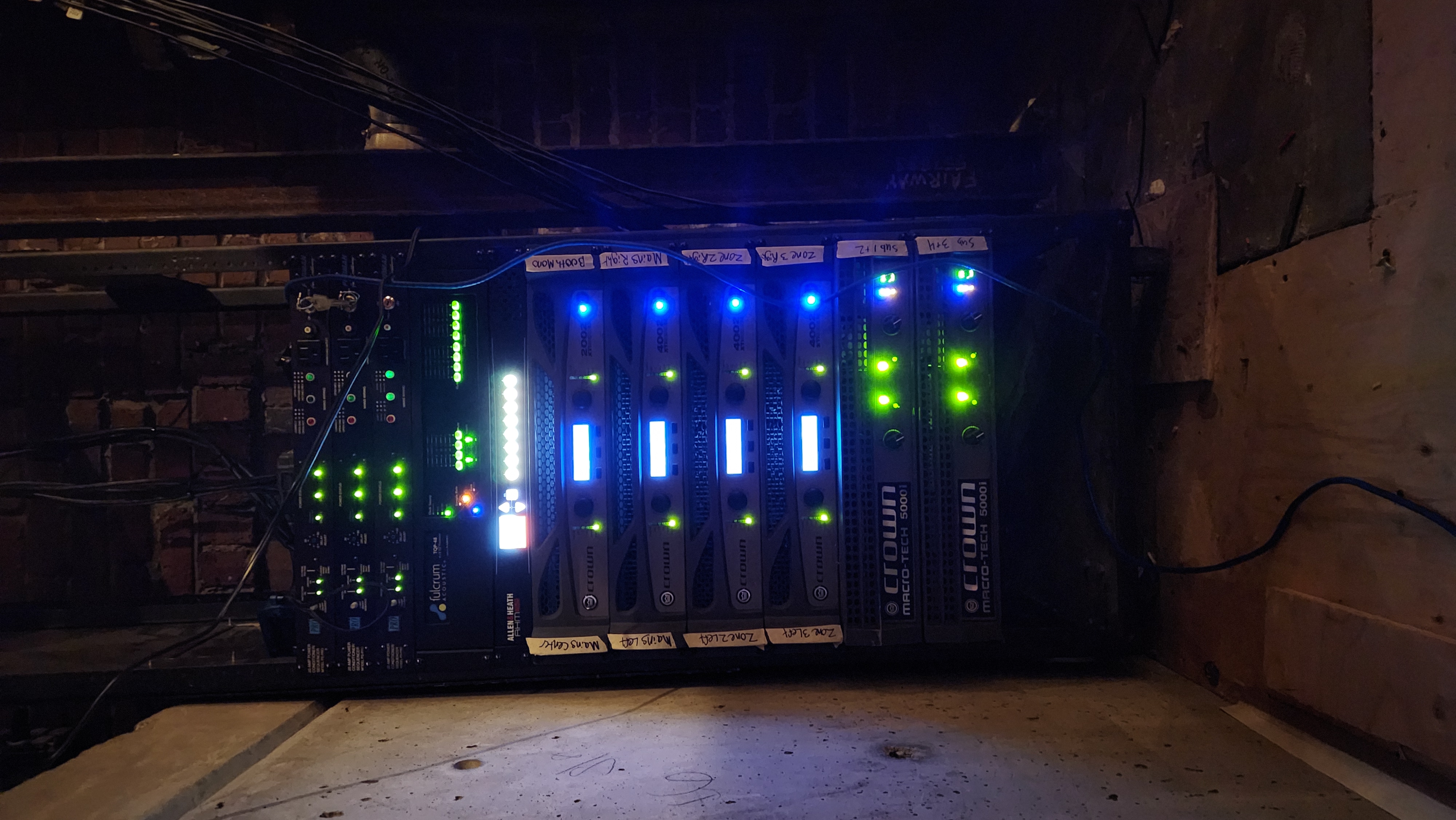

The low end in this room is challenging. I am ultimately not super happy with the sub placement and will move them around until I find a better place for them. There is a suckout in the middle of the room that leads me to believe the short dimensions of 2 sides are contributing to this room behaving more like a small room. So splitting the subs up may be the best option. We definitely have the headroom LOL. I think I may try geddes approach and try to randomize the modes being activated. There are already 9 ported tops around the room contributing loads of 70hz, and the preset hpf on the tops is 40hz, so we are off to a good start
these tops are weird they seem to be tuned pretty low, with an undersized enclosure and excessive xmax. Then they apply FIR filters to flatten phase and magnitude down to around 500hz, as well as correct for coaxial loading geometry, and ultimately apply a very wide q 9db boost around 80hz. It's honestly brilliant and works so well! But it means that my hpf is really not too far from where the hpf is on the subs
I know geddes believes you should leave the mains without a hpf but these are ported so they need it. This is pretty much just as good as a sealed main without a filter. It makes integration very easy as the phase shift caused by the 4th order hpf isn't until out of passband. These are remarkable loudspeakers really, they are shared magnet coaxial too, which I've never seen in person. The HF horn as well as the woofer use a 3" voice coil. Sorry for focusing so much on the loudspeakers I am just enamoured with these designs. They are so out of the box
well it seems as though they may be instrumental in achieving better bass response around the room. Crossing them over higher had negative ramifications in the subs current configuration.

"There are already 9 ported tops around the room contributing loads of 70hz, and the preset hpf on the tops is 40hz..."
Anyone else's Spidey senses tingling with these crossover points? Just for shits and giggles maybe try raising the HPF on the mains. Try several settings- 80, 85, 90, and see how it effects the sound.

I agree. There may well be cancellations happening.

When crossing over higher it actually caused the club manager to notice the lack of kick in the room. I tried that last weekend and the ramifications for coverage were negative. I could do that if I had better coverage with the subs. But the problem is that a very great portion of the room is missing something between 50-100hz, so even if I have laser perfect alignment between the subs and tops it doesn't mean a damn thing because it gets sucked out completely in some parts of the room. I'm not talking -24db this is damn near silence at some wide frequency ranges. The overlap is completely necessary at least until I'm able to deal with the antinodes all over the room destroying the kick section. I have never encountered a room with such catastrophic bass issues. For now the tops are getting run low, both at the request of the club owner, and based on my own observations using room EQ wizard. So far, the double bass array method of having a sub on the other side of the room time aligned and out of polarity has yielded the best results. But the problem is that the sweet spot for one of the stacks is on the stage
. This is the greatest challenge of my career as the layout of the venue doesn't provide me a lot of options for dealing with room modes.
I mean I am having much more luck with home theater forums and resources to deal with this than I am pro audio. This is playing by small room rules and it is absolutely devastating to a frequency range that is very important for house music, which is the primary genre this venue focuses on. Some places are phenomenal and others are not. In order to be able to get good and UNIFORM response between 50-150hz I am going to need to try just about every trick in the book.

Th only real cure for a bad room is more subs, not to add volume, but to smooth the response throughout the room.

I may be able to utilize halfway points between the longest dimensions of the room on either side and try Todd Weltis approach, but I'd only be able to use 2 walls, no corners are available. I think this is going to be my next experiment. If this doesn't work I guess I'll begin the long painstaking process of simulating and time aligning subs in 3-4 locations around the room, and then hammering down peaks in eq. And then if THAT doesn't work I will settle on the double bass array. I don't want to use the DBA because I would sacrifice the most output in favor of active cancellation. I don't think I could convince the club to build more subs
so far though DBA is the most promising with the lowest level of variance.
