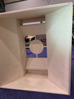

#17 Post by Clef's of Bass »
Keryn O'Shea wrote: Wed Jun 05, 2024 6:14 pm
Clef's of Bass wrote: Sun May 19, 2024 6:12 pm I'm back for another J15 build
Flawless craftsmanship as per usual mate 👍

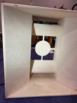

Thanks dude. It's going together pretty good.💪

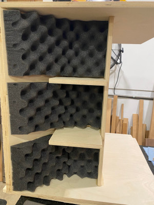

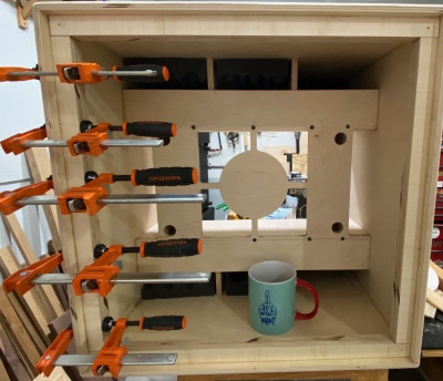

Glued in some foam before bonding the side, while I had access to it.

Now we're talking!

#19 Post by Clef's of Bass »

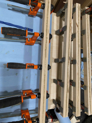

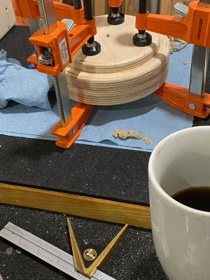

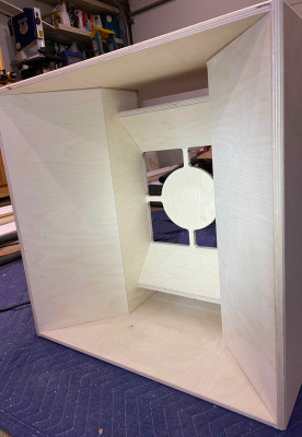

Almost done with the glue ups.

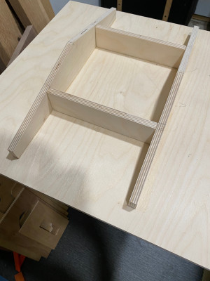

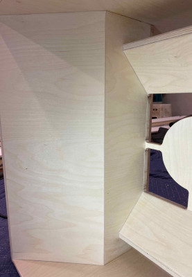

Flange.
Really pleased with how tight these glue joints are turning out.

Clef's of Bass
Posts: 97
Re: J15 Build
#22 Post by Clef's of Bass »
Scott Brochu wrote: Tue Jun 18, 2024 10:39 am :clap: Looking sharp :clap:
Thanks Scott, these J15's will be gigging cabs and will be hanging around for awhile so they'll need to look good :hyper:
Progress is slow, I have a few different projects around the house going on at the same time. :bash:
At second glance, the plug extensions look like a stack of pancakes 🥞. 🤤

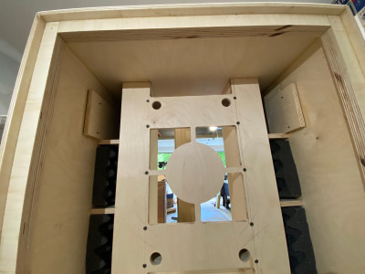

getting closer to finishing

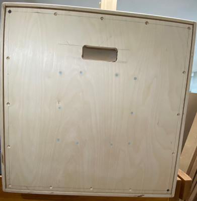

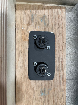

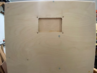

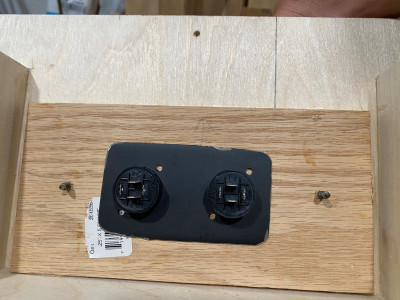

Great progress today. Glued in the side handle supports, routed for the side handles, and drilled out the rear panel screw flange. Had and Idea about the speakon connecters. I really don't like the connector dish look, so I chopped up the dish and will use it as a washer for the bolts.

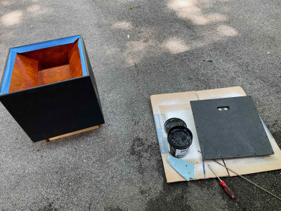

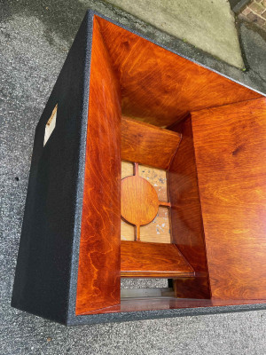

Finally got some dye, poly, and Duratex on it. Almost done with the outside.
Also, made scrap bin for some shop organization (long overdue).

Clef's of Bass wrote: Fri Jul 05, 2024 6:20 pm Finally got some dye, poly, and Duratex on it...
That colour combo is excellent! Can you eleborate on the process you used for the Dye & poly please?

Keryn O'Shea wrote: Sat Jul 06, 2024 5:15 pm That colour combo is excellent! Can you eleborate on the process you used for the Dye & poly please?
Your blue mug has the right attitude as well mate :D
Thanks Keryn.
For the front of the cab, I started with ColorTone 'Vintage Amber' dye (undiluted) applied with an old cut-up T shirt. Let it dry overnight, lightly sanded back and dyed for a second time. Then, applied polyurethane (warm semi-gloss 2 coats).
For the sides and top, tapped off the front with blue painters tape and applied the Duratex with a foam textured roller.

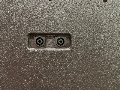

The washer plate worked very well.
