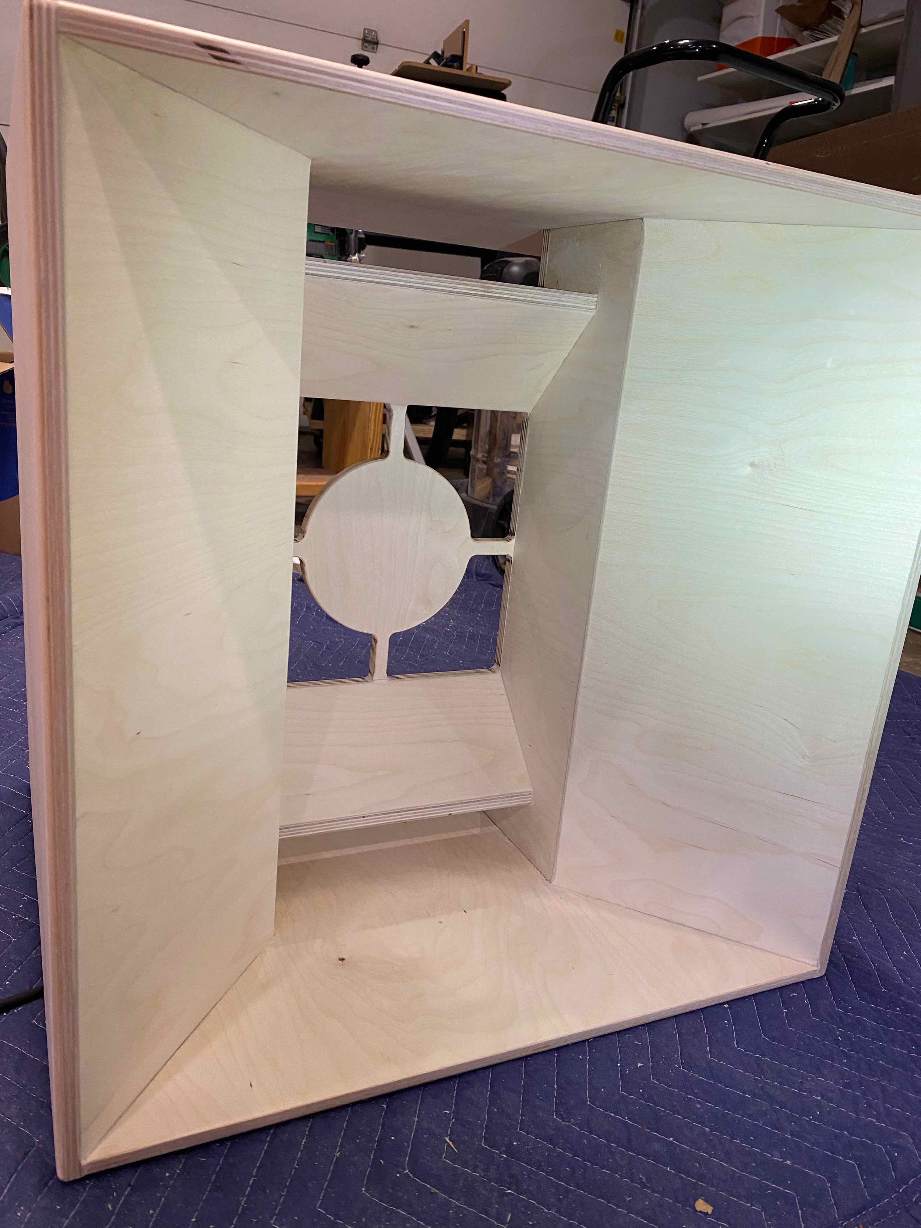

I'm back for another J15 build
Flawless craftsmanship as per usual mate

Love that BB ply.....
After over ten years of building, l finally picked up 1/4" BB for a pair of J10Ls, really looking forward to not dealing with warp & voids as you describe Bruce

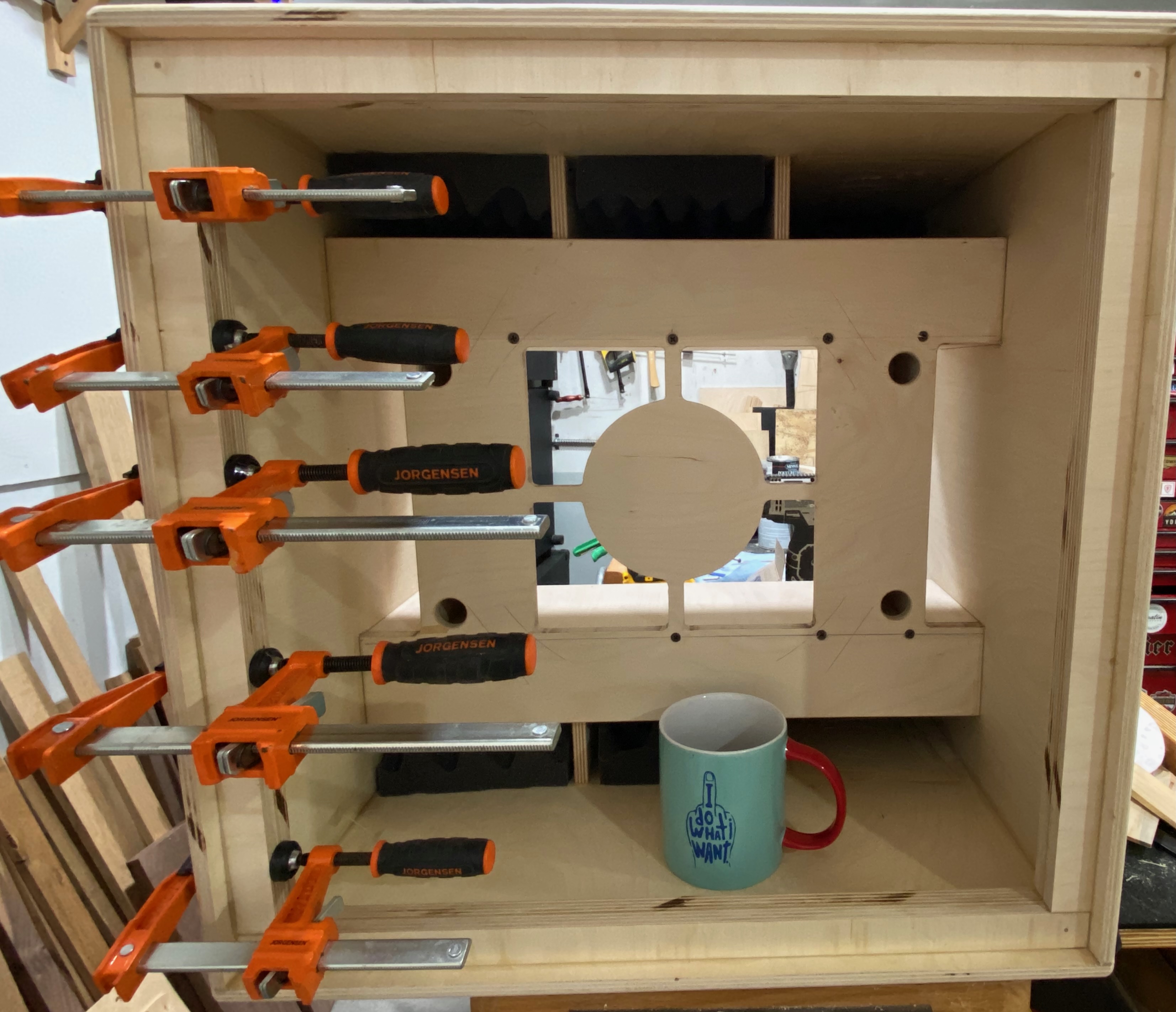

Progress is slow, I have a few different projects around the house going on at the same time.

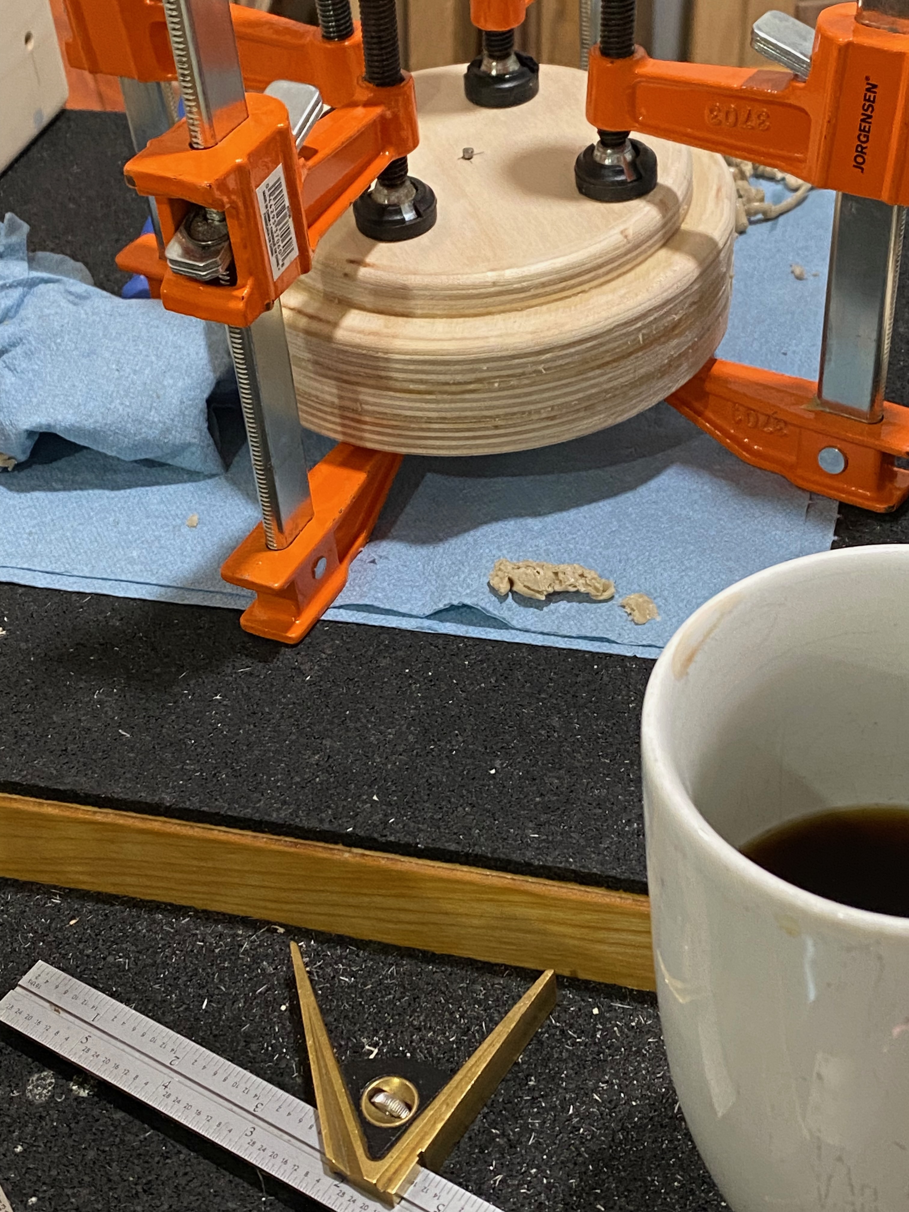

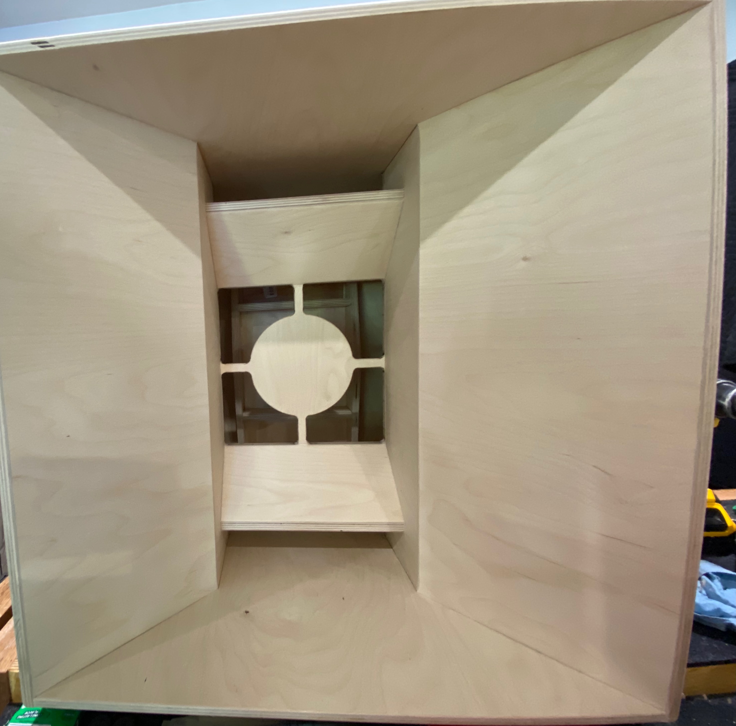

At second glance, the plug extensions look like a stack of pancakes .

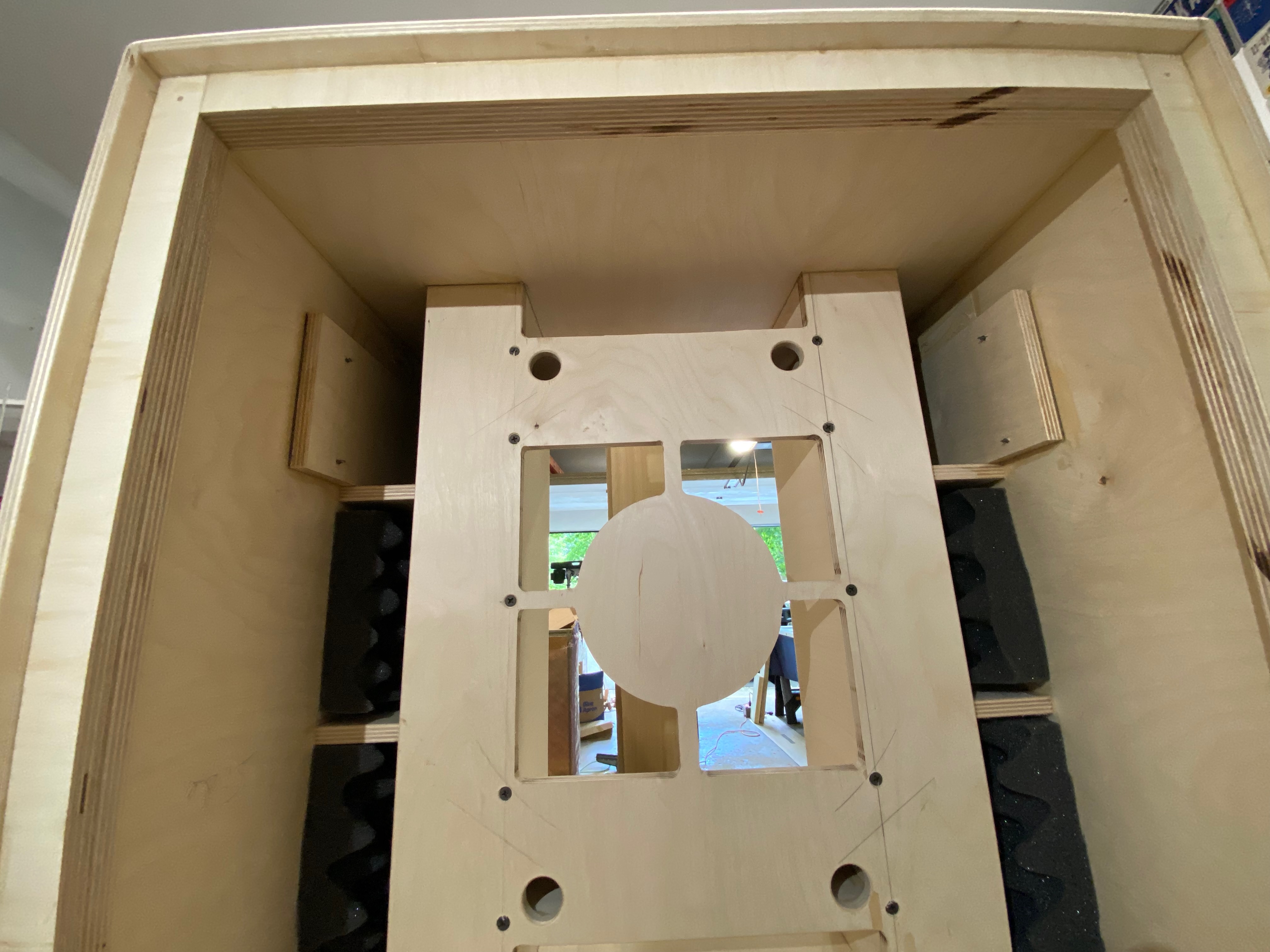

getting closer to finishing

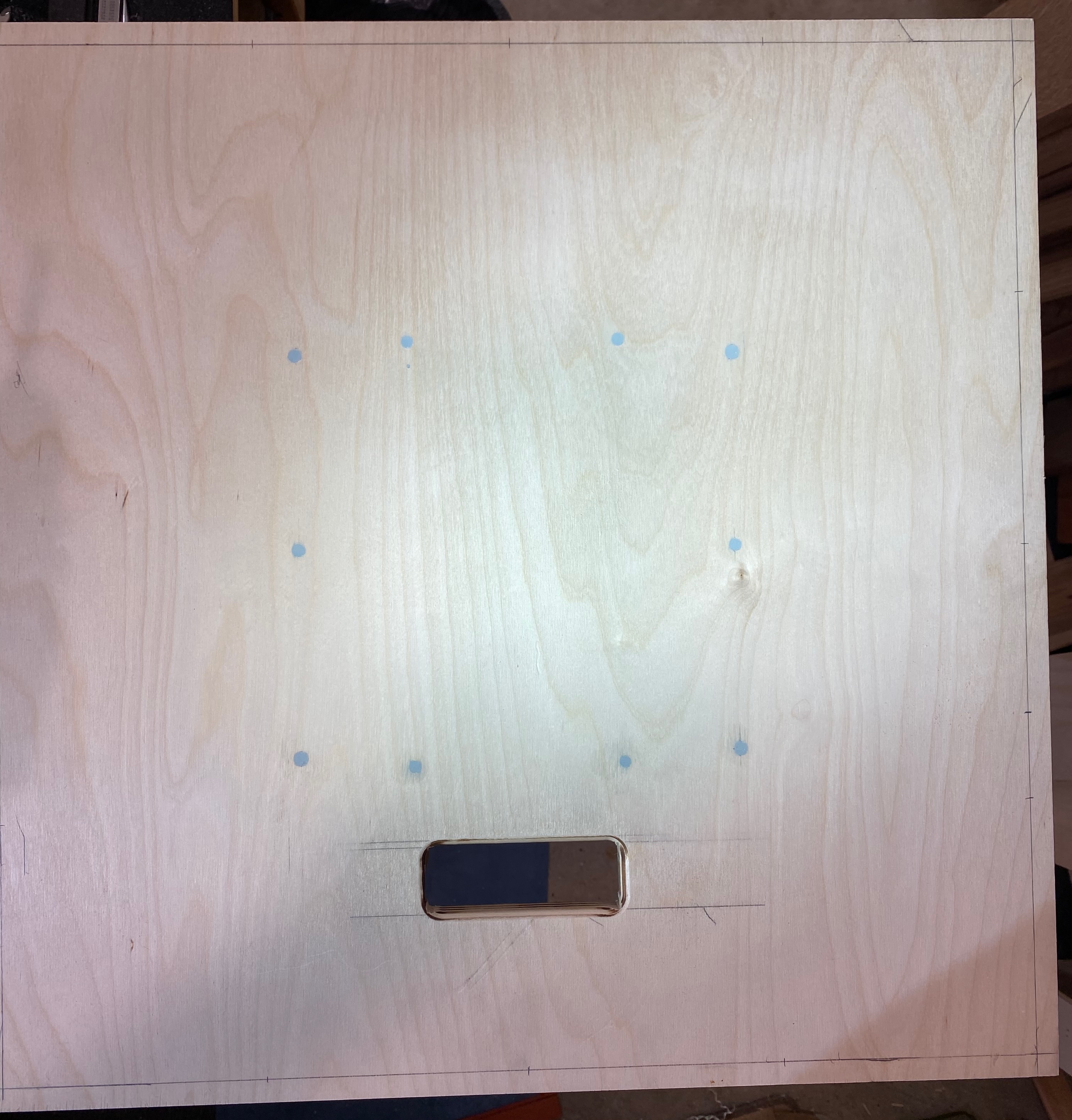

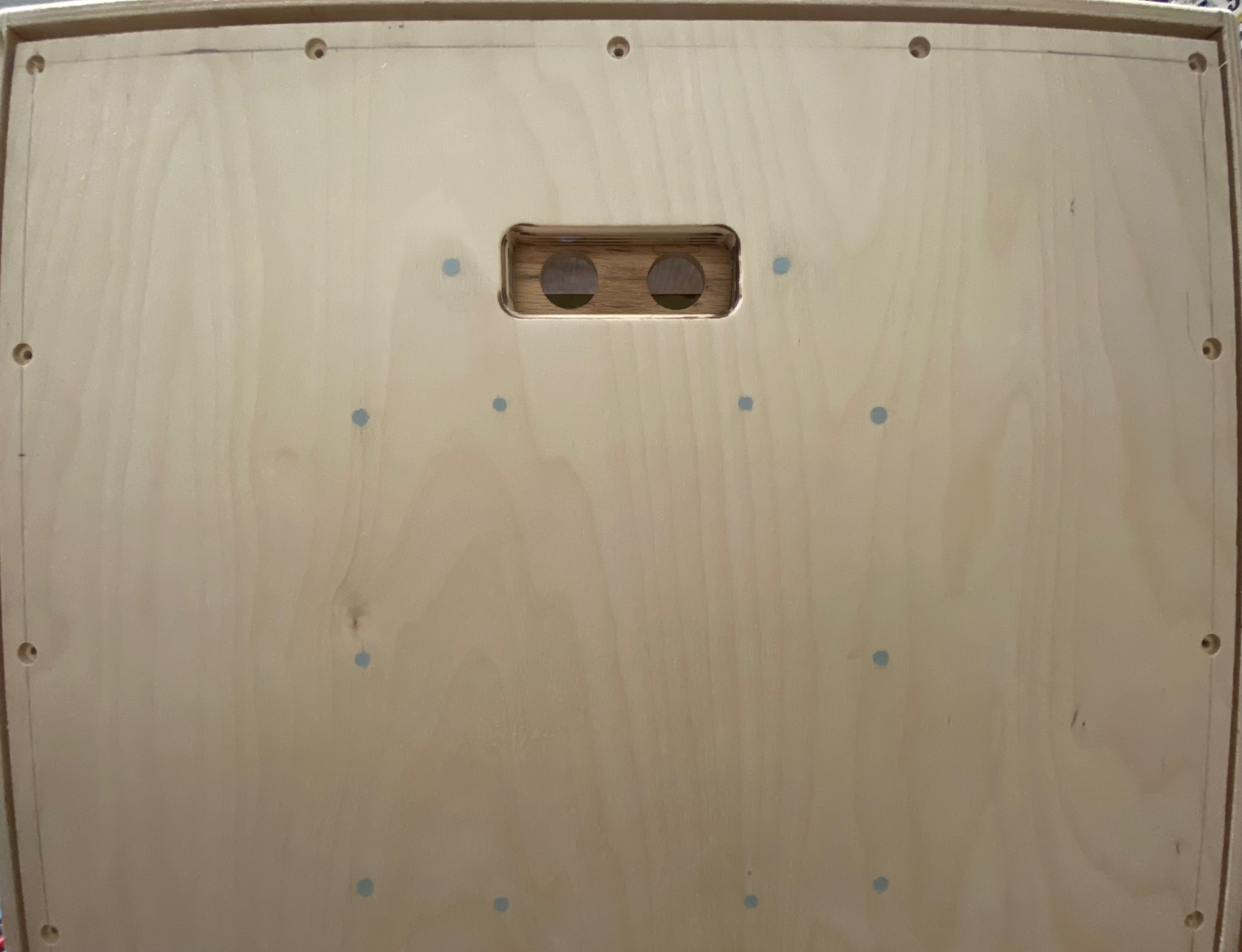

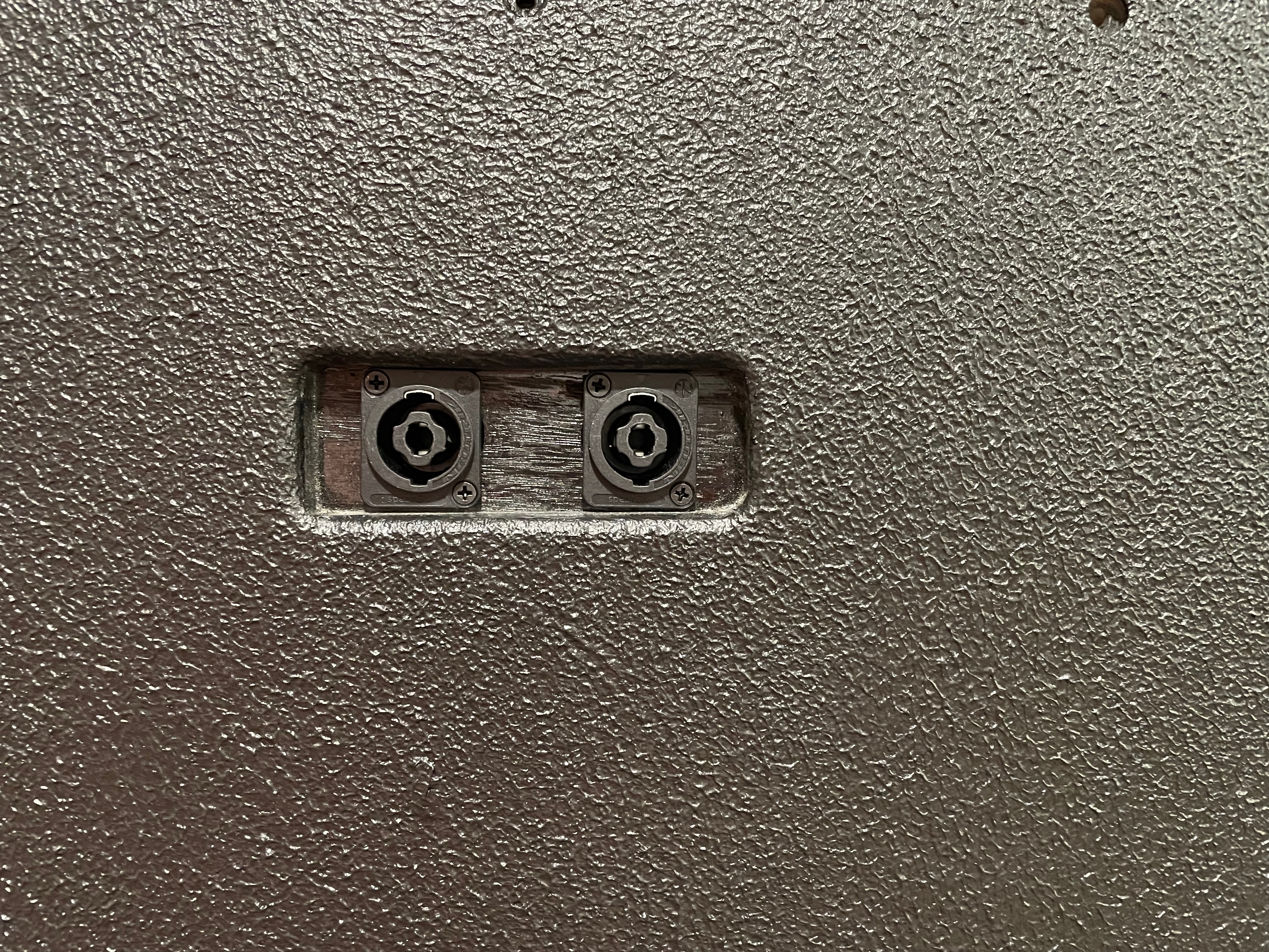

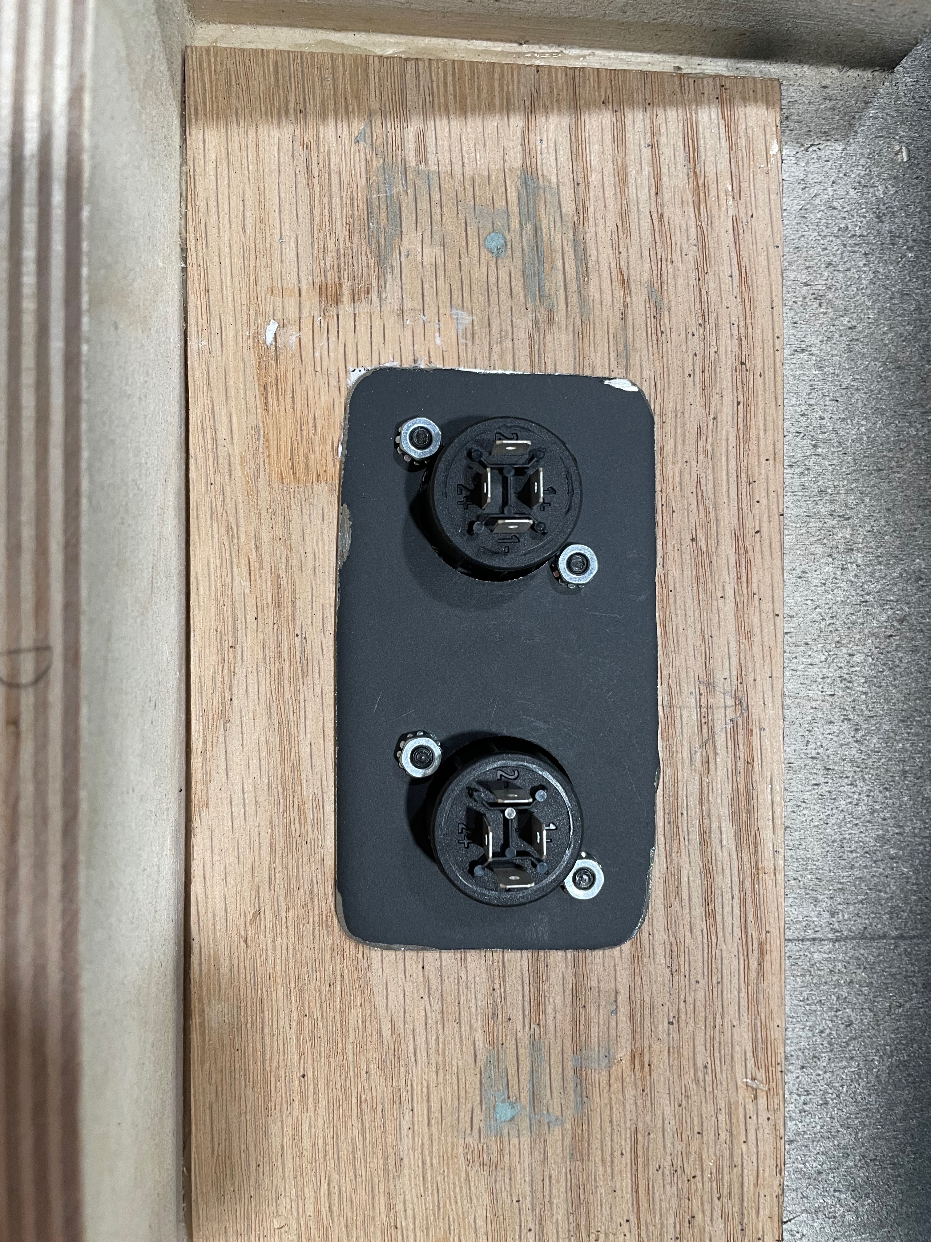

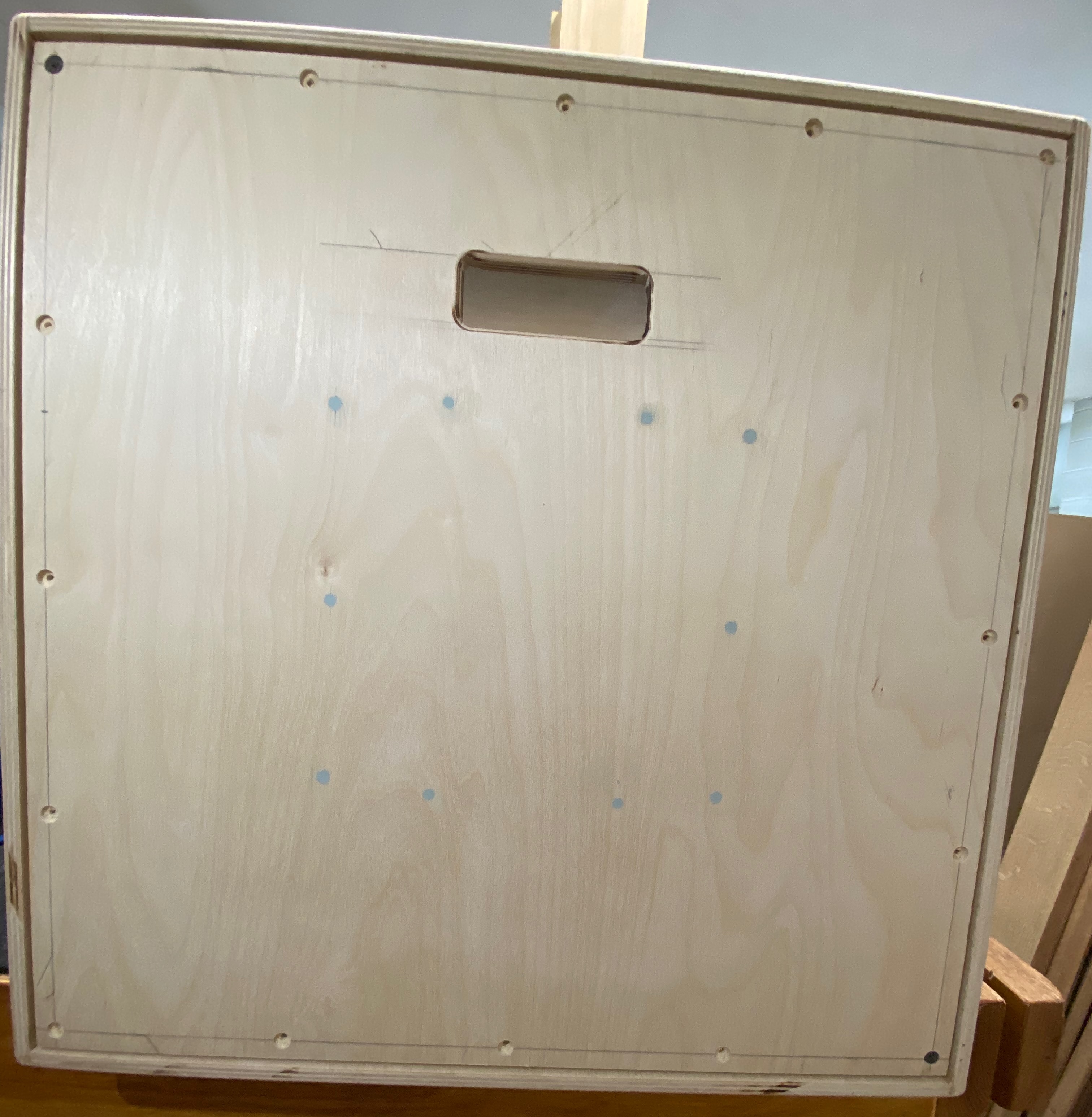

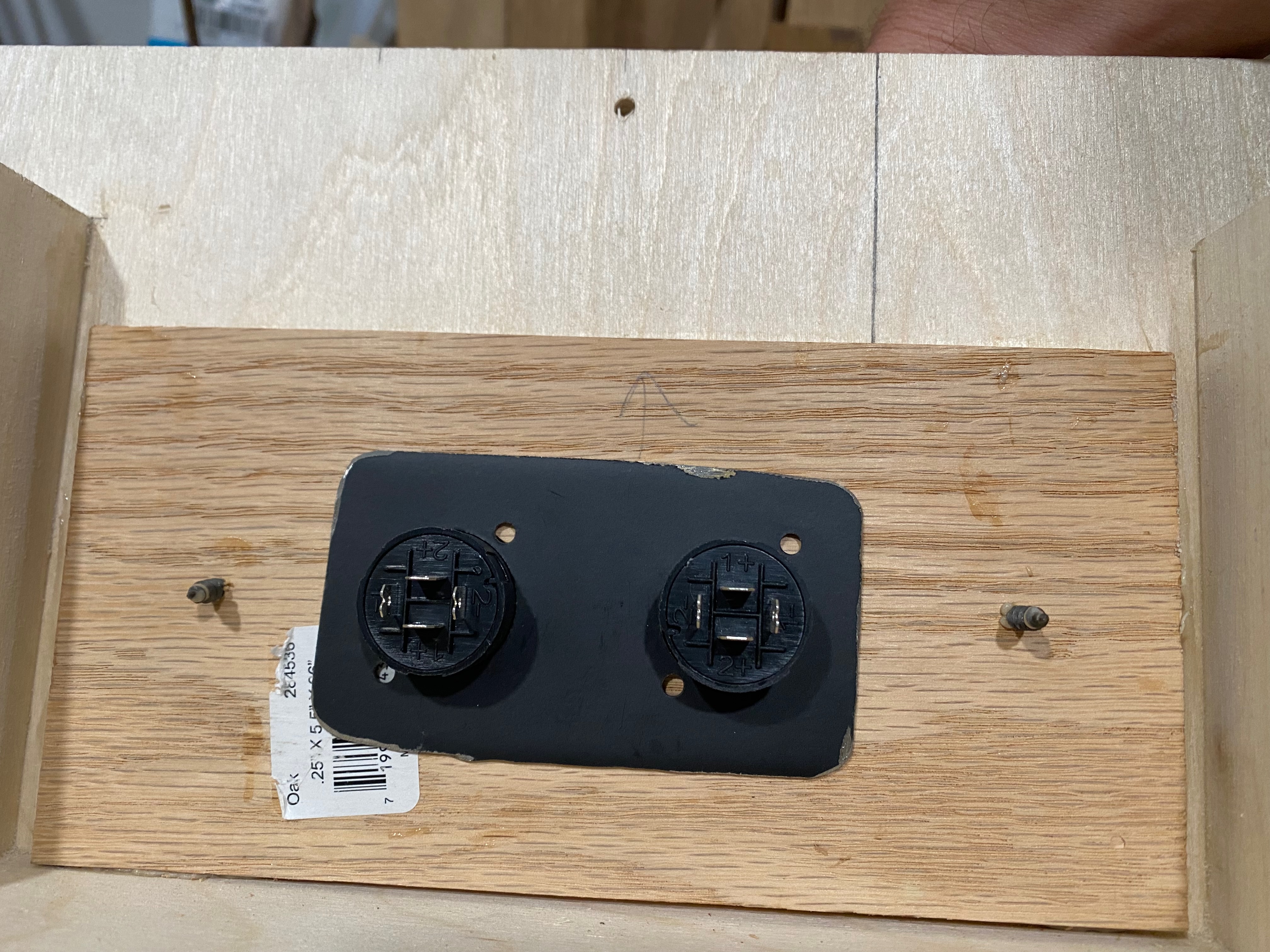

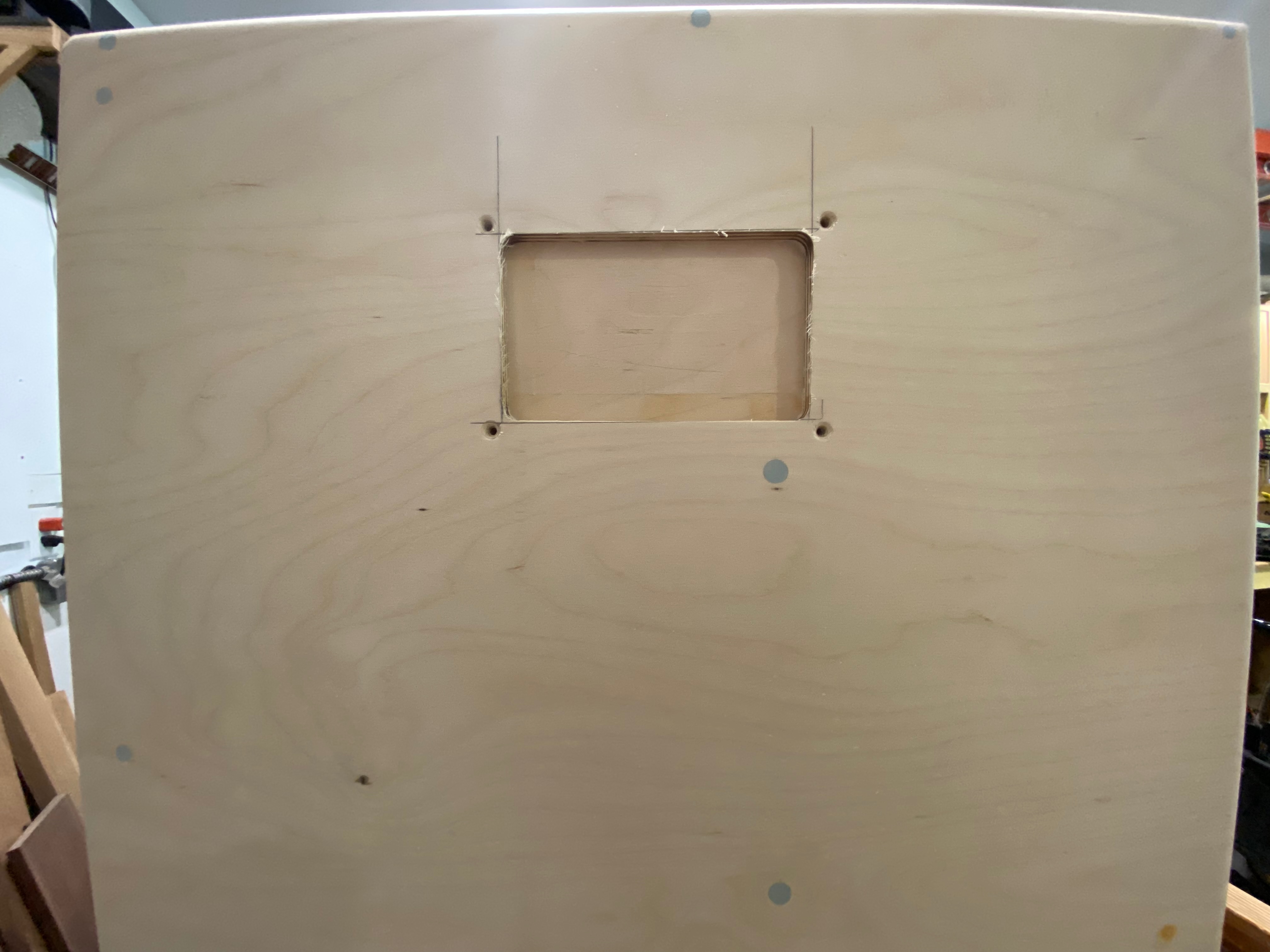

Great progress today. Glued in the side handle supports, routed for the side handles, and drilled out the rear panel screw flange. Had and Idea about the speakon connecters. I really don't like the connector dish look, so I chopped up the dish and will use it as a washer for the bolts.

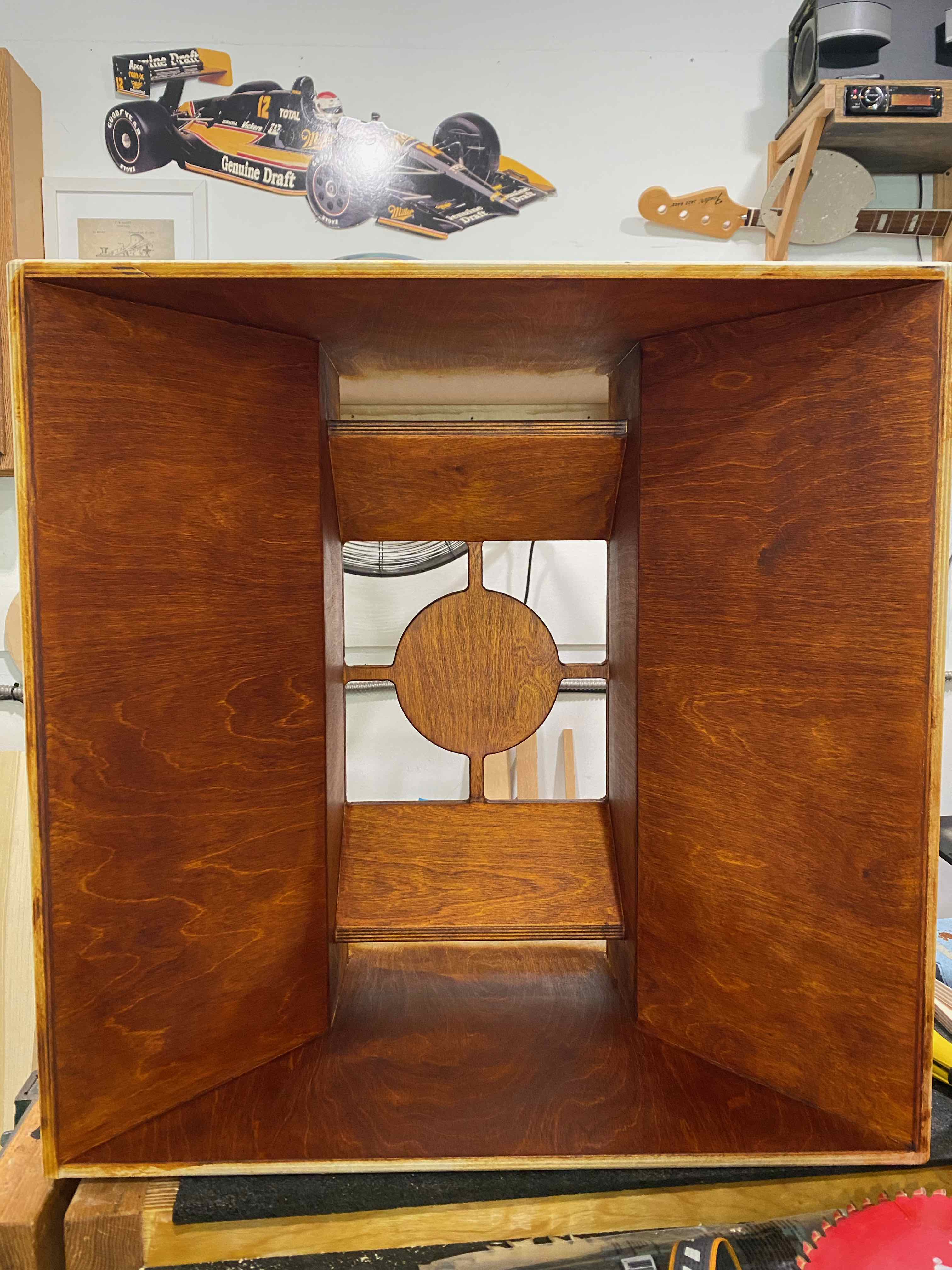

Keryn O'Shea wrote: ↑Sat Jul 06, 2024 5:15 pm

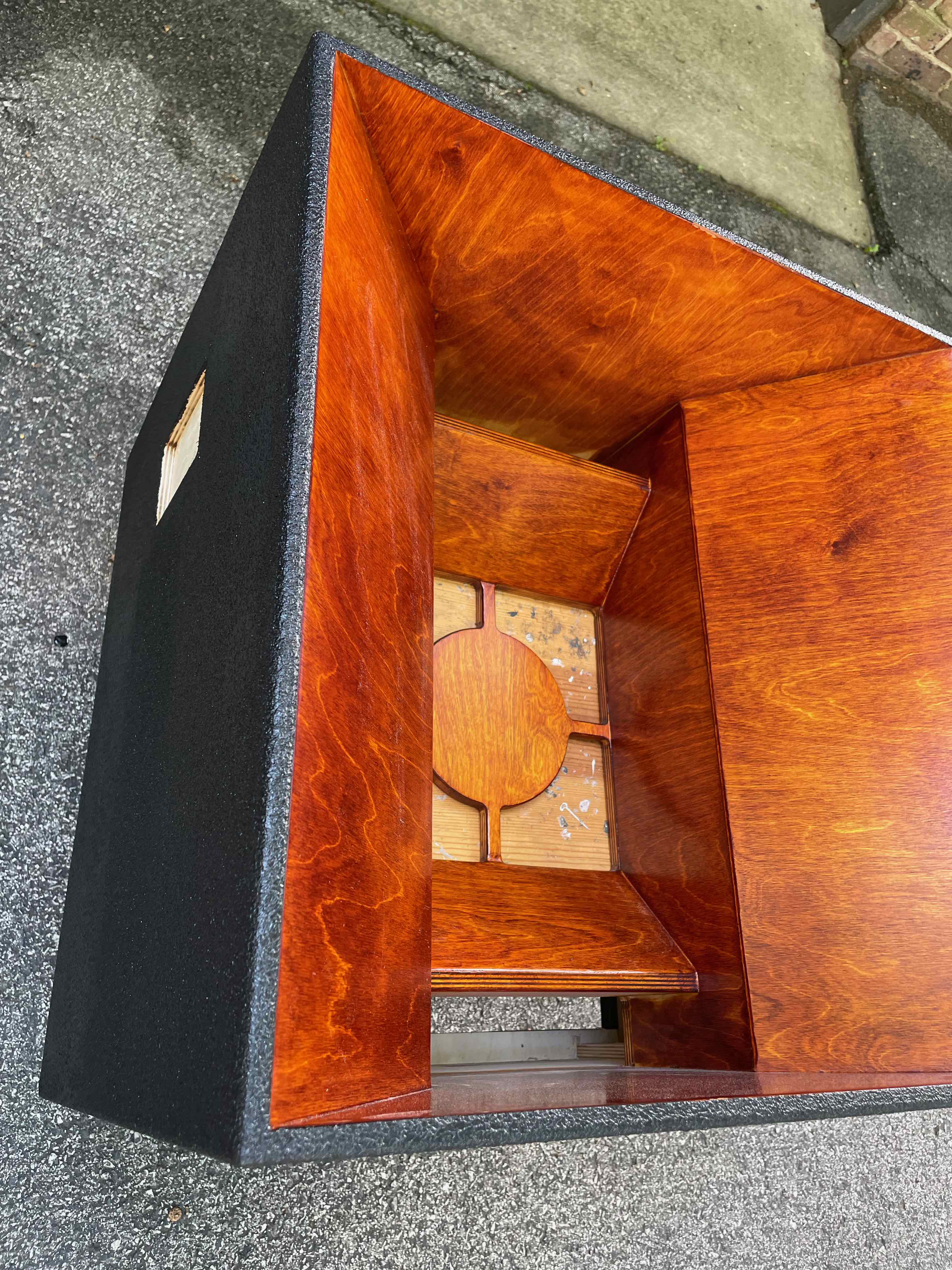

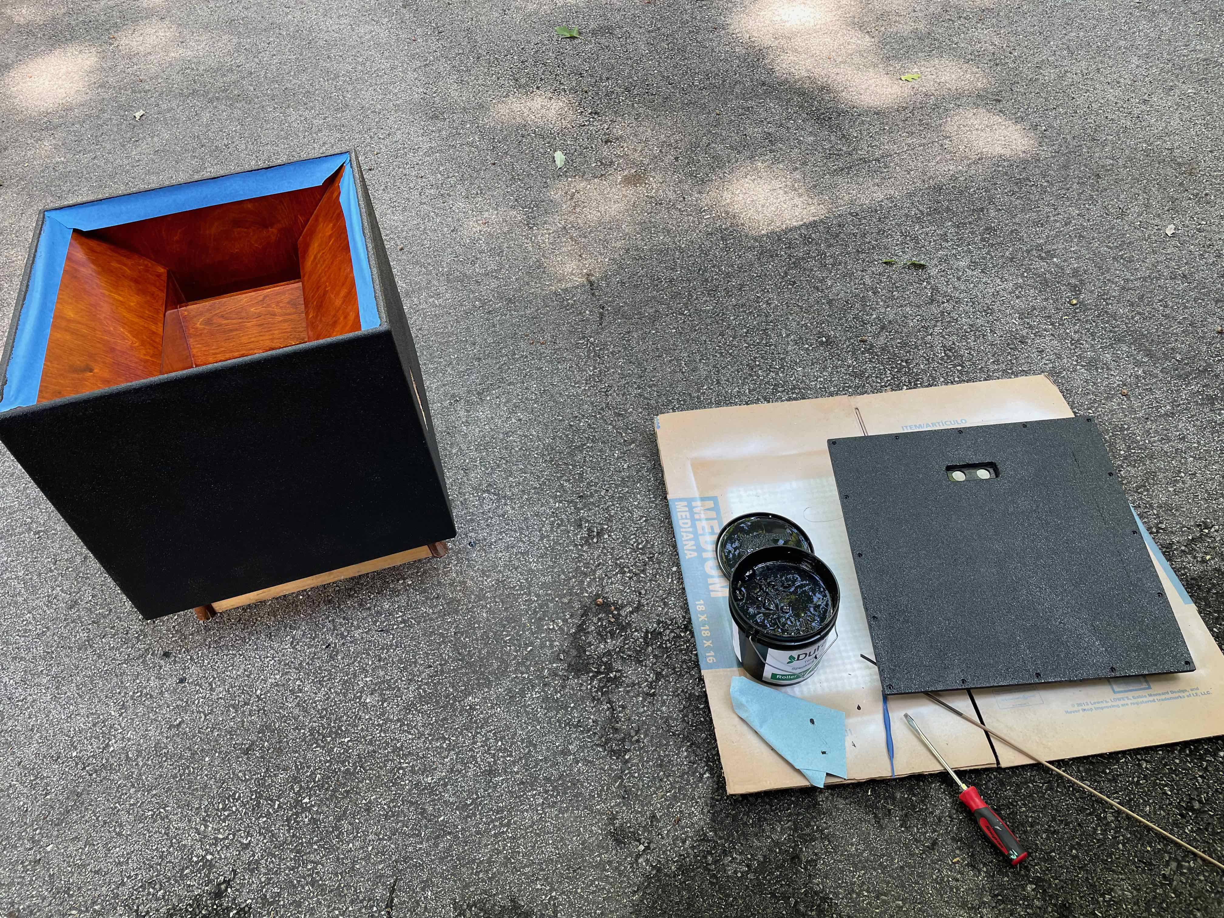

That colour combo is excellent! Can you eleborate on the process you used for the Dye & poly please?
Your blue mug has the right attitude as well mate
Thanks Keryn.
For the front of the cab, I started with ColorTone 'Vintage Amber' dye (undiluted) applied with an old cut-up T shirt. Let it dry overnight, lightly sanded back and dyed for a second time. Then, applied polyurethane (warm semi-gloss 2 coats).
For the sides and top, tapped off the front with blue painters tape and applied the Duratex with a foam textured roller.
