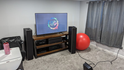

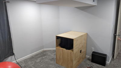

Seth wrote: Fri Nov 03, 2023 10:02 am In the listening space, place the sub in the location it would be coming through the wall, mouth aimed at the wall, about about a foot away from the wall. If it produces acceptable response throughout the low frequencies at your primary listening position, it's likely to produce very similar results with the sub mounted in the wall there. Do you have any testing equipment, REW? That can really take a lot of guesswork and subjectiveness out of the process.
One question I did have.. how would firing at the wall (technically corner loading , no? ), be the same as the sub (mouth ) be firing into an open area?
Posts: 3170
Re: THT placement. Just pulled it out of retirement!
#28 Post by Seth »
Comatoast wrote: Sat Nov 25, 2023 8:21 am One question I did have.. how would firing at the wall (technically corner loading , no? ), be the same as the sub (mouth ) be firing into an open area?
Soundwaves reflected off a surface from a source that's placed very near the reflecting surface propagate throughout a room very similarly to soundwaves originating from the reflected surface (aka speaker in the wall)... creating very similar peaks and nulls throughout the room. Not perfect, but very close... similar to how shining a flashlight in a mirror is very similar to shining a flashlight from the position of the mirror.
Looking at your pics, I'd wonder how well it would sound if it fired from the same little nook area but turned 90º and firing through the wall into the little hallway to the right of the viewing screen. It looks as though that position would hide the cab pass through from view.
Comatoast
Posts: 19
Joined: Thu Nov 02, 2023 7:48 pm
#29 Post by Comatoast »
So here's where I'm at... I'd put the sub behind this wall, cut open the Sheetrock where the port mouth is, then seal everything up good.. and to cover the hole, I'd make a frame out of some 1x2 pine , then wrap it in some acoustic speaker fabric to clean it up and cover the hole...
Then the TV and speakers would go against that wall , ( sucks as the port will basically be firing into the back of the TV.. ) and the couch on the other wall. ( Where the tv is now....
Worth a shot, or does this have bad news written all over it ? Lol
Posts: 29119
You can test it by aiming the sub mouth at the wall from a foot away. It will give the same in room response as flush mounting in the wall. Once in the wall anything in front of it will have no effect on the sound. Fourteen foot wavelengths go around obstacles. But anything in front of it will probably vibrate.
