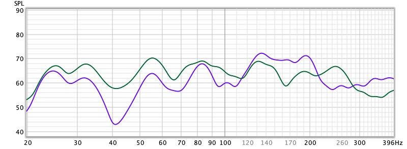

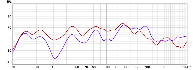

Okey, I did new measurements on different distances from the back wall. Red is 30 cm from back wall, green is 60 cm from back wall. Purple is the current listening position at 2,27m. I have to say there is a window in the back wall, like 17cm deeper then the wall itself, the measurements are from the window...
The 40hz notch is less deep. And it looks like there is not much difference between 30 or 60 cm from the back wall. It even looks like 60 cm from the back wall is giving a flatter bass overall. But the 40hz notch is not completely gone...
And I always thought that the back wall was the worst listening position because of bass build up (slow bass) / standing waves and reflections? I have a window there with blindings. And the surround speakers are hanging on the back wall, there will be a lesser surround effect, I know that, because I once had the couch there! And the screen is a lot smaller..
Some recommendations says like 1 meter al least from back wall...I did some more measurements and the further away from back wall, how deeper and sometimes wider the notch around 40hz became.

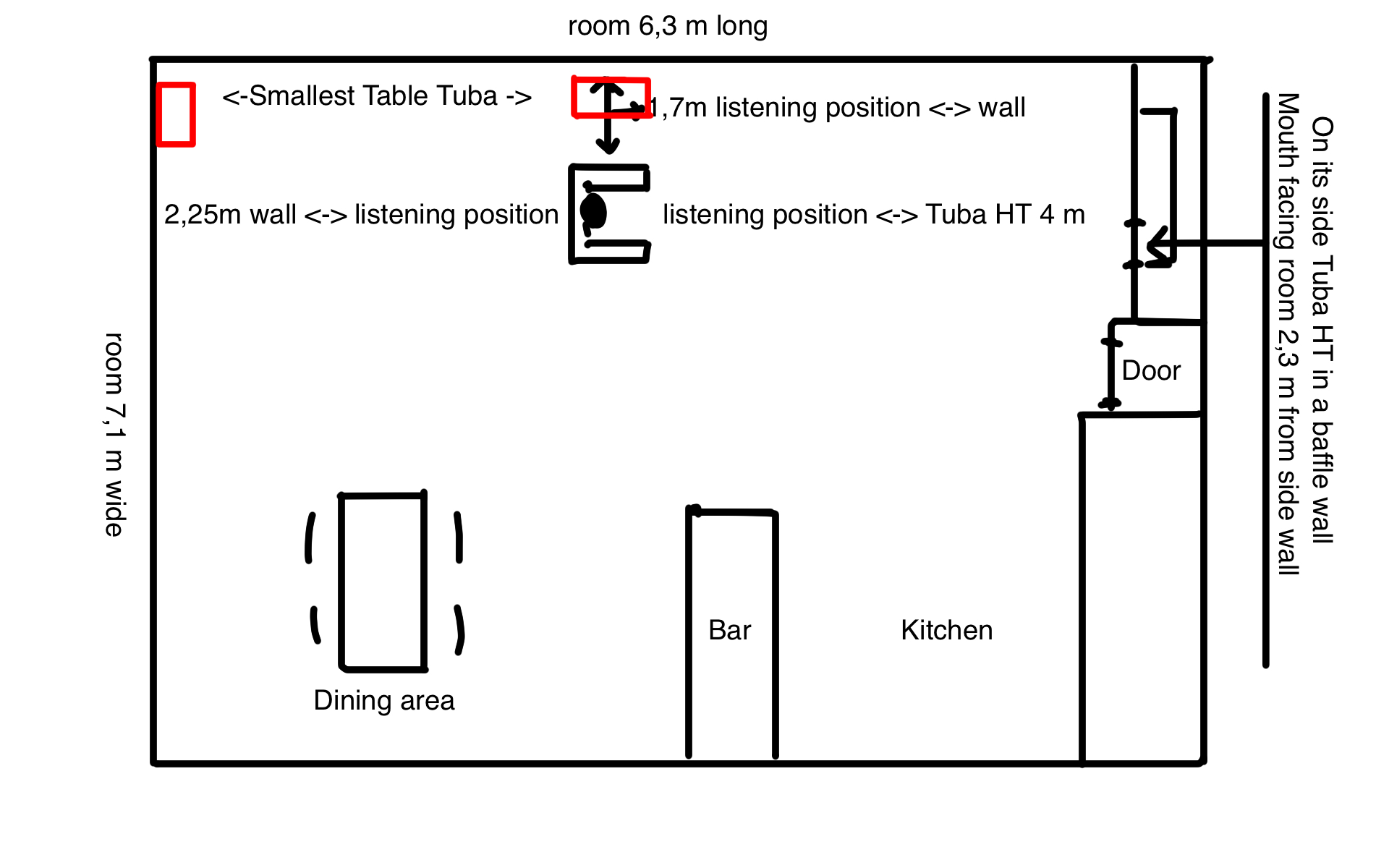

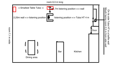

On a good day I will test the sub in the back and do new measurements. But my wife never gonna except a big sub like the Tuba HT there. :? So I'm already looking for other solutions. Will it make any sense and difference to put the smallest Table Tuba in the back corner or next to the listening position? (see picture) The one that roll-off after 38hz?

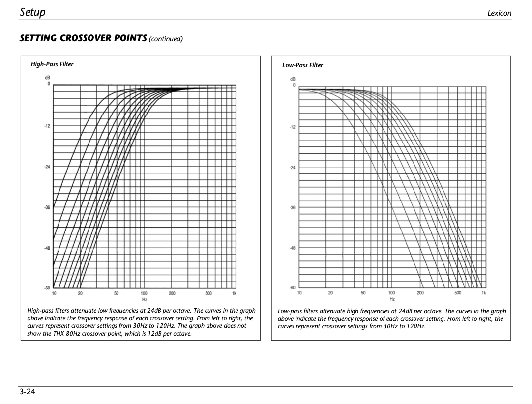

That’s the bulk of your problem right there. LaScala high pass filter set too low….and THT low pass set too high. The mains and subs are walking all over one another in your space.
According to the manual, the MC8 filters are 24 dB/oct…although analysis of their charts indicates more like 12-18 dB/oct in application….which would be inline with THX standards.

From the MC-8 manual...
"When a THX speaker setup is selected, the MC-8 applies a THX 80Hz crossover point with a 12dB-per-octave filter to the Front L/R, Center, Side L/R and Rear L/R output connectors. The MC-8 applies a THX 80Hz crossover point with a 24dB-per-octave filter to the Subwoofer output connector."
