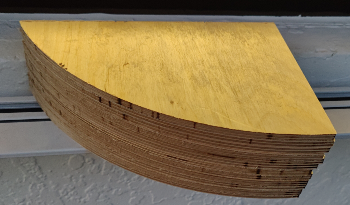

It's hard to get BB plywood here, but a few years ago I was able to get some, which I received in roughly 2'x4' panels. Since then my one-and-only source has dried up, so I am trying to be careful with my cuts to make what I have go as far as possible. I have the pieces mapped out more or less on my panels. Accordingly, I got both baffles and one of the backs out of one 2x4 panel. Since I had one back, I decided to cut the 2nd one as well. The rest of that 2nd panel, a piece about 23" x 30", got used to make horn braces. To waste as little material as possible, I decided to make them with a router. I was able to use the template to trace 12 braces. I cut these out, very roughly, with a jigsaw. Stuck the template on the cut out pieces and cut them out with a small table router.
Here's the stack of braces so far ;-)
Getting as much as possible cut out before opening the PL... Not sure if the next thing will be cutting out more panels or cutting out the horn duct top/bottom. I have a piece of 1/4" BB that is about the right dimensions to get two out. Curious how others have cut the curves on these pieces?
