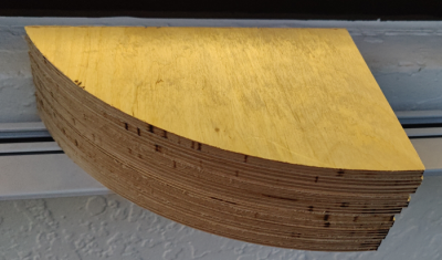

It's hard to get BB plywood here, but a few years ago I was able to get some, which I received in roughly 2'x4' panels. Since then my one-and-only source has dried up, so I am trying to be careful with my cuts to make what I have go as far as possible. I have the pieces mapped out more or less on my panels. Accordingly, I got both baffles and one of the backs out of one 2x4 panel. Since I had one back, I decided to cut the 2nd one as well. The rest of that 2nd panel, a piece about 23" x 30", got used to make horn braces. To waste as little material as possible, I decided to make them with a router. I was able to use the template to trace 12 braces. I cut these out, very roughly, with a jigsaw. Stuck the template on the cut out pieces and cut them out with a small table router.
Here's the stack of braces so far
Getting as much as possible cut out before opening the PL... Not sure if the next thing will be cutting out more panels or cutting out the horn duct top/bottom. I have a piece of 1/4" BB that is about the right dimensions to get two out. Curious how others have cut the curves on these pieces?

I used the method shown in the plans.
Re: 2x Jack 12 Lite build
Ha! That makes sense. I did read the plans. I have a pretty good circle cutting jig on the router, so I thought I might give that a try. If it turns out to be more trouble than it's worth, I'll probably jerry-rig a rotary tool to work as makeshift drum sander, since I don't have a real one

Bill was implying that it is best to build as you go, cutting each panel to final size to fit the current position. Cutting all panels ahead may cause problems because of the possibility that something may be "off" in the build.

I was stating that there are proven methods in the plans for cutting the various parts, proven because I used these methods myself to construct the prototypes. They're not the only possible methods, but I can testify that they work.
Both points are well taken. The risk is on me. Case in point, I tried *my* approach to making the duct top/bottom last night with a router and a circle cutting jig. It worked, but was probably more trouble than it was worth, and not clearly better than the proven method. ...But now that I have the piece, it occurs to me that it might not be difficult to replicate it on the router table, which worked pretty well with the horn braces. Then again, as Tom suggests, maybe it won't fit that well. I won't know until I get to that point in the build, so I probably won't try to cut any more until I get to that point.
BTW, with the large panels, the only ones I have cut so far are the backs. I cut them a little bigger than I expect them to be in the end. My precision is such that I have had exactly the problem that Tom mentions. So the panels I cut before I need them are a 1/2" bigger or so than I need them.
I try to follow the plans religiously with regard to materials and dimensions. I also try not to deviate from proven methods too mucy, since they are, as Bill notes, proven. If i do try a different approach, I treat it as an experiment. This was a rather low risk experiment since I had the tools out already and it didn't require much material. I'll try to report as faithfully when the experiment is a bust as when it works

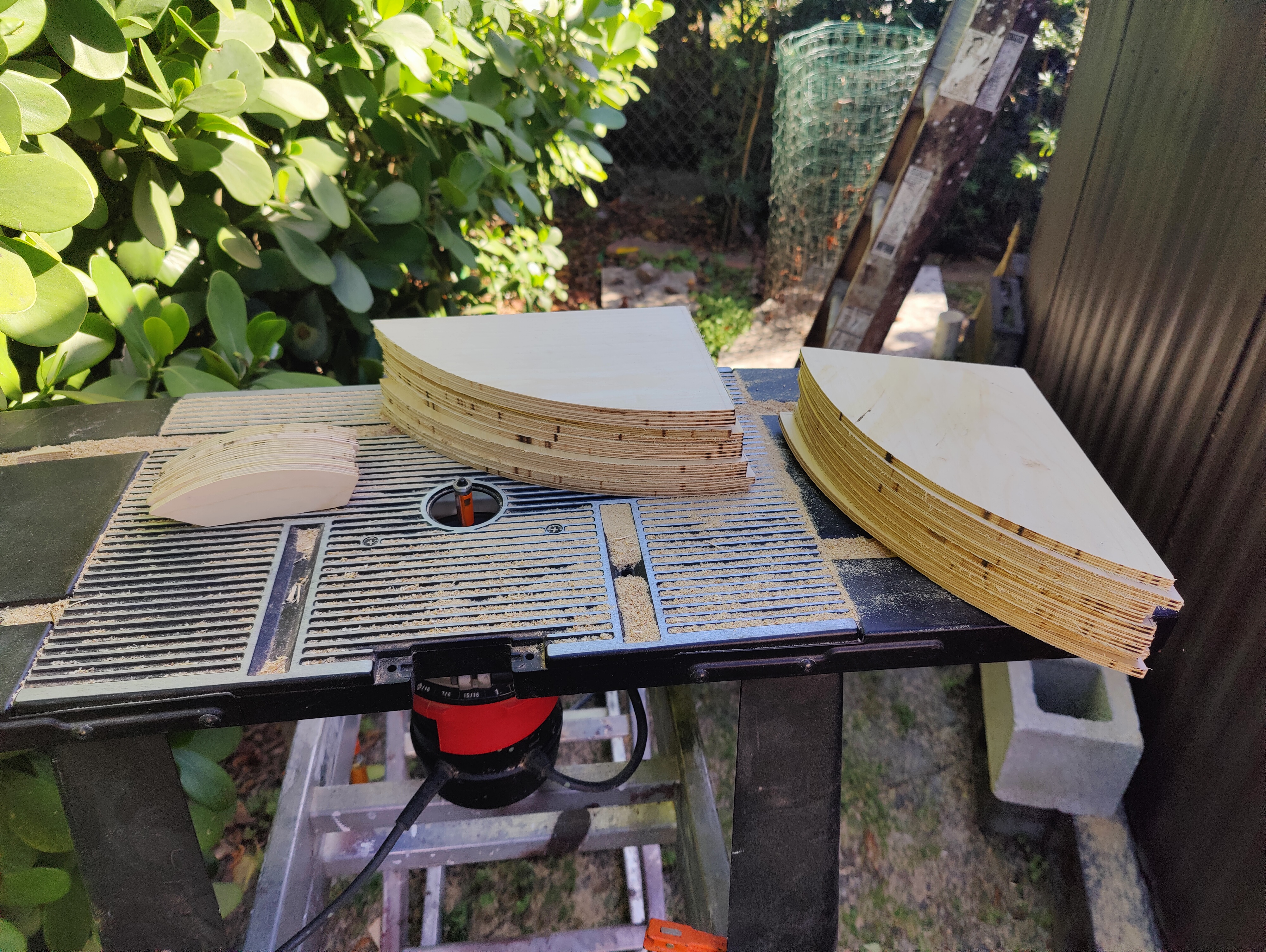

Very slow progress. I work outside, and only when I get a chance so I try to use as few tools as possible. Today was primarily the table router. I had previously cut 12 horn braces. Cut the remaining 8 today. Used the method in the plans to cut one throat sheath brace from a circle made of 1/2" radiata pine plywood that was left over from making the woofer spacers. I used it as a template to make 9 throat sheath braces from 1/4" BB. Partly this was to use less BB, and partly it's because I found cutting the horn braces pretty easy with 1/4" it wasn't necessary to rough cut the pieces with a jig saw as I would have done with 1/2" or thicker plywood. However, with the very small throat sheath braces I found the router a bit more difficult. I think this is mostly because tape I used to attach the BB to the template works better on a big piece. With the big pieces I could re-use the tape for three or four braces before replacing it. With the small pieces I found out the hard way that I could only get one or two uses from the tape. After that it did not hold firmly enough. So... to get 9 good ones (8 plus a spare) I made 12 attempts. It saved a bit of wood, and was still pretty easy.
