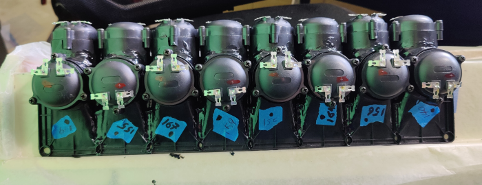

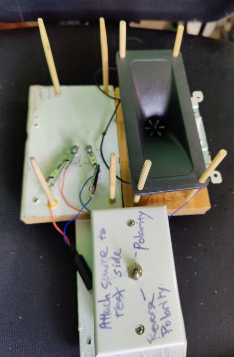

I have officially glued up my first melded array!
Tested all the elements with an LCR meter, and for sound and polarity with a found-object test jig. The only innovation in the jig are the chopsticks to hold the test tweeter in place on the screw-contacts. It was quick to build, quick to use, but low on visual appeal.
The # on the blue tape is the capacitance, and the "dot" means it passed sound and polarity tests. In the Dyslexia land everything must be labeled.
Interestingly, I only had one tweeter failure. It was fine for polarity and capacitance, but had a weak sound. Turned out to be a messed up paper cone.
I used acetone with some cutoff tweeter bits mixed in. About 50 ml of Acetone and 10g of ABS. That amount was about exactly right for one 16 element array. I experimented with it a bit before starting because I was not sure it would have enough setup time, but it turned out to be about optimal. There is enough time to paint the sides and then it sets very quickly. there is enough viscosity to fill small gaps. One interesting thing is that it started thinner than it finished. The glue was considerably thicker on tweeter-pair 8 than an tweeter-pair 1. The good part about this is that I could go back and fill gaps with glue that had become more slurry-like.
Will go back and give a coat of thicker slurry to the back when I finish the 2nd array. I am considering reinforcing with the "strips of abs that I cut off the sides of the tweeters...but maybe that's overkill? It seems like a simple enough thing to do, but I haven't seen others doing it.

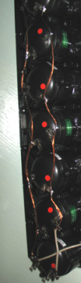

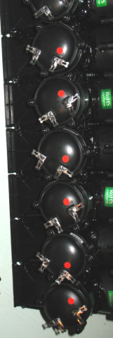

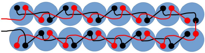

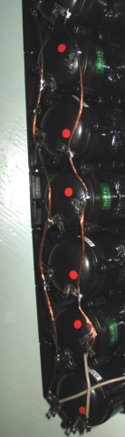

Grant pointed this option out to me once and I really like it. I don't recall if these are pics of his or someone else's. The array is assembled the way you did it, alternating housing direction, but each module is rotated in it's housing so that the lugs align better for a more direct wiring scheme.
In any case, looking good :thumbsup:

Grant seems to also mark the positive terminal with a red dot. If you look close at the pic there's a some red nail polish to mark the positive side of mine as well.
I like the idea of turning the elements, but I probably won't do it on mine. I opened two tweeters and three of the six screws stripped. Most of the rest are tight, and I have filled a few that were not with a bit of toothpick and acetone slurry. I don't really want to open them if I don't have to on the "ain't broke" theory. That said, I really like the way that patter straightens out the wiring course.
I am hoping that my wiring chart will keep me on course if dyslexia rears it's ugly head ;-)

fender3x wrote: Tue Aug 30, 2022 8:39 pm I appreciate being in the company of other geniuses! Ha!
:loler: I'm quite literally chuckling out loud. Hahaha. Completely enjoying the exchange of (dim)wits. :thumbsup:
The wiring scheme looks solid.

fender3x wrote: Tue Aug 30, 2022 8:39 pm Grant seems to also mark the positive terminal with a red dot.
In my DR250 thread? No, I think that was Anton posting up a picture of what he does, talking about reversing every other piezo, and adding dots.
I just went standard myself.
I didn't bother marking the positive. It already has a + on it.
If, on testing, I was to find a piezo with reverse polarity, I would put it aside.
Another reason to buy more than you need...
Edit: I wire mine differently.
positive and negative to appropriate terminal on piezo 1 bank one, wire through to last piezo in that bank then cross pos and neg (think a large X, to bank 2 and continue on. Why? So you can run the wire back to the filter down 1 leg only. Not have to split it and run it up 2 legs...

Grant Bunter wrote: Wed Aug 31, 2022 12:37 amI think that was Anton posting up a picture of what he does, talking about reversing every other piezo, and adding dots.
The pictures posted by Seth look suspiciously familiar so: yep, that could have been me :cowboy:
The colored dots were already on my piezo's if I recall correctly. I found them helpful when soldering. Big red dots are harder to miss than a plus sign that requires my constant attention. I did check all piezo's for polarity. In fact I added a phase reverse switch in my pizzer test jig specifically for this purpose. Don't recall if I found any out of phase, it has been a long while. It was reassuring anyway to know for sure that not only all sounded similar, but also none were off in polarity.

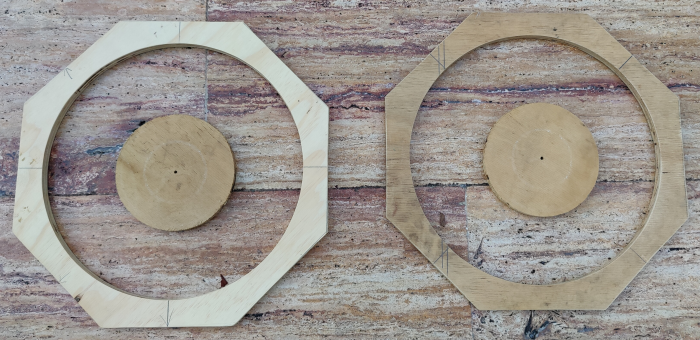

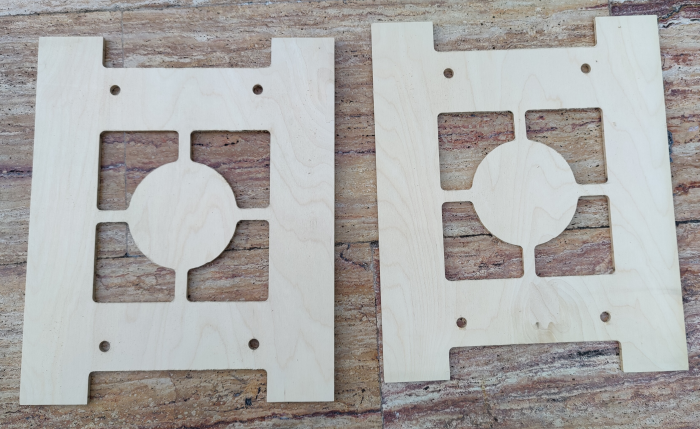

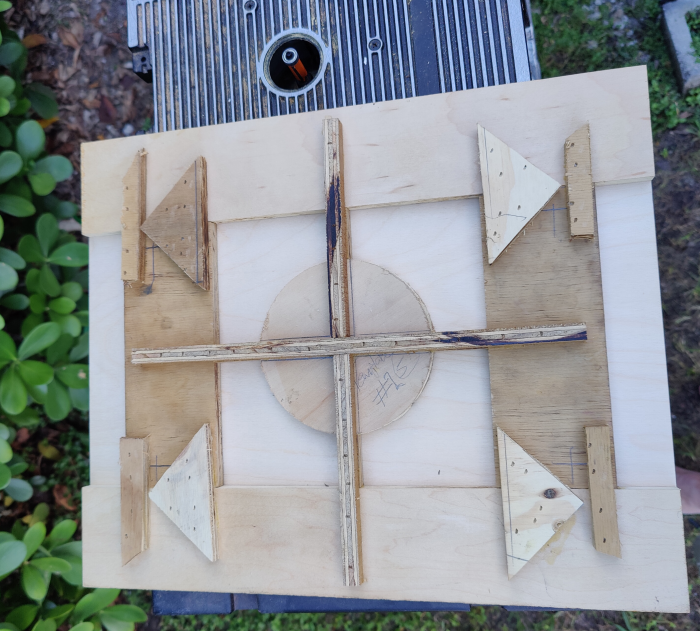

Not doing this build in exact order. I decided to pieces that required a router and that used half inch plywood. Did the rings and circles first.
My 1/2" ply varies in age, which is the reason for the color difference in this pic. Using up the old stock. The big circle was easy using a milescraft circle jig and a full-sized router. Unfortunately I don't have the Milescraft small circle jig, so I improvised using something cobbled together with a $20 Harbor Freight trim router. It worked, but took a few tries to get it right. Don't think I would recommend this tool to anyone.
I used some scrap 1/2" ply...stuff not suitable for a build...to make a template to route the baffles. My inspiration for this was Rickyvt's template:
viewtopic.php?f=30&t=25734
Mine is not as elegant...
That's not really burn on the cut marks. It's residual ABS from cutting tweeters. This was the last use of that saw blade ;-) I glued the pieces together. Since I am using it with a small router table, I also secured the pieces with some scraps of 1/2" plywood that were glued and fastened with brads.
I am pretty happy with the result:

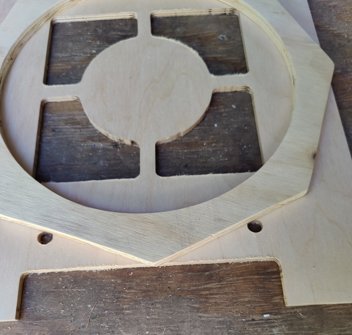

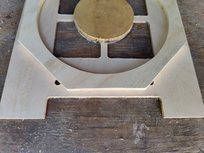

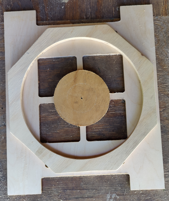

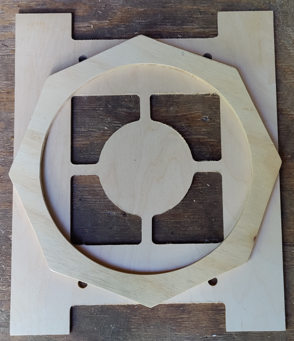

...and already a small (I hope) issue...
When I put the rings on the baffle I noticed that the ring covered part of the 1/2" holes.
Going back to the plans, the holes are in the right place. So I am guessing the ring is the culprit. In the plans, 4 of the straight edges are 5" long, making the other 4 about 5.66" long. Mine are symetric, so they are all about 5.33 in length. I am guessing this is what made the difference?
I cut mine on a chop saw with the blade at 45 degrees. I measured to get the cut line to be 1" from the hole in the narrowest spot on all 8 sides. This produced a symmetrical octagon with the narrow points all exactly the same distance from the circle. I thought I was very clever for doing this...until the holes did not line up.
I can think of three simple ways of fixing this problem. Option #1 is to plug the holes, and re-drill slightly off where they are now. The trick would be to make sure that the new hold does not interfere with the top of the duct sheath braces or the horn sides.
Option #2 is to remove a little material from the ring so that hole in obstructed. This would be pretty easy to do with the table router, and there should still be 1" or more of ring at every point of the circle, so plenty of ring to mount the speaker on.
Option #3 is the simplest, but more radical. I could plug the holes in the baffle and drill a 1/2" hole in the lateral horn sheaths. In other words, to vent the sheath cavity from the side rather than from the baffle.
I am leaning to option #2, but suggestions are, of course, most welcome!

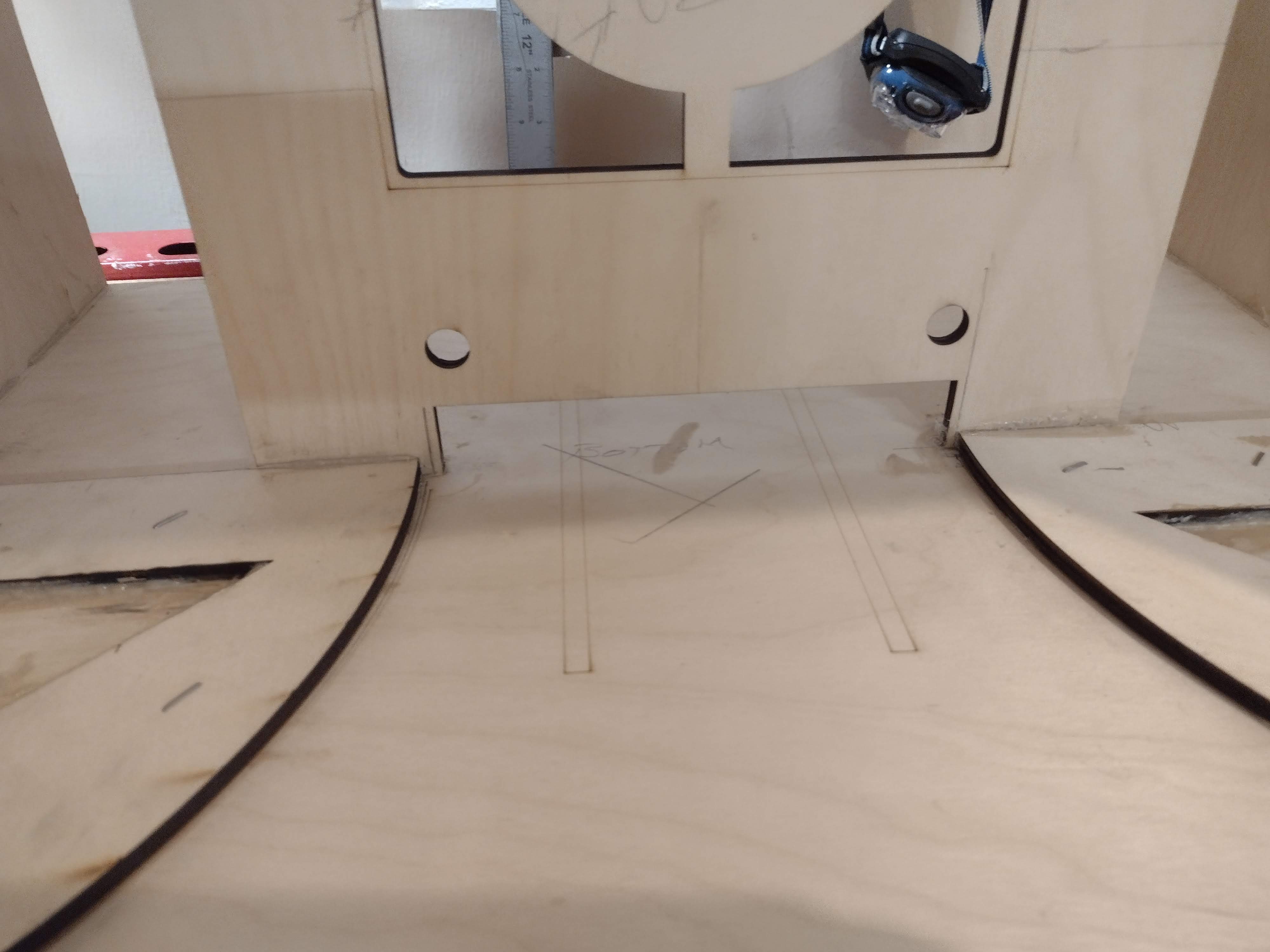

... I am not sure if this would cause any problems, but this would also solve the problem, since it pretty much completely frees up the holes without doing much other than turning the ring.
You can see the clearance a bit better looking at an angle.
Does the orientation of the points make any difference? Or the fact that I'd need to trim 1/4" from the top and bottom points for the duct extensions since I am using a 2012 driver?

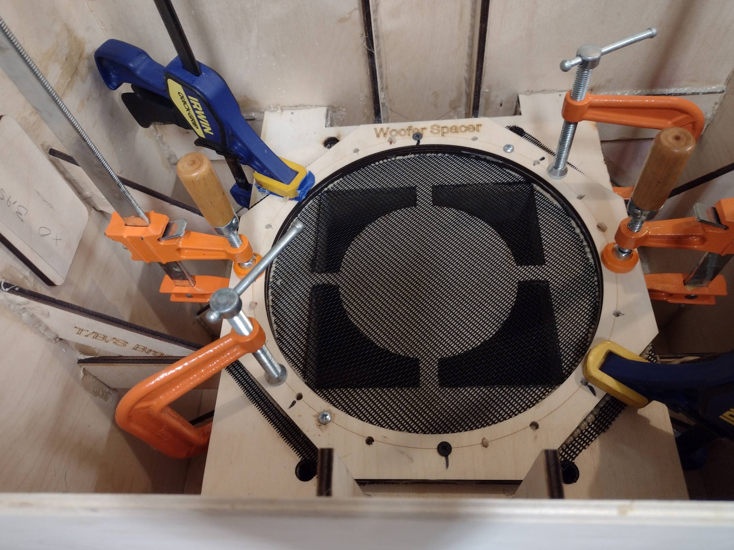

This is the only picture I have of my J10 Lite spacer. I followed the plans exactly (to the best of my ability) and I didn't have the problem that you're seeing.
I looked in Lightburn (I laser cut most of the parts). The spacer is 11" across, the baffle is 11" across, and the vertical spacing from inside-edge-to-inside-edge of the circles is 10 inches. Now this is a 10" Jack, not the 12".
I could be wrong, but are your holes closer toward the center?
fender3x

9830Lark wrote: Sun Oct 30, 2022 4:13 pm I could be wrong, but are your holes closer toward the center?
You may be right but the dimensions are a little different for the Jack 12L. The plans put the holes 3 5/8" from the lateral edge and 2.5" from the top/bottom. The holes are pretty darn close to that. The spacer ring is 13" across and the baffle is 14" across.
The holes could certainly go a little closer to the edges or a little up/down for that matter. As far as I know the reason for the holes is to allow air to move in and out of the chamber between the upper/lower horn sheaths and the ducts. If that's right moving the holes a little should not be a problem as long as the chamber stays otherwise airtight. But I am no engineer, so I wanted to at least pose the question ;-)
If I have learned anything here it's that what seem intuitively right to me is often wrong.
