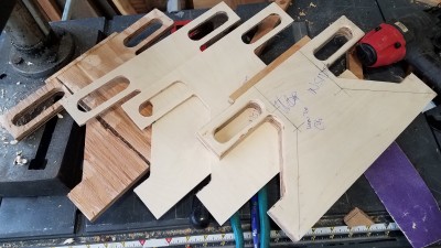

Re: Pair of WH6 Lites build
Alright you turkeys...
I put a little time in today. Made templates for the upper and lower horn pieces. Dimensions are modified from those stated in the plans to trim a little extra weight off. Ultimately, it's probably not worth the extra effort, but it's what I did. Was having a hard time staying focused and motivated today. Just pushed my way through it and decided to call it before finishing the parts off with a light detailing.
Anyway, Horn tops and horn bottoms are cut out. After they're sanded smooth I just have 4 Mouth panels and 4 throat panels to cut out... then on to assembly.
Evidence of todays doings...
Honestly, I don't feel like these templates were as slick and helpful as the one I did the other day for the baffles. Took a lot of time to make them. Perhaps I'll appreciate them more when I build another pair.

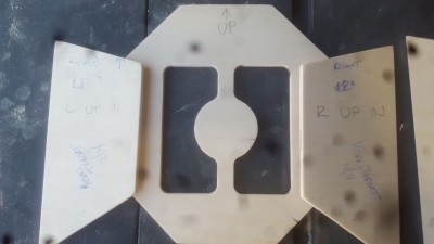

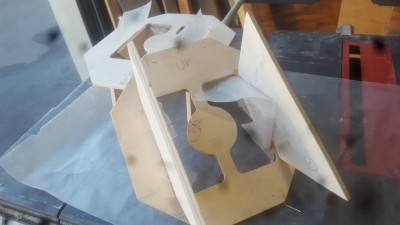

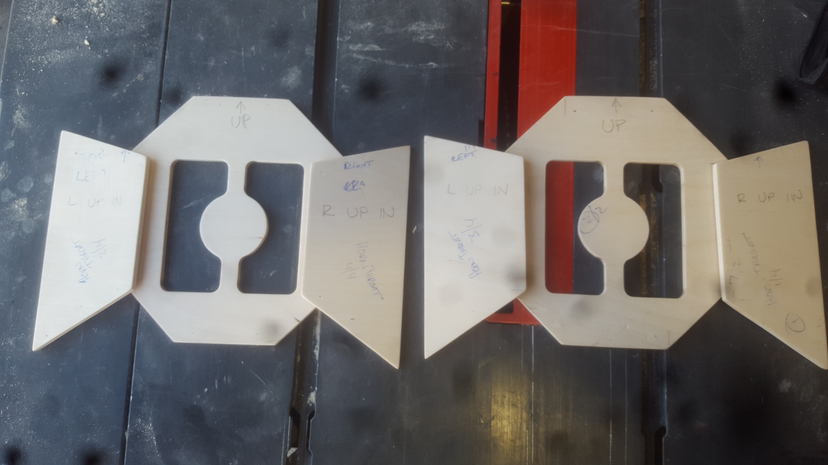

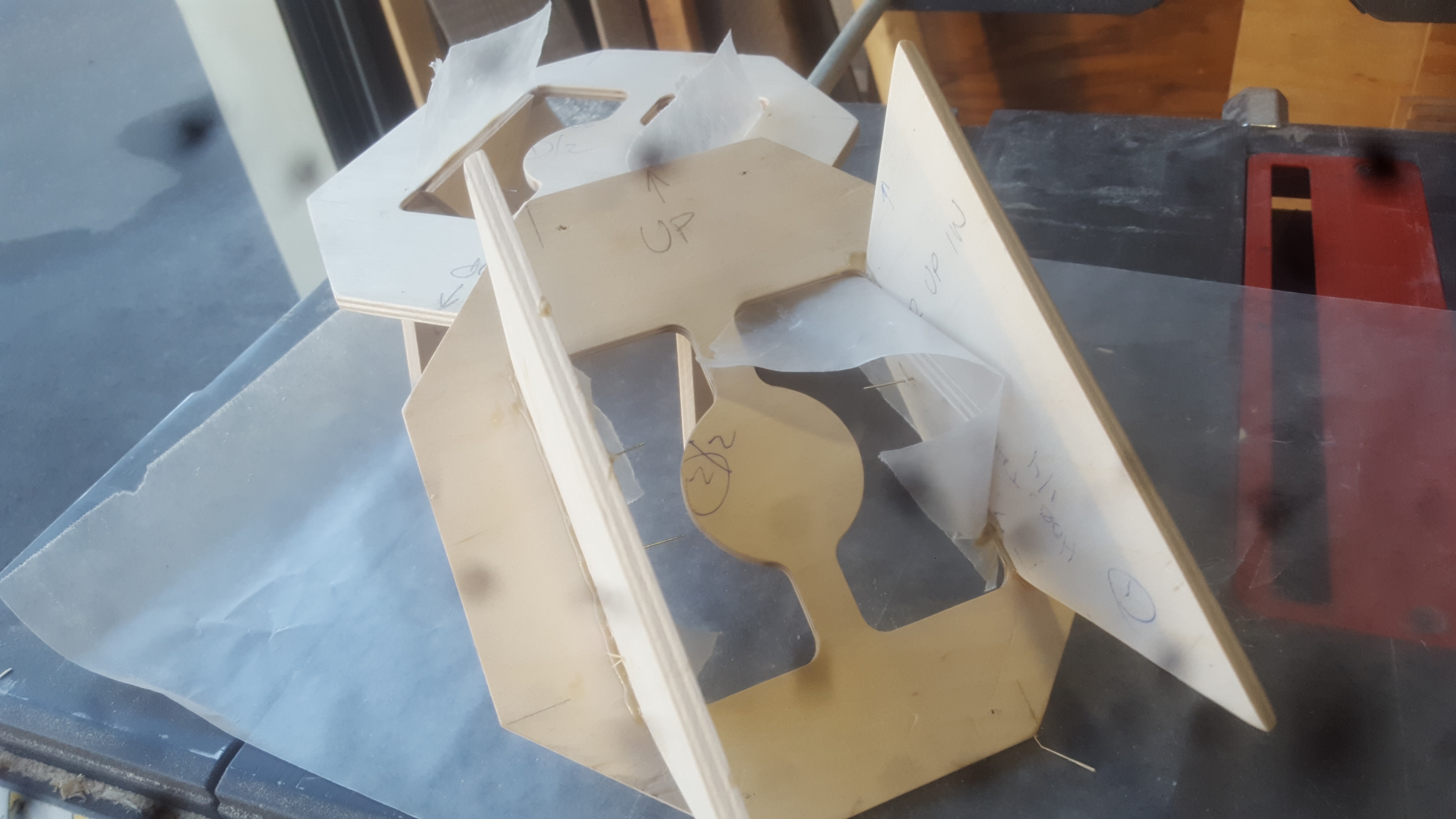

I finished up sanding and smoothing the top and bottom horn panels today. They came out real nice.
Also cut out the mirror image throat and horn sides. I forgot to put the bevel on the one side of the throat sides. But, was able to run them through and trim the bevel angle into them without effecting the finished width. No harm, no foul (not the turkey kind).
Before actually doing it, I was a little intimidated by all the compound angles of the horn sides, but they were actually pretty easy. First, I cut the panels to their finished height, then cut the two parallel sides with their angles to the finished width, then sketched out the rest and pushed them through the table saw with the miter gauge, achieving impressively accurate results.
Ultimately, no big deal.
I wanted to at least get something glued together today, so I went ahead and got started by gluing and tacking the throat sides in place. So far, I've been using a 23g pin nailer and it seems to be holding okay. But I dropped it and it's now jammed. Magazine isn't aligned with the head anymore, so that put an end to the day. I'll have to look at it a little closer tomorrow. I'm sure I can realign it and get it going again.
Sorry, forgot the better camera today.
Baffles and throat sides laid out for assembly
All the notes... It's in the plans. They came in handy. Sometimes all the angles and pieces and left's/right's and up's/down's and in's/out's can get a little confusing. I read another Wedgehorn build and some parts got made without the mirror image dimensions. Whoever that was probably saved my butt from doing the same thing. I made real sure to lay everything out and make separate parts. It would be visually helpful if the plans had pics with dimensions and angles of both orientations. If nothing more than as a reminder not to make two of the same, but one of each. In any case, I managed to avoid that pitfall.
Here's where I left off for the day. It's starting to take some shape!
