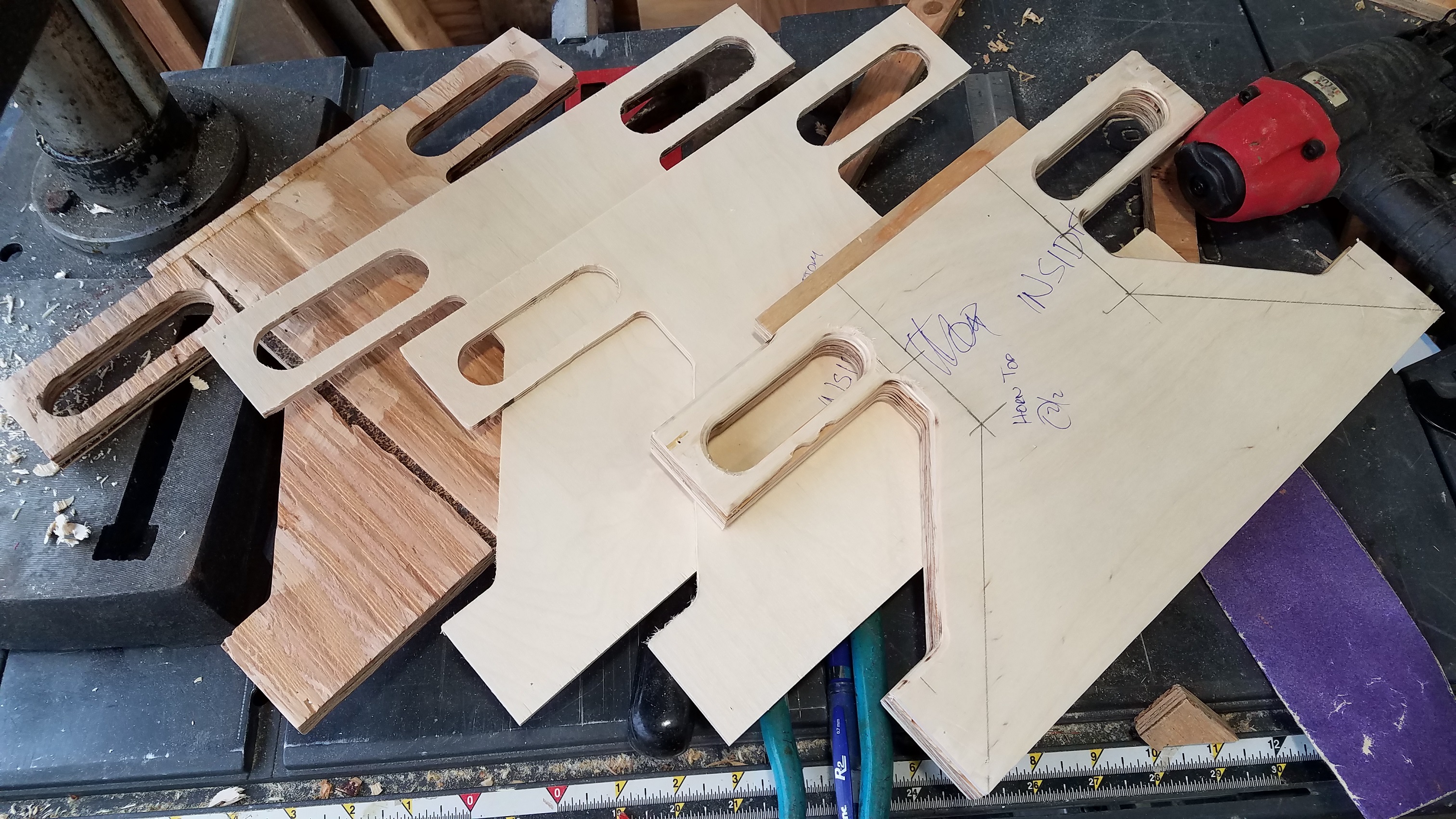

Baffles and throat sides laid out for assembly
All the notes... It's in the plans. They came in handy. Sometimes all the angles and pieces and left's/right's and up's/down's and in's/out's can get a little confusing. I read another Wedgehorn build and some parts got made without the mirror image dimensions. Whoever that was probably saved my butt from doing the same thing. I made real sure to lay everything out and make separate parts. It would be visually helpful if the plans had pics with dimensions and angles of both orientations. If nothing more than as a reminder not to make two of the same, but one of each. In any case, I managed to avoid that pitfall.
Here's where I left off for the day. It's starting to take some shape!
