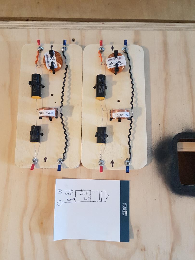

In the bottom pic (for APT80), I recommend undoing one of the inductors (pick one, do the same on both boards) off the board, and standing it upright, as well as rotating it 90 degrees.
You had it that way in your first pic, so use that as a reference.
The other 2 are fine, solder away...

Ok Grant will do thanks for looking, I will solder away and use the first pic for the Apt 80 as reference standing the inductors up 90 degrees. I just want to let you know if the direction is right, the bottom Red/Blue lugs are from amp up arrow to drivers, correct?

Only one inductor on each board.
Otherwise ,direction, arrows ,all good...

Ok great I just redid it this morning hopefully I can solder now, thanks. Took me 20 hours but enjoyed for a first time doing crossovers. :wink:

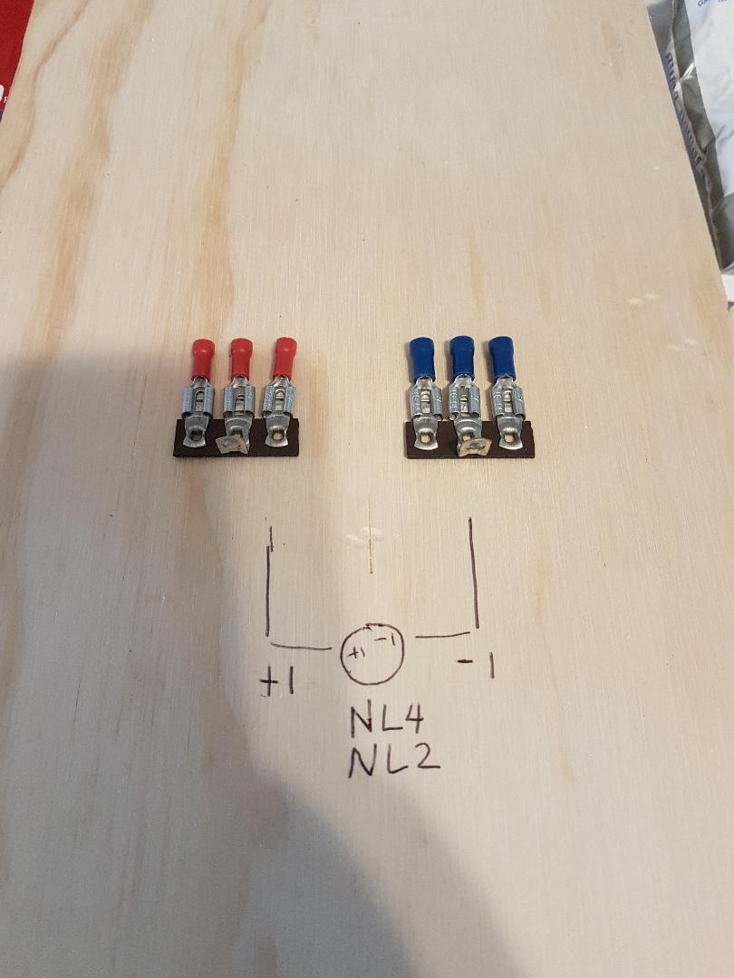

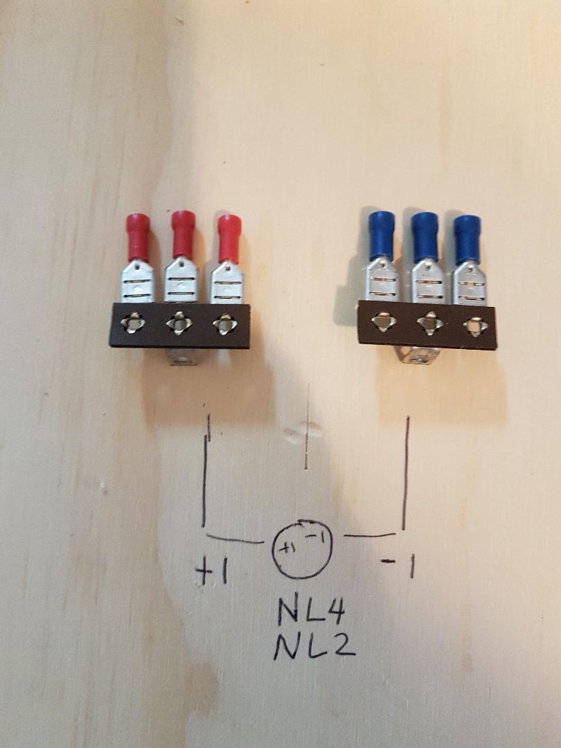

Also Grant is it possible to do this cheap terminal 3 way lugs for the +1/-1 for NL 4 NL2 connector. All 3 positive attached in +1 and all 3 negative attached in -1.
Thank you for the help. :idea:

djlivex wrote: Thu May 14, 2020 12:29 pm Ok great I just redid it this morning hopefully I can solder now, thanks. Took me 20 hours but enjoyed for a first time doing crossovers. :wink:
Go with that

djlivex wrote: Thu May 14, 2020 2:09 pm Also Grant is it possible to do this cheap terminal 3 way lugs for the +1/-1 for NL 4 NL2 connector. All 3 positive attached in +1 and all 3 negative attached in -1.
Can you turn one of those over and take a pic for me please?

Its not connected if that is what you would like to know, I would have to solder a 16 awg wire across all three holes. If you can see what I am trying to get at? Thank you

djlivex wrote: Thu May 14, 2020 4:15 pm Its not connected if that is what you would like to know, I would have to solder a 16 awg wire across all three holes.
Yep, do that then!
Use NL4, +1 to the red connectors, -1 to the blue...
