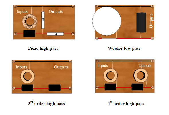

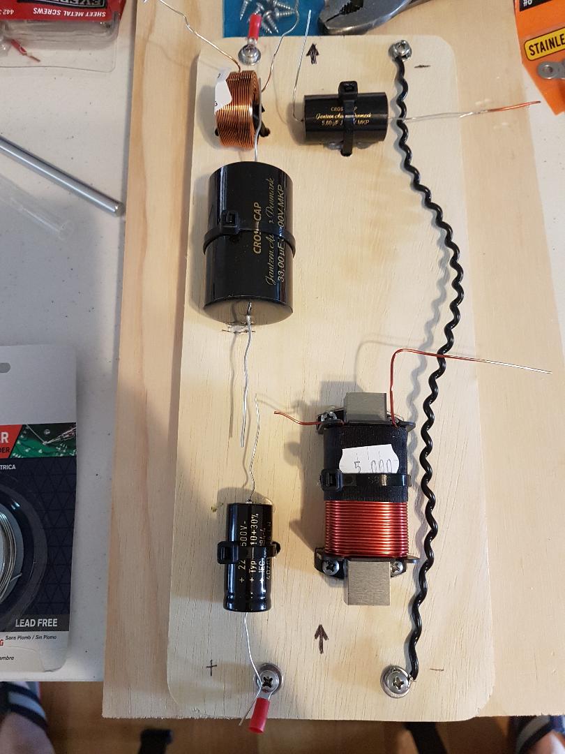

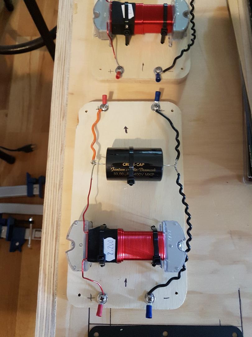

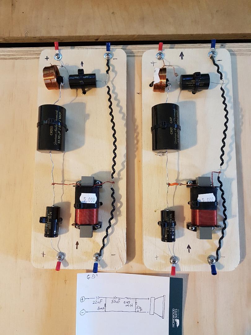

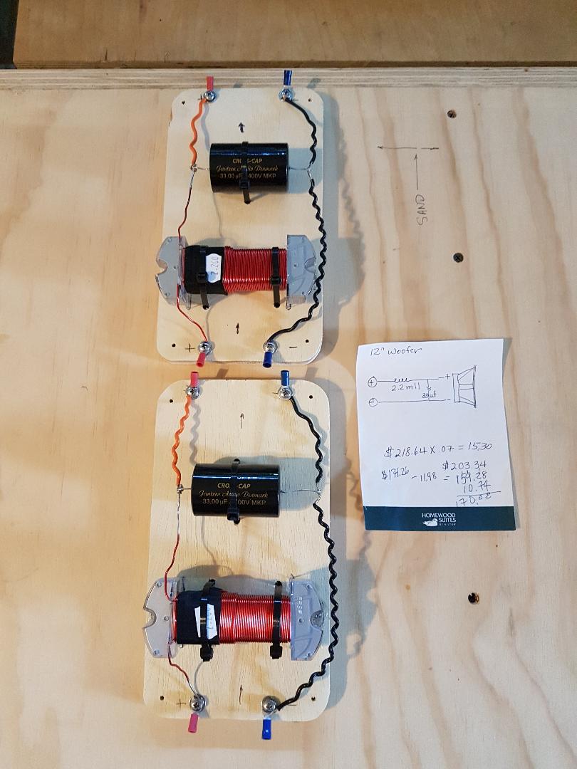

Can someone check my work on my crossover boards I mounted them caps and coils on ply piece if they are correct bottom is from amp arrow components the out to driver. Before I solder these together, I seem to be confused on pics from schematics which I followed compared to the pics on the plans of 3 completed boards.
Doing the Tweeter ply x-over board as we speak but not soldered yet. Thanks :roll:

The woofer low-pass is fine, but after the 33uf cap on the high I'm lost on what you're trying to do.

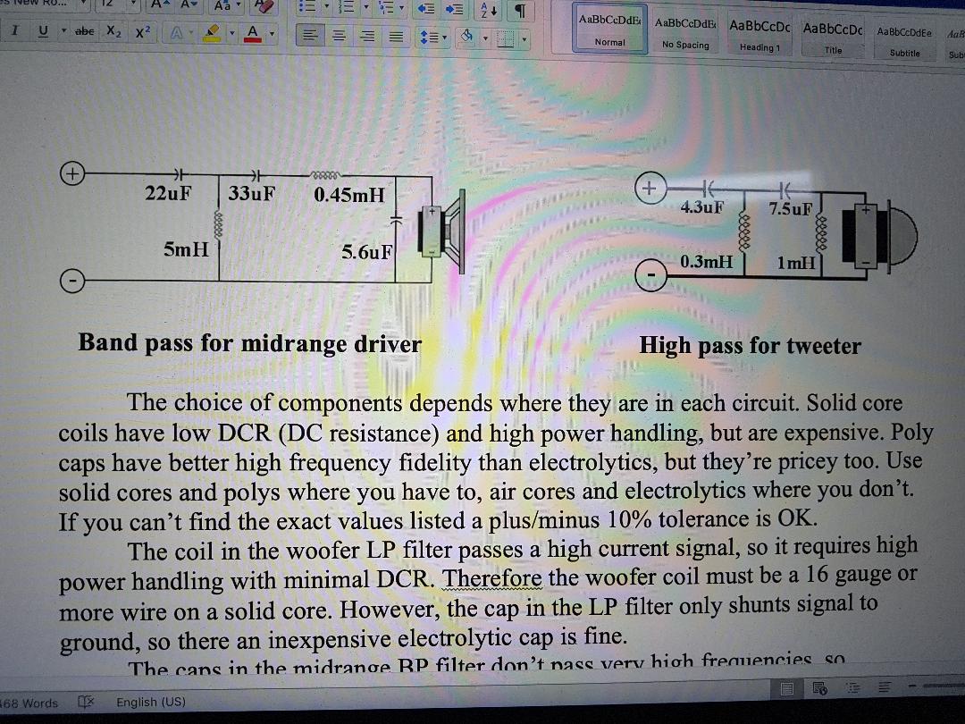

Jimbo7 the mid 6.5" on the schematics show + left side - on the right side, now on positive lug from amp it shows 22uF in line with 33uF cap as shown on page 17 and 18 of the original Omni 12TB plans. Then look at the bottom page 18 positive now is on the right its confusing but I followed the way it shows on the schematics above where the 22uF and 33uF caps are in line then a .45mH coil then 5.6uF cap shunts +/- then goes to lug positive to + of the mid woofer. Obviously the - lug is for the - 6.5" mid woofer after the 5.60uF. Please look at the arrows from bottom of my ply board the direction of amp > crossover components > mid woofer. Did I do all these in reverse as you see the positive red is now on the other side of the mid crossover panel? Thanks guys!

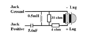

Here's what my plans show

Ok thanks jimbo7, that's not in my original Omni 12 TB these are in the plans:
Yours have a totally different 1" which is Apt 80 on the original plans, unless Bill revised these plans recently?
Thanks now Im really confused! :confused:

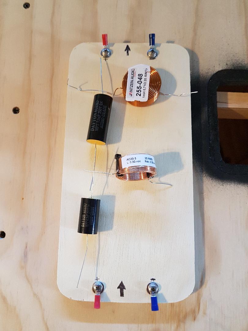

This is the Tweeter Apt 80 crossover panel, I just position the caps and coil as per schematics drawing on the Omni 12TB plans. Thanks

djlivex wrote: Sun May 10, 2020 6:03 pm This is the Tweeter Apt 80 crossover panel, I just position the caps and coil as per schematics drawing on the Omni 12TB plans. Thanksthumbnail-11.jpeg
As long as you add a wire from minus to minus, and solder the two loose ends of the inductors on the right, to that piece of wire, this one is good

djlivex wrote: Sun May 10, 2020 1:38 pm Can someone check my work on my crossover boards I mounted them caps and coils on ply piece if they are correct bottom is from amp arrow components the out to driver. Before I solder these together, I seem to be confused on pics from schematics which I followed compared to the pics on the plans of 3 completed boards.
The bottom one is good
Look at the schematics again for the band pass filter, sort out the leads properly for the inductor up in the top left hand corner as per your pic, and post a new pic up once done...

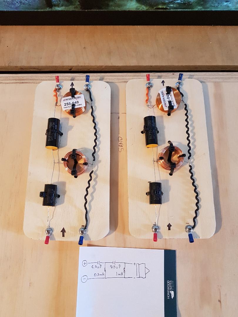

Yes Grant I will be connecting a wire on that right side of the Tweeter board from bottom to up lugs. I am also waiting on 3 lug terminal so I can connect 3 positives and 3 negatives wire to Neutrik panel.Will post pics once soldered. Thank you again.

Ok Grant I just finished the crossovers before I solder here are the pics:
Thank you Grant!
